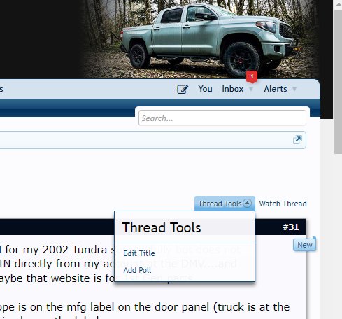

    Go to the top of your thread, look for the Thread Tools button. Click it. Edit Title. Not saying you gotta, just saying "that's how you do it"
