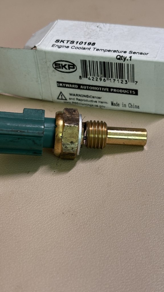

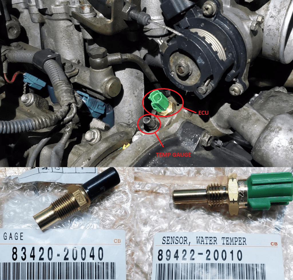

    I think I found the coolant temp sensor, passenger side up front? I see two clips kinda hidden, right after where the upper rad hose connects to the block. They were green and white. I'm thinking white one goes to my instrument panel, dunno why it's white and not black though.
    That's about it. I think the thermostat is good, I felt the radiator get uncomfortably hot after it idled for a few mins testing the PS air valve.

    Two ECT / coolant temp sensors, one for ECU to monitor engine and one for gauge cluster. One is white either because someone replaced it (and it's already failed, a testament to how shitty aftermarket parts are), or in your year, the black sensor pictured is grey. See here for location and part numbers, this is a part you'll want to buy Toyota, not generic parts store or generic online. I don't have a pre-2005 to test on, but hear if the ECU can't get a signal from the green sensor, the truck won't start. Given if your engine overheats, it can be catastrophic, seems like this is one of those parts you really don't want to skimp on.

    So I already bought this part cus it said OEM and also it was $2 instead of $60 :)
    I'll throw it in and see if it works, then order OEM to help me sleep at night later on.

    Turns out Engine Coolant Sensor needs an EXTRA deep 19mm socket, not just a deep one, to get past that green plastic housing.
    I didn't have a 19mm wrench either, so I went with an adjustable one I use for plumbing.
    It was way too big and while I thought I was crushing the crush washer, I was actually doing this
    I'm VERY GRATEFUL I didn't snap it all the way off. I was able to remove it with my fingers, and put the old one back in.
    I think it's a combo of being a cheap part, and me using such a big wrench I couldn't properly feel the crush washer.

    O2 sensor Bank 2, Sensor 1 - Passenger side upstream right? It looks brand spanking new is why I ask. Maybe PS fluid being burnt up makes it fail?

    Hey I had to move my truck around the driveway today and it ran REAL rough, likely barely could move it. Is that expected from a missing temp sender? I broke off the green plastic, so used the brass pieces as a plug. The cord is just dangling there until new one arrives.
    Only other thing I've done to the truck (besides remove/replace airbox) is potentially swap those two PS hoses going to the valve

    Heyyy turns out it was the missing engine temperature sensor. Came back roaring once I plugged the new one in.
