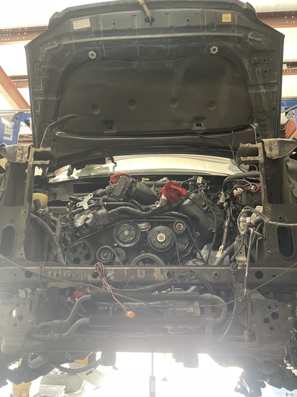

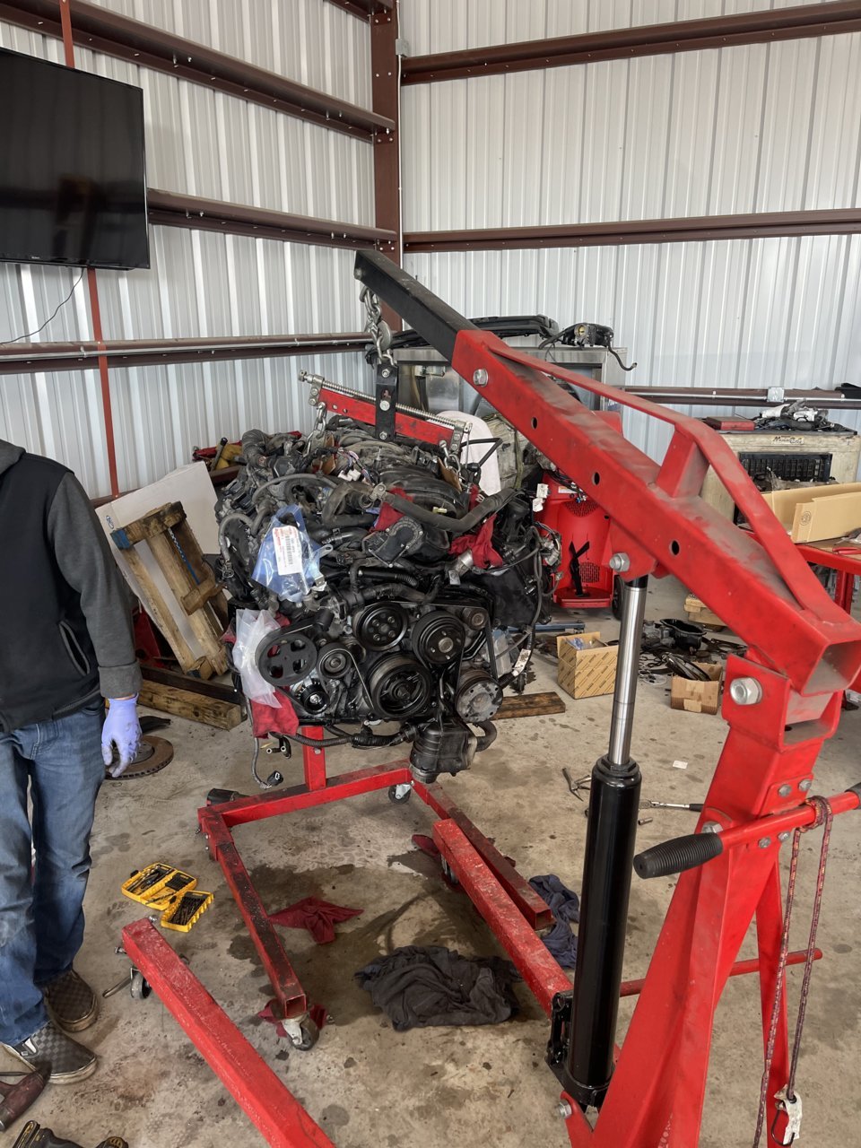

    Update. Engine finally back in truck yesterday. Imagine one more day to get everything buttoned up. Besides all of the obvious seals and gaskets that were replaced, the mechanic replaced cam tensioners, chains, chain guides, looked like the 2nd gen air pump(think he called it fuel injection valves), alternator, water pump, air conditioning condenser, starter, (4) valves, and oil pan Because of a stripped drain plug . (I knew it was weeping. I had a fumoto valve. Don’t know if I messed it up, or the few times I went to oil change place. Not doing fumoto valve anymore) I am paying the labor regardless, so it’s basically just cost of parts, and I do not want to deal with any issues for a long time. A mechanic I know tried to persuade me to sell the truck and not put a bunch of money into it, but I like it. Also the rediculous replacement prices are making it easier to justify. Haven’t got a grand total yet, but I am think we are definitely north of $10k. The mechanic sends update pics constantly, and I have accepted all of his suggested replacement recommendations. Looking forward to getting this wrapped up and getting on with my life.

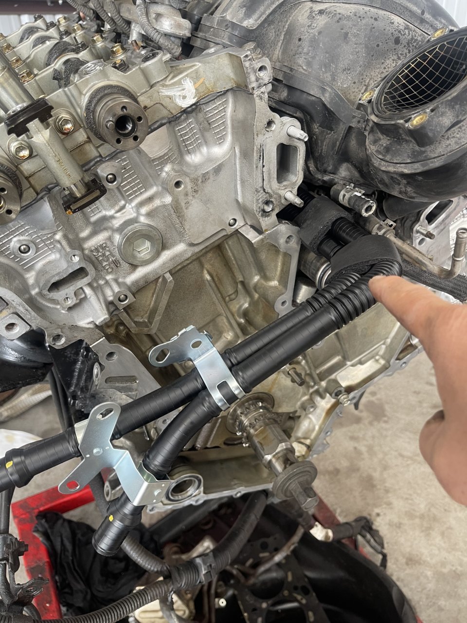

    Would that be part of condenser? Can you see those hoses in pic? There is some new hoses but I don’t know what they are for. This whole experience has been great to really familiarize me with the engine components. I have crawled under and inspected truck a ton of times, and I never realized that the starter was buried under that heat shield.

    Sounds like you have dealt with those. Haha. Thank you, I will ask the mechanic. This whole thing snowballed fast. I have to remind myself that this better than dealing with a collision, and hopefully an opportunity to get many more years of use.
