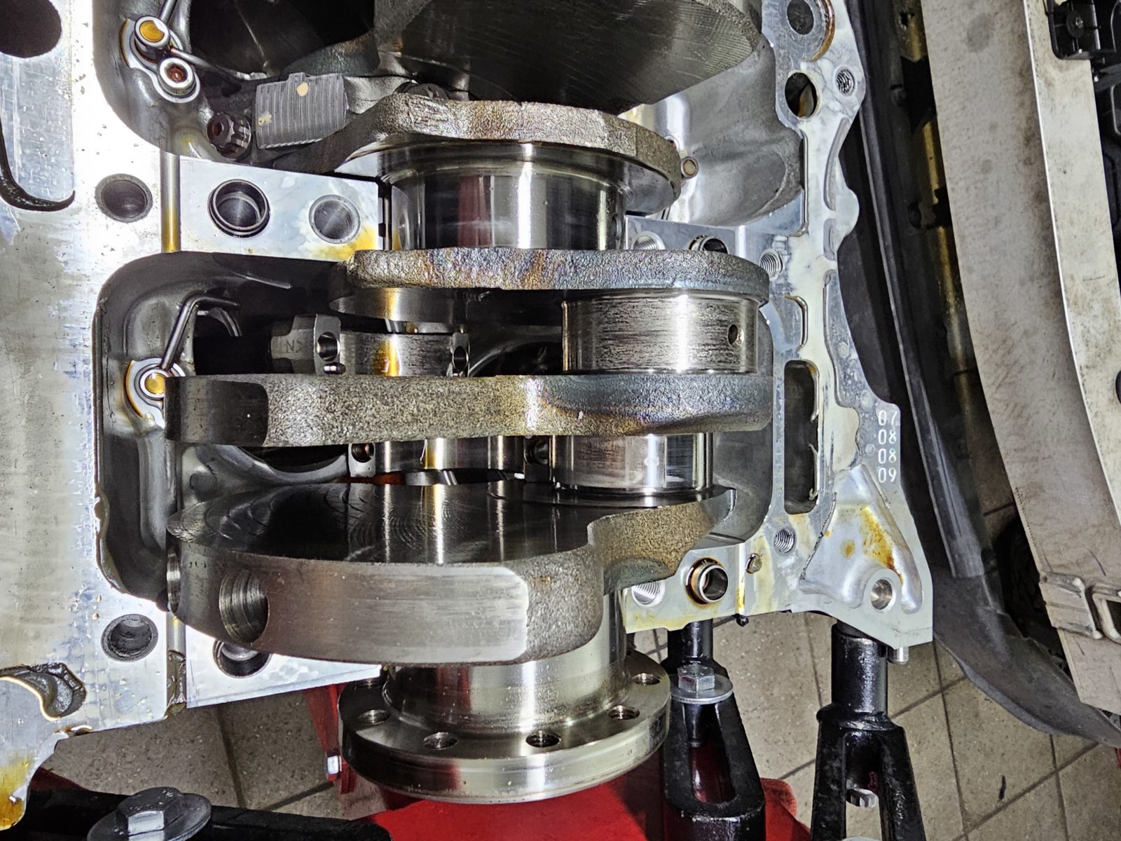

    Wow look at the heat discoloration on the crank around that rod journal. That's insane.

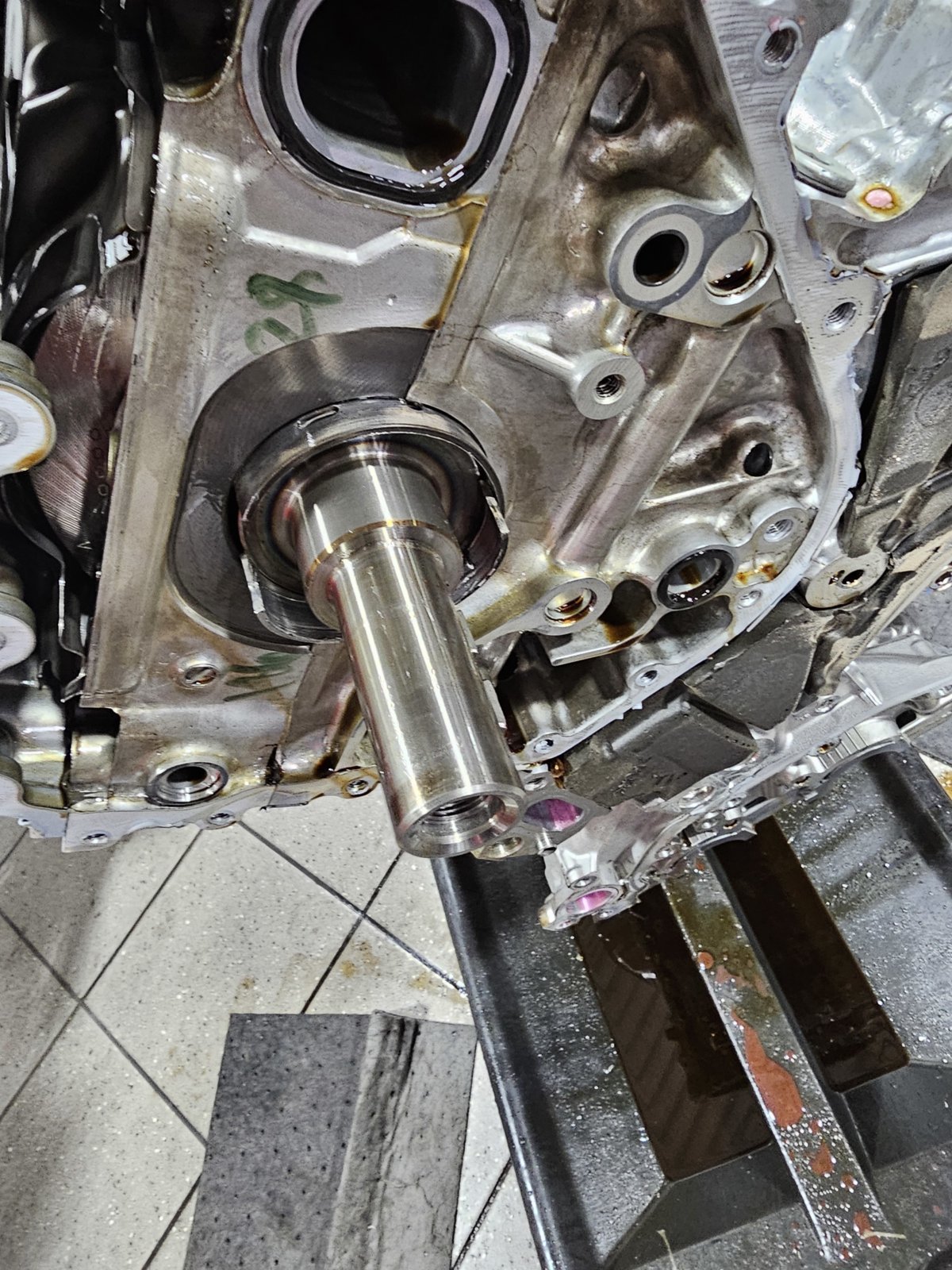

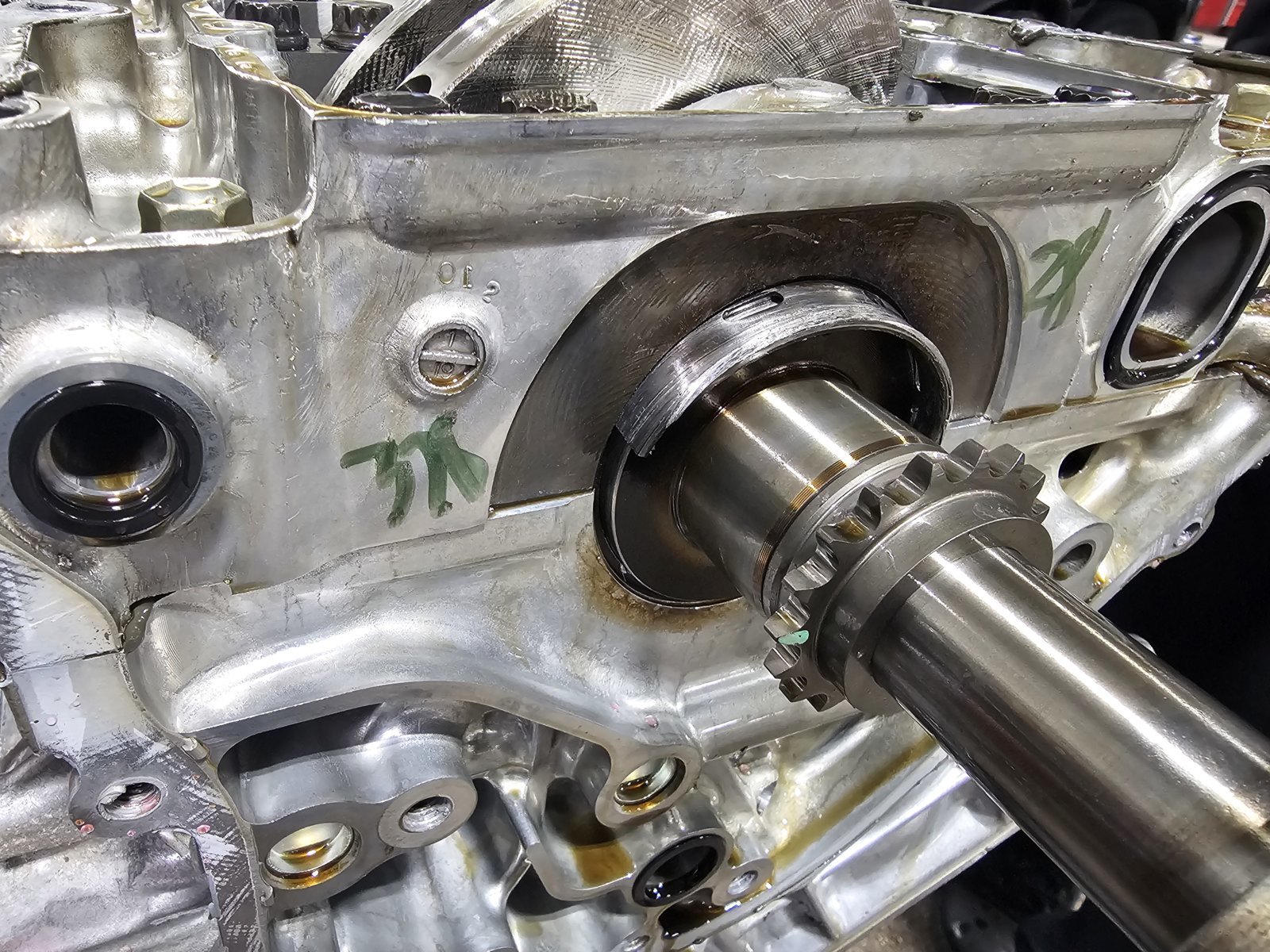

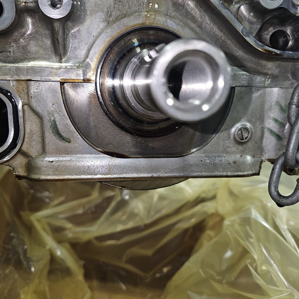

    I just replaced a short block on a 2023 Tundra with 49k miles. It was withing the engine recall production date of mid February 2023. This one production date was January 18 2023 but Toyota said the engine serial number was after the "new cleaning process date" So this Tundra wasn't involved in the recall. Yes the front main bearing spun.
    Today an April 4 2023 Tundra came in knocking & stalling. Not a surprise, the oil was metallic in color.
    Our field product reps are not happy with all of this & are encouraging us to make "dealer product reports" on the failed engines to get the recall stretched out to mid or late 2023 vehicles.
    Hard to see in the picture but the sections of bearings are at 7&1 o'clock & not 9&3 o'clock which is normal
