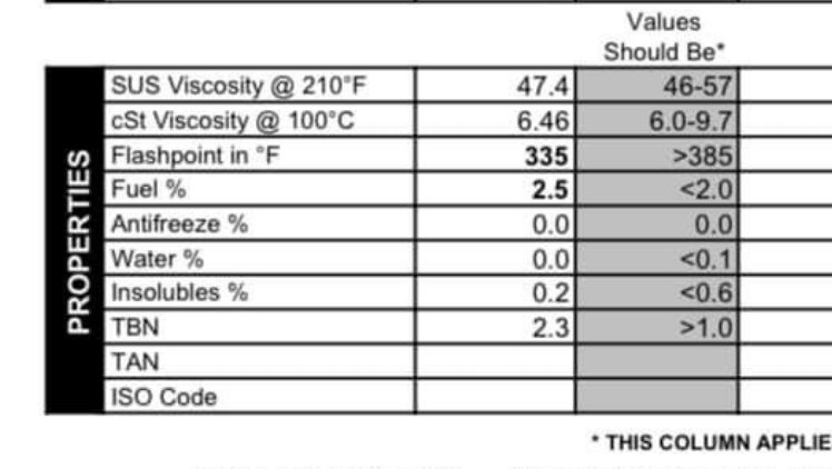

    send it in for oil testing if your worried about those things, lab reports are much better than speculation
  16. May 25, 2024 at 12:26 PM
    #766
    alex17117
    alex17117 New Member
    Feb 15, 2022
    #74634
    146
    Alex
    2024 limited, Lunar Rock
    I’m waiting on my report. I’ll share if anything interesting

    Did they show what the viscosity was?
    Dirt in the oil is a filtering issue and its pretty well shown that the Toyota OEM filters a very mediocre at filtering. That combined with the very thin 0W-20 oil being diluted with fuel I think is pushing these engines.
    These GTDI applications scream for higher viscosity. Not because the 0W-20 wont necessarily protect it fresh, but because the oil is being thinned out over time, and the longer the oil change interval, the worse it gets, especially if you dont work the truck hard. I think that Toyota should be specing 30 weight oil under the assumption that most people are not towing or working the engine hard regularly.
    I swear that the Ecoboost motors that had issues early on were a result of people who were not using their trucks as trucks. People were not getting their oil hot enough and not burning off the fuel. That plus the relatively long OCI's was combining to cause the oil to not protect the timing chains.

    So barely a 20 weight

    It seems that info isn’t included because there is generally nothing to report. Truck driving unloaded on highway gets the error message, makes bearing-eating noises, and a new engine is needed. That seems to be the how the reports go. And of course the owner is understandably furious.
    I highly doubt any owners are to blame for their spun bearings due to driving style or maintenance schedule. The fact Toyota says 0w20 @ 10k mile OCI does not exactly inspire confidence.
    The oil report above shows a flashpoint 50°F too low and fuel in the oil too high by 25%.
    For me—someone who wants 300k miles out of my truck minimum—those numbers are the opposite of not significant.
