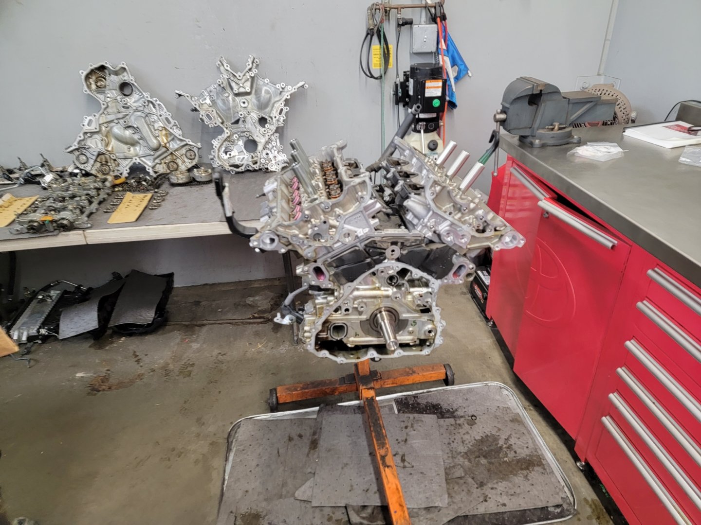

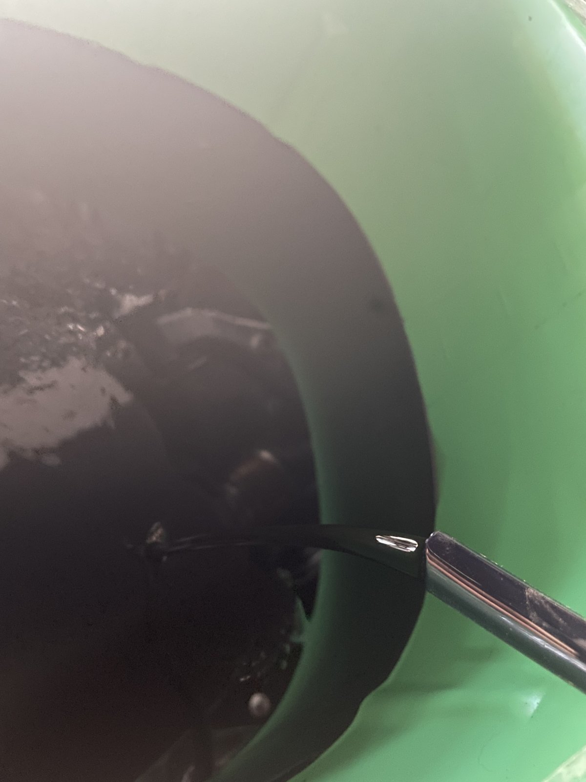

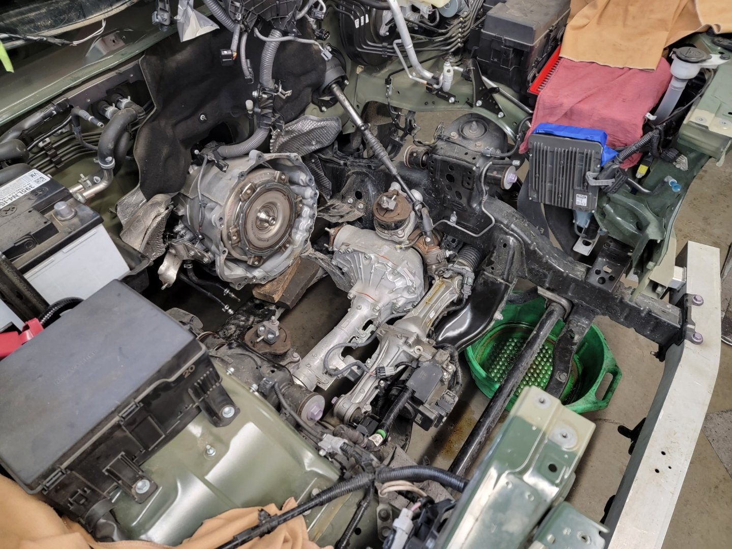

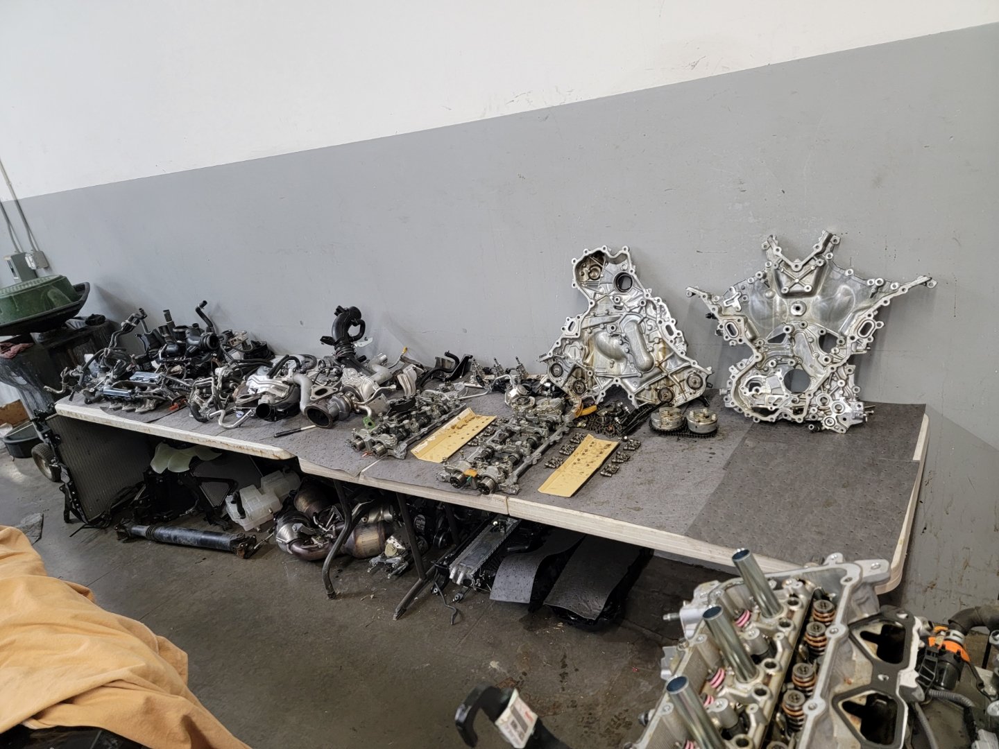

  30. May 23, 2024 at 6:10 PM
    #750
    BREAKAW
    BREAKAW New Member
    Dec 1, 2021
    #71322
    72
    2022 SR5 Crewmax TRD Off road
    Repair is underway. But my engine that was shipped on the 14th is missing with no tracking information.
