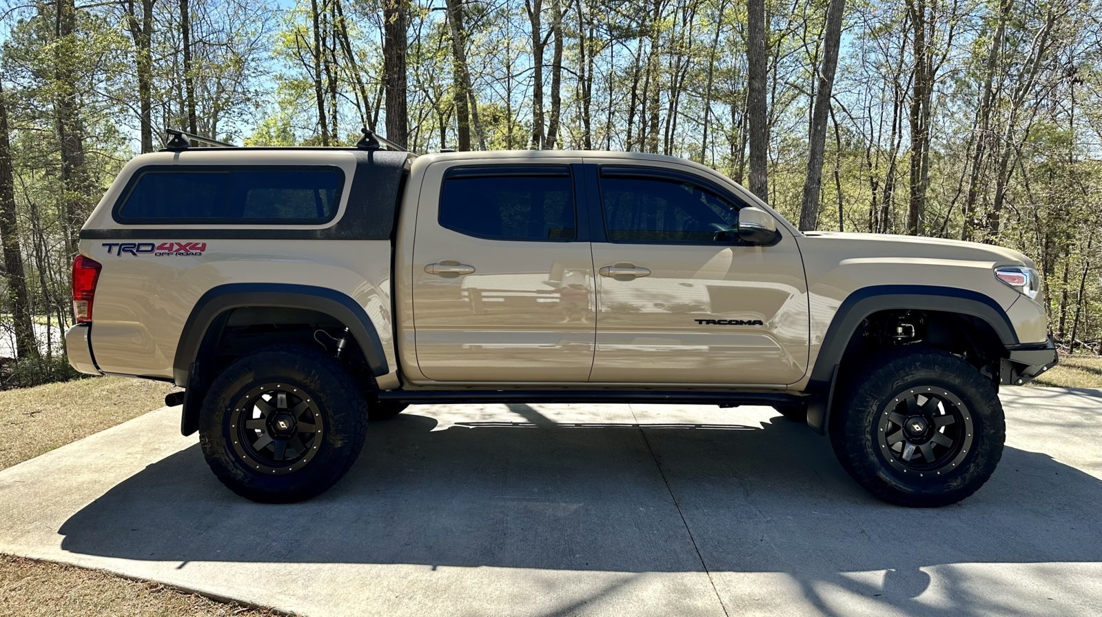

    GA
    2016 Crewmax
    My 3rd gen taco meets my needs aside from interior space. Wife, 2 kids and a medium sized dog makes for some interesting trips when we don’t take the 4Runner.
