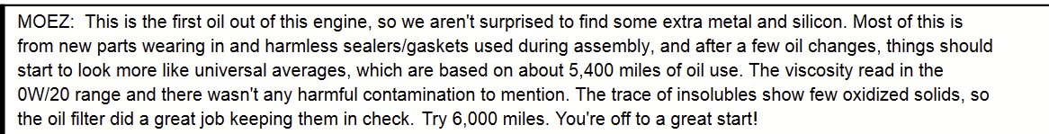

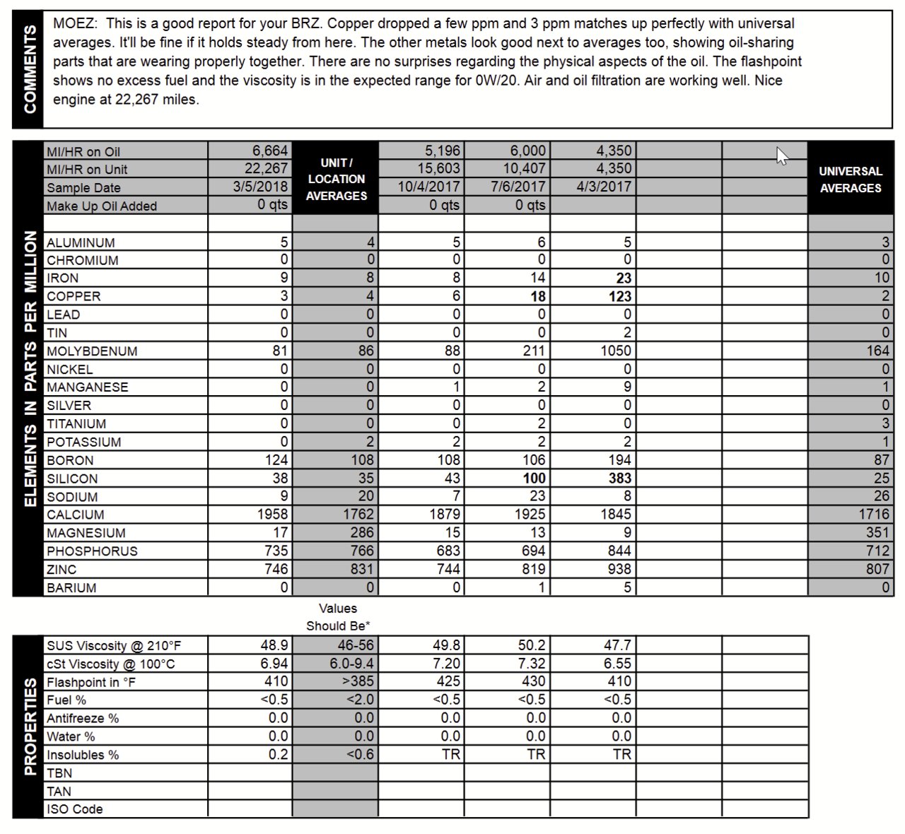

    Based on my driving habits and oil analysis, the recommendation from Blackstone was for a 12k interval.
    I changed the oil on my BRZ every 5k miles (it was a double duty daily driver and track car) A screenshot of the 4th report with historical data is below. The contaminants dropped to averages by the 3rd change. One of the comments in the very first oil change was that its normal to have these contaminants in a new engine but nothing to be concerned with.

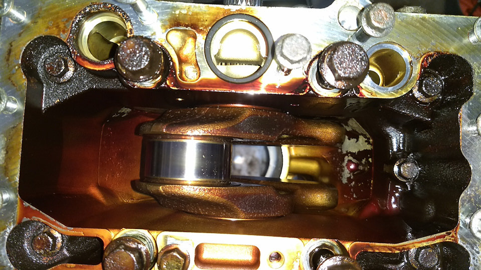

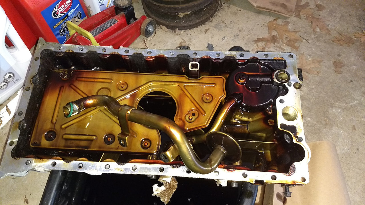

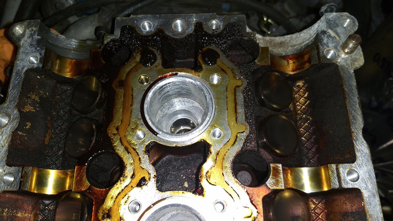

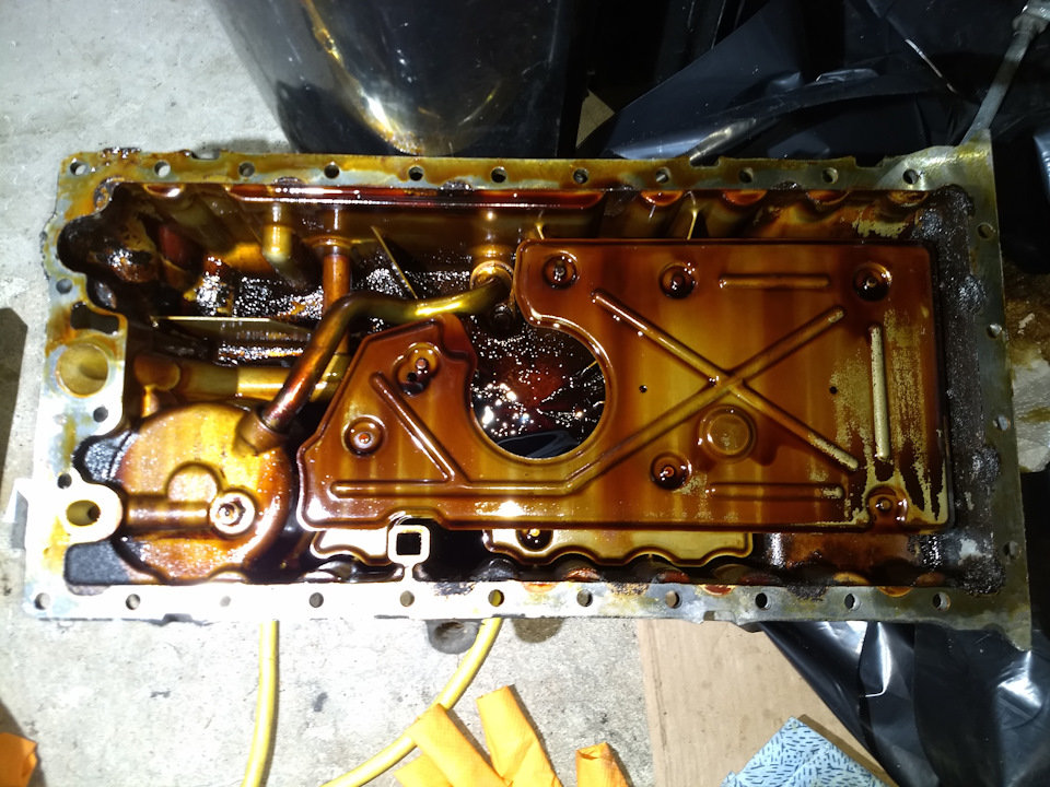

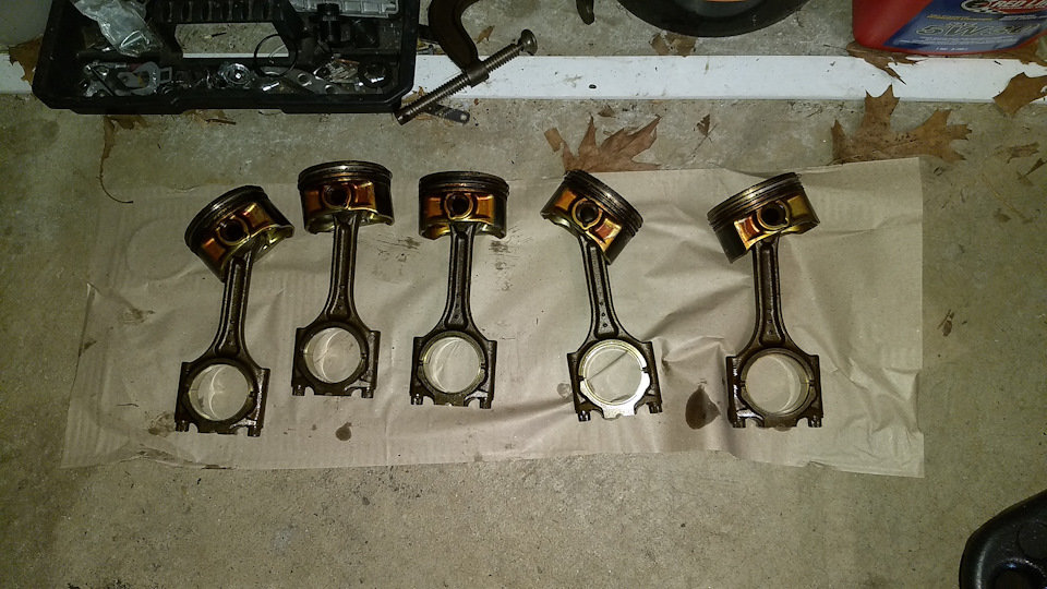

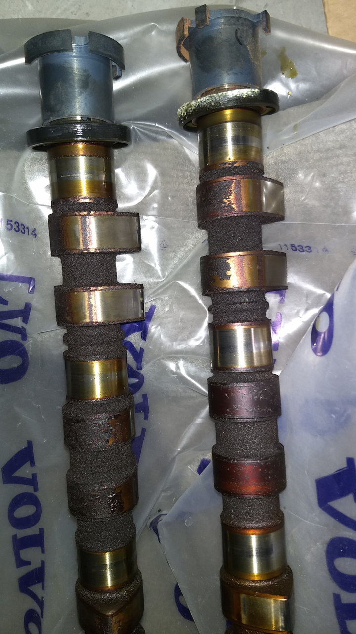

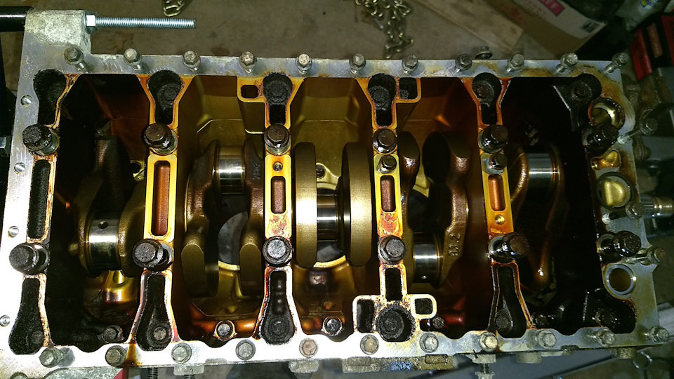

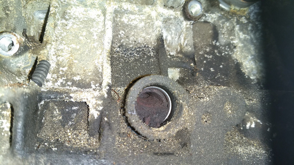

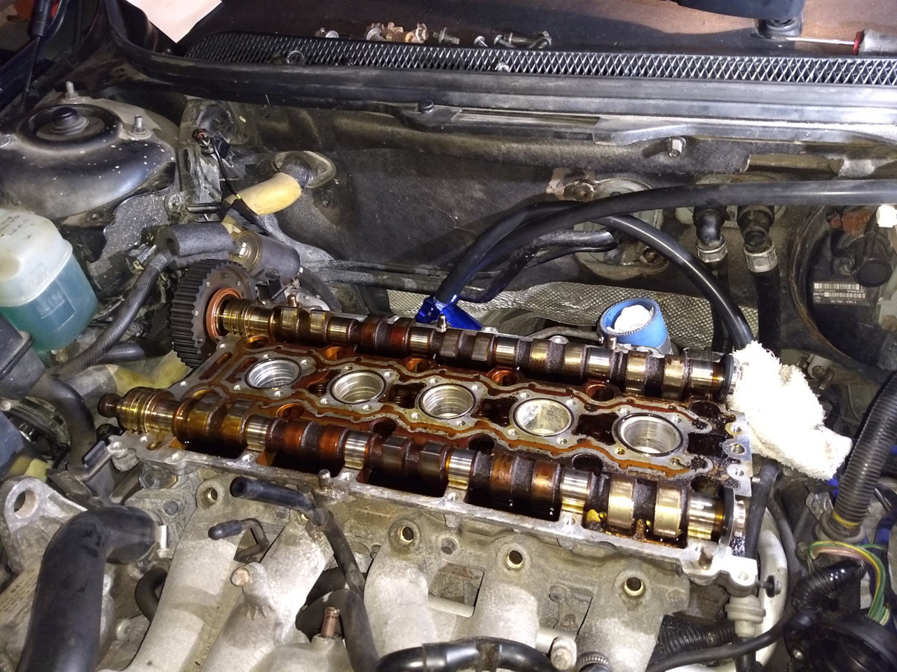

    Be true down to your engineering roots and take your engine apart! ;)
    Blackstone said this is an excellent oil that easily pushes it to 15k and beyond in this engine. 3 oils were used through the life of the engine: : German Castrol Edge, Amsoil Signature, Red Line. All are cornerstones of the oil freaks industry. With oil change intervals clarified by Blackstone based on oil state. When I hot-tanked everything and rebuilt the engine, I switched to a cheap Mobil 1 every 5k miles or 6 months, whatever comes first.
    By the way, gen 3 gets this in its twin-turbo V6, too.

    I tore out the engine on my BRZ and took it apart to strengthen the internals and put a turbo on it! Also rebuilt the engine in my Miata a few times. once those became dedicated racecars, I did oil changes every other competition weekend, so roughly once a month.
    I don't have the time or desire to tear apart an engine in my brand new truck, so i'm just going with the blackstone analysis and adjusting OCI based on their recommendations. I'll definitely post the 10k oil change results once I do that
    118957108_10221285539521659_7020627210325026887_n.jpg 104494166_10220635996803497_2809869529476442925_n.jpg

    Turbo is what kills the oil. I had a similar engine but N/A (same family), it didn't have any sludge or carbon deposits even after using random cheap oil.
