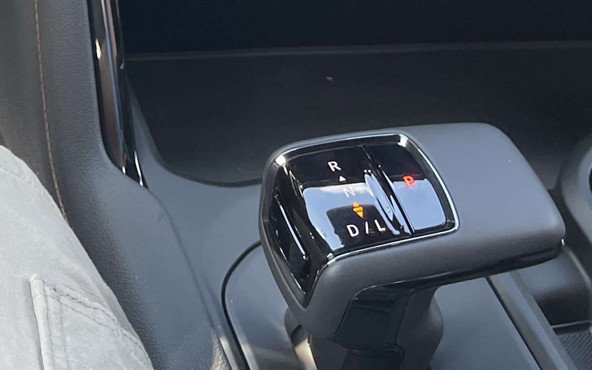

    I thought that one also about the new truck, I tested the 6.2 at4 gmc. The seats were so terrible I ended the test drive early and it rode shitty.
    one odd thing, the new shifter gm has up is reverse and you have to push a button for park, really odd.
    the gen 3 tundra was way nicer

    As to the GMC shifter, my wife's XT5 is pretty similar.
    You can't shift into gear unless you push the button on the side and it has a button on top to put it in park.
    I drive my Tundra with my hand resting on the shifter.
    If I do that in her car, and I accidentally pull it back, it goes into manual.:mad:
    I hate driving her car.

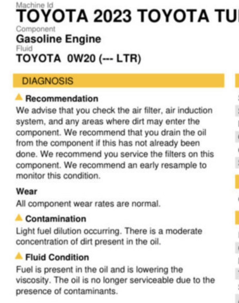

    I'm not going to set a 3k or 5k oil change interval arbitrarily. I'm an engineer, i'm using science and data to find out what the ideal OCI is for my usage. I'm sciencing the shit out of this lol
    I usually send my oil samples to Blackstone for analysis, and they'll recommend an oil change interval based on the data they see. For your first oil change, they recommend using the manufacturer interval, on the Tundra its 10k. I've been doing that on all my cars for 10+ years. On my 4Runner and Tacoma they recommended a 12k mile interval. On my Porsche they recommended once a year since I only drive it ~4k miles/yr. I have all of the PDFs of my oil change history going back to 2012 when I got my very first car and their comments saved.
    As far as brand preference, Blackstone did a report in 2017 that showed (with data!!) that as long as you're using one of the major oil brands, there isn't a quantifiable difference in oil performance or engine wear. For some reason my bookmark on their site for it is borked. Here's a Drive article that summarizes it. I'll grab whatever major brand is on sale at Costco, and usually it ends up being Mobil1.
    You joke, but I do a lot of electrical related work at Toyota now, even though my undergrad degrees are in mechanical engineering and physics.

    It’s true he did, but do you feel comfortable knowingly letting what is poor condition oil in your engine for the remaining 9k miles to provide lesser protection? I wouldn’t on my new 60k truck, personally. I’d change it for cheap insurance.
    4genRunner and ryanwgregg like this.

    Their recommendation was to remove that oil from service, actually.
