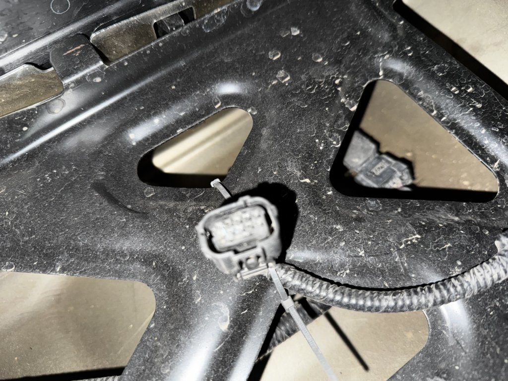

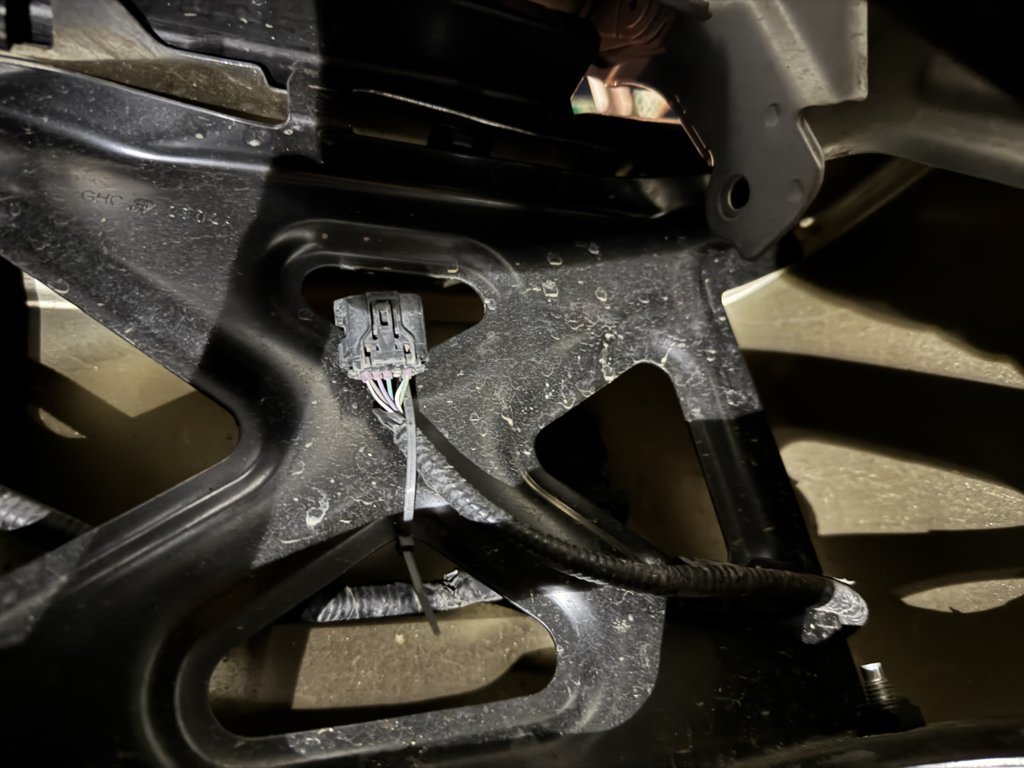

    IMG_1754.jpg IMG_1755.jpg This is an example of the cable. Driver rear bumper area. I bought it used so it could be anything I guess.

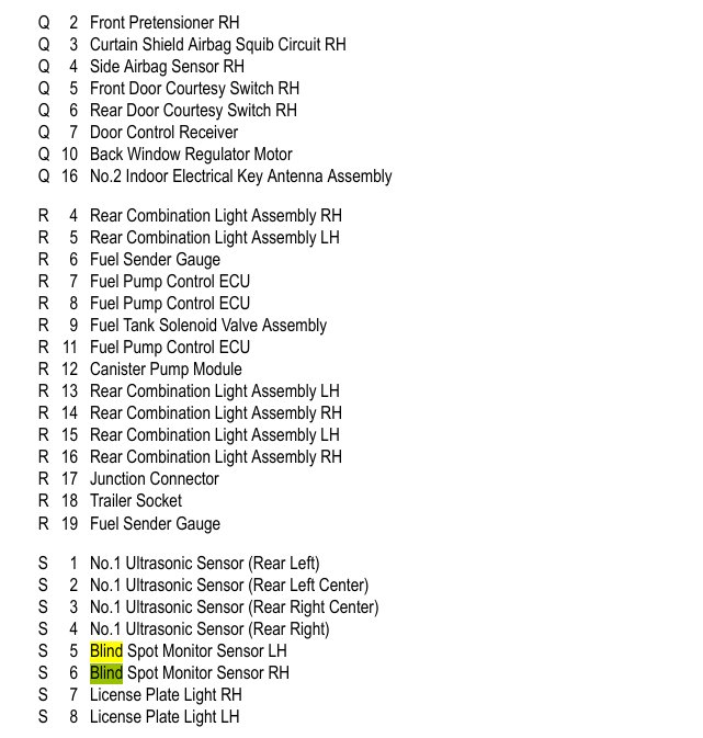

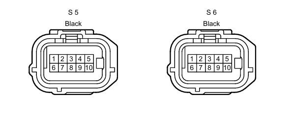

    I deleted my post because for some reason I thought he meant the front bumper caps.:eek:
    OP never did specify the front..:D
    @elembemedia did they look like this?
    Those are the BSM sensor connectors.
    And no, you can't just add them to make BSM work.
    But with a lot of work and the right parts you can make them work.
    Check out post 310 in this thread.
    RainMan's 2021 Lunar Rock TRD Pro Build | Page 11 | Toyota Tundra Forum
    New sensors run around $1K each but can be found cheaper on eBay.
    Sensor Blind Spot M 88162-0C051 | Sparks Parts
    You would also need to replace your mirror glass that have BSM indicators.

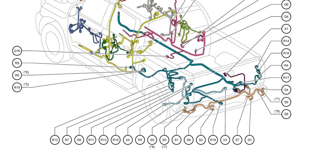

    Not sure how I missed being tagged in this thread.
    Those are BSM connectors, but those are not held in place using factory zip ties.
    If you have BSM mirrors in place as well, then my bet is that previous owner swapped the rear bumper out…either due to a fender bender as Gtboosted suggested or because they really liked chrome. In the 18+ trucks it wasn’t an option for there to be parking sonar without BSM - they used the same harness for both in the rear bumper.

    It is critical to note that the 18-21 BSM sensors are not the same as the 14-17 ones. They mount in a different orientation and use a different connector. That is why you need the extra mounting bracket in addition to the parts shown for the bumper end swap.
