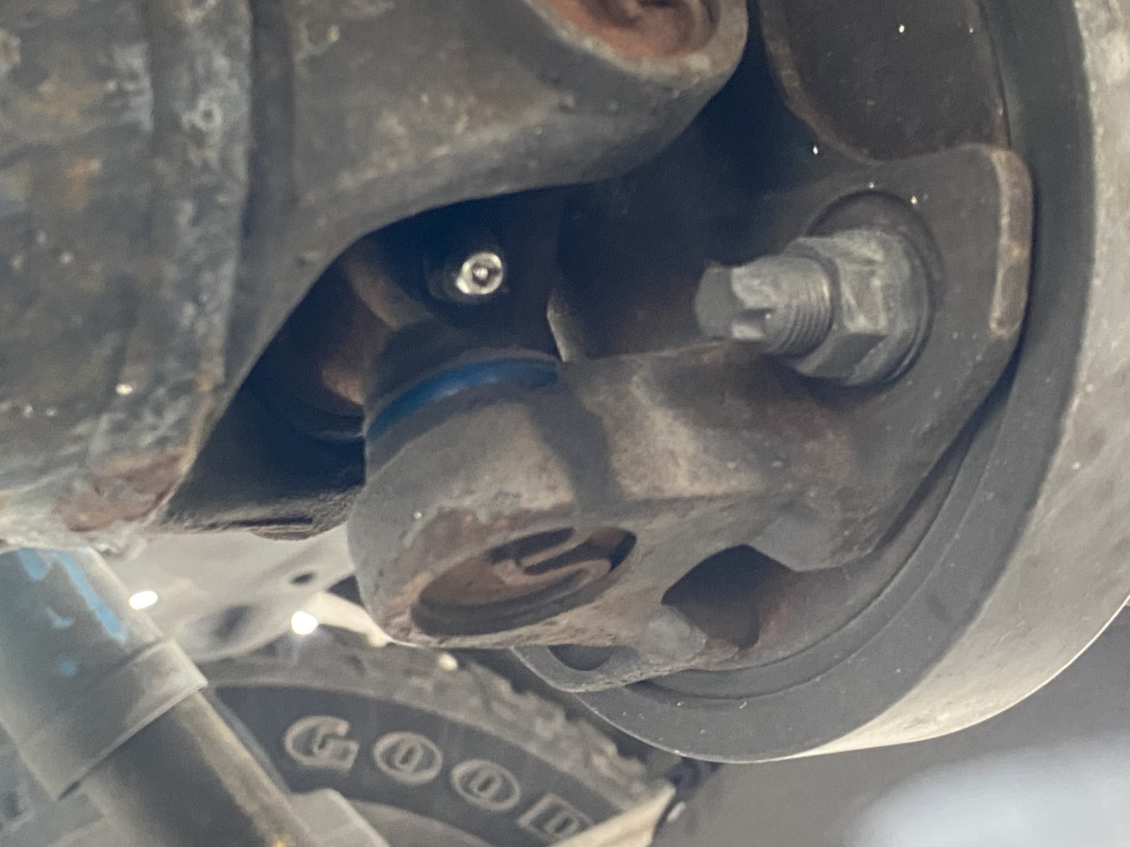

    You have a 2wd, pretty sure you're going to find no grease zerks

    Aarrreeee you surrreeeee ??????
    (My truck btw there’s more but I’m at work and it looks weird climbing under my truck)

    There's a reason I said pretty sure, yours may have been changed at some point but I was thinking it was all year, all cab type 2wd trucks didn't have grease zerks.

    That's aftermarket.

    Well fuck
