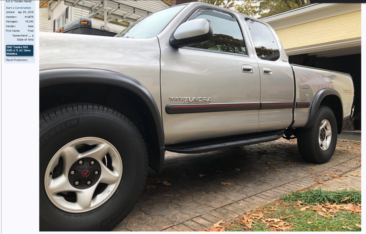

    Does anyone have black or other colors on the original tundra alloys? My center caps are faded and chipped and figure I can’t match the color.
    pics please. Or color matched option? I have these.

    Professional Hand Model painted his center caps black iirc. Not sure if his build thread is still around.
