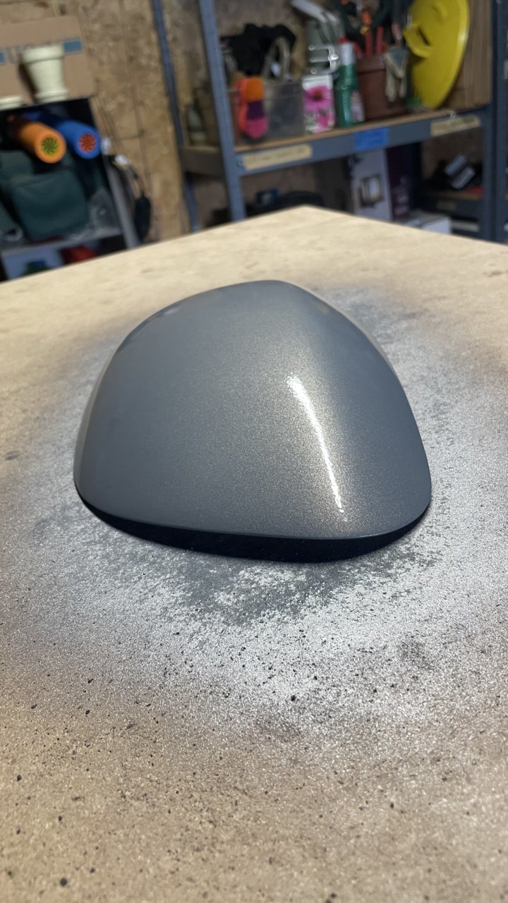

    I’m done prepping the wheels for paint. Spent at least two hours on each. They still aren’t as clean as I’d like, but I’m done.
    The paint had to be ordered online but it will be here soon.
    I also finally pulled the mirror caps off so I could properly paint them, and they came out great. It’s astonishing to me how good you can get rattle can paint to look.
    Removing the mirror glass required a lot more force than I was expecting, really felt like I would break something, but it was fine. Cleaned up underneath really well.
