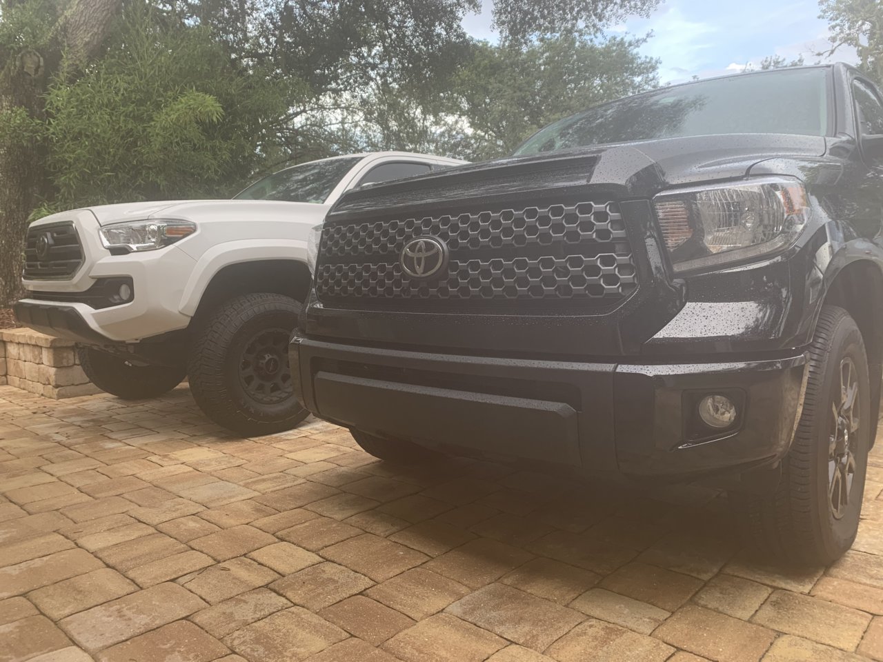

    Came over from Tacomaworld, just upgraded my taco to this big beautiful babe. All stock for now, but already planning my build.
    Lift will be around 6"
    Front:
    Maxtrac Spindles, OME (612) and SPC UCAs = 6"
    Rear: OME Dakar Leaf Pack and 1.5" Shackle = 4"
    (Extended brake lines, ubolts and carrier bearing drop as well)
    Wheels: Stock Black Toyota Rims w/ Nitto RGs 35"
    Planning to paint interior and emblems with cobalt blue as an accent color. Chrome delete as well from AJT Design.
    Debating on replacing the grill and adding a light bar at some point, seen a few cool ideas on placement, especially like the ones by NSV for the hood.
    Looking at storage under the rear seats and a full system (subs behind rear seat).
    Plan to upgrade exhaust, have been reading everything on the Dirty Deeds group buy, somebody talk me into it lol
    What's Complete:
    NFab Podium Step Bars
    What's in garage and waiting to be installed:
    Wet Okole
    OME 612s
    Pics: My new love interest "Black Betty", my gf's lifted 19 Tacoma next to my new Tundra, my first love 09 PreRunner with a 6" lift on 35s "Black Beauty"

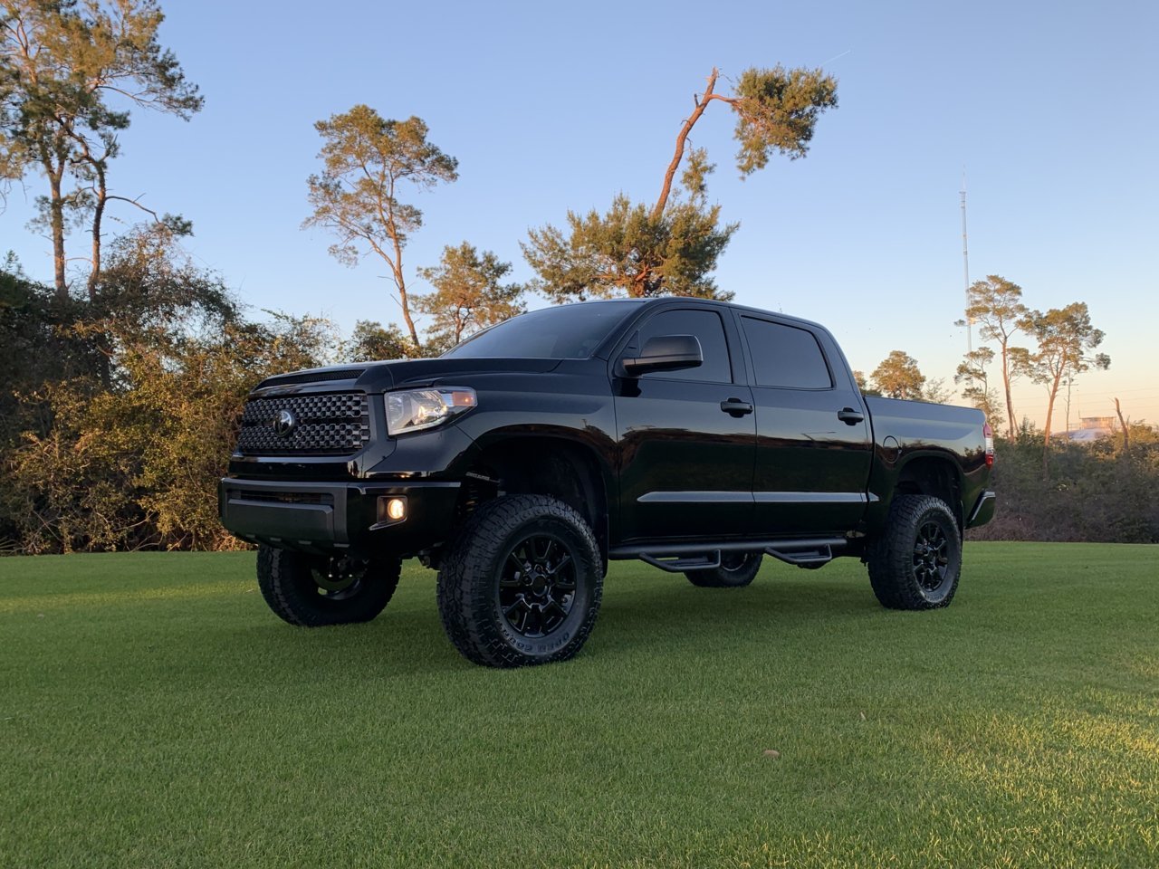

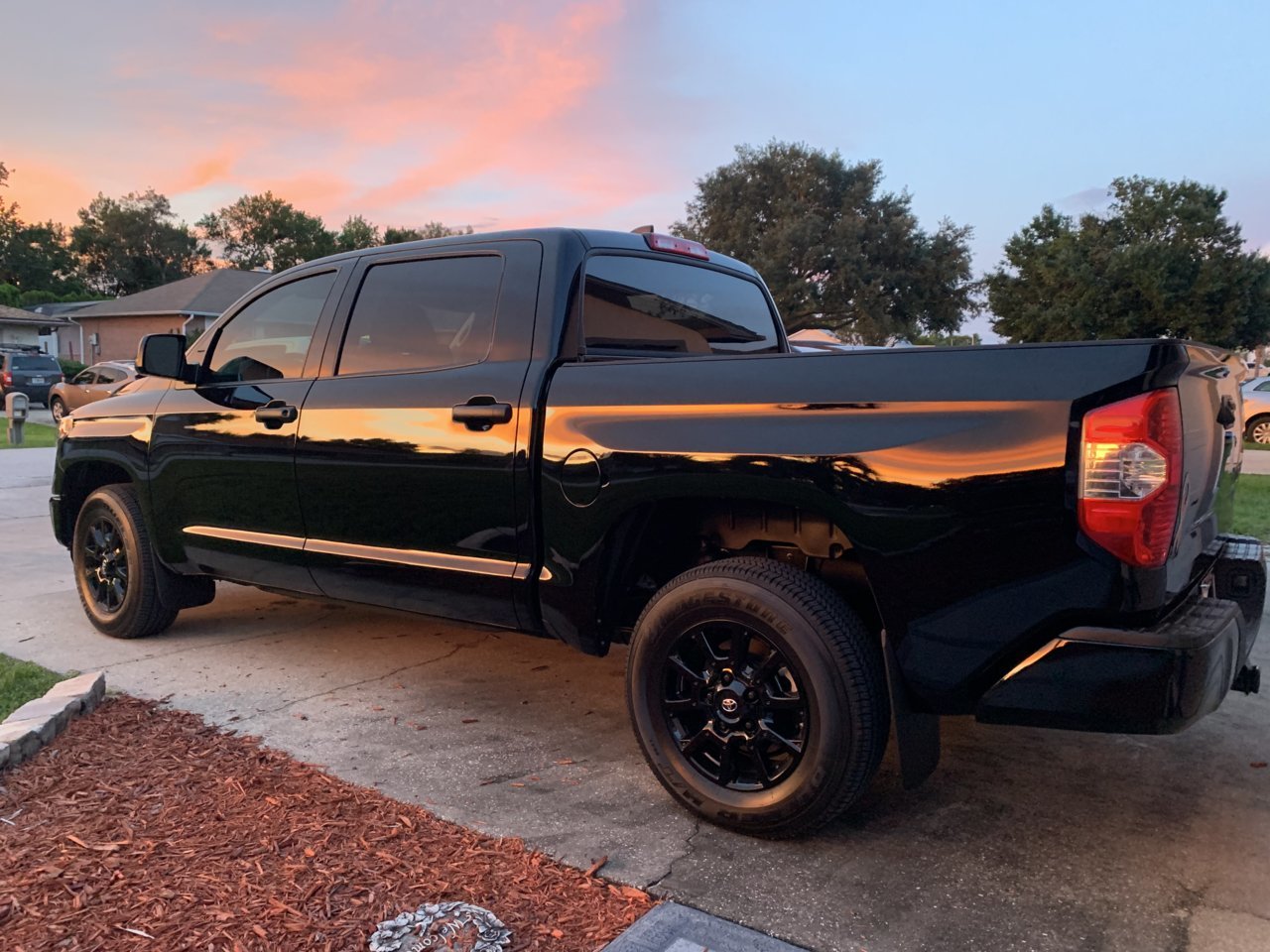

    Finally had the time to install the lift this past weekend! She now sits 8" higher with tire height included.
    FRONT: OME 612 Coilovers, Dirt King UCAs and Maxtrac Spindles
    REAR: OME Dakar Leaf Pack, Toytec Shackles and Extended Bilsteins
    TIRES: Toyo Open Country AT2 Extremes 35x12.5x18, stock rims with Spidertrax 1.25" wheel spacers

    Fun Facts about installing your own Lift (This was my 4th truck I've lifted and by far the newest)...
    Tighten it all down and recheck! Had a knocking sound that ended up being a loose lug on a wheel spacer.
    The computer will go nuts after a lift this high and bigger tires, had to take it to the stealership to get them to recalibrate everything (Cost was $150). Tire shop didn't know how to fix it, due to it being such a new model.
    Half of the Youtube vids out there do not give the correct bolt sizes.
    It's totally worth tackling a project like this and feels crazy good wrenching yourself.
