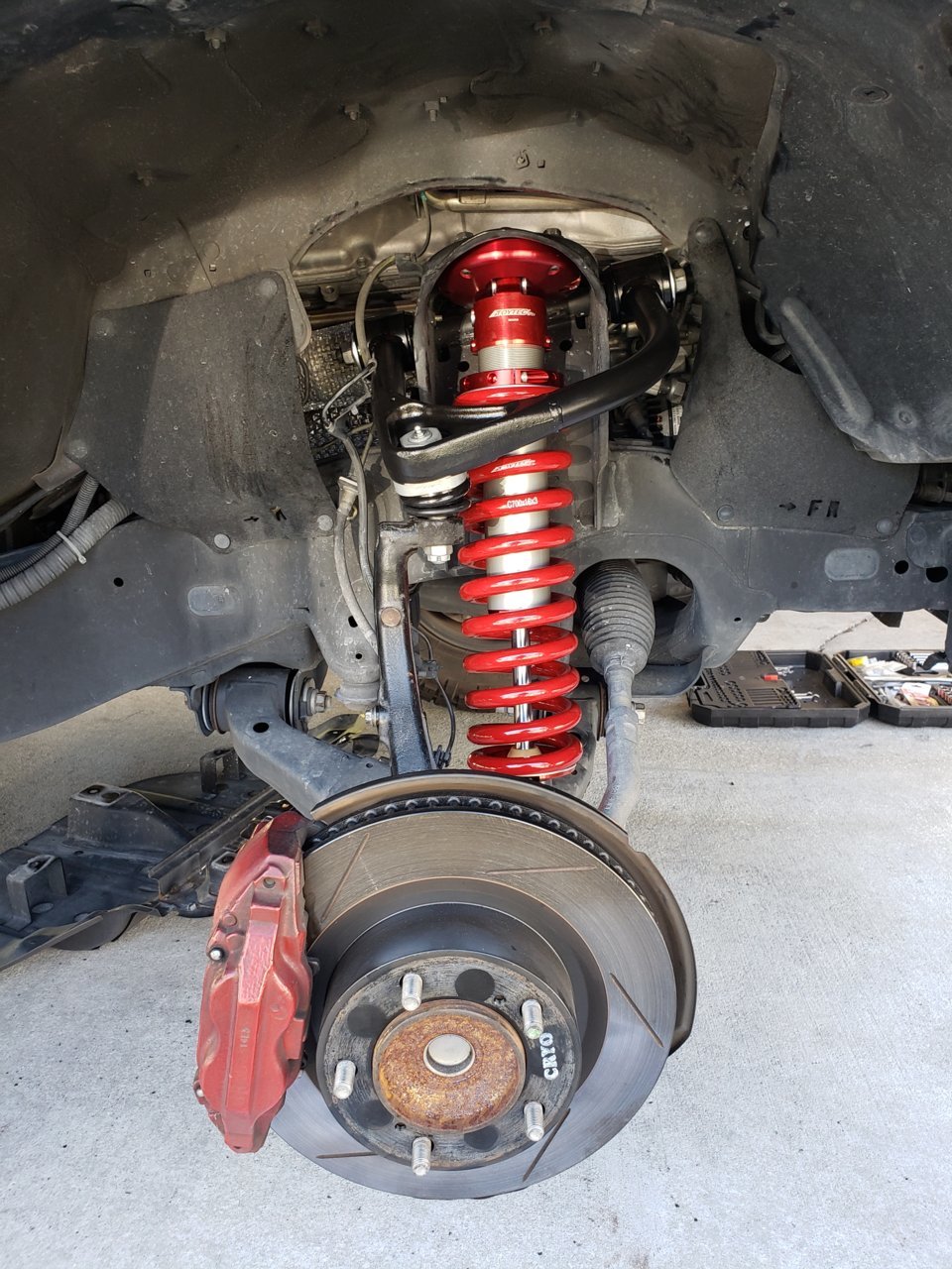

    What are you thinking of buying? @Toytec Lifts carrie's multiple brands but their systems are very nice and highly recommended by many members.

    @Tundra234 gonna be going with the Toytec 2.5 Aluma Complete kit and will be running Camburg Ball Joint UCA's

    Smart move. That is what I have with SPC's. Are you going to install it yourself? Toytec has a forum discount code. Its 10650

    Yeah it is an awesome setup. I switched after running a Readylift spacer kit for a year and a half. I run the Boss resis in the rear along with Toytec shackles set at 1.5 and a 1/2 axle shim.

    @Tundra234 Did you HAVE to run the axle shim? Did you go any higher or around same height as you were with the spacer?

    With the Readylift 3/2 I was a tad higher in the rear end. I have a 4.6 and with the Alumas I came up a little more in the front. I removed the 2 inch block and replaced it with the shackles and the axle.shim to keep the 2 inches. Since the Alumas came up in the front, now I sit dead level. From the bottom of the flares to the ground, I am right at 41.5 on all four corners.

    @Tundra234 Trying to decide whether I want to get the complete kit on Toytec or buy separately since I want CB shackles but dont know what size to get and debating on the BOSS with the rear resi or the new aluma rear 2.0's that toytec just came out with. Would there be any real difference in the rear since both are 2.0?

    On the front coilovers, the Alumas come in 2.0 and 2.5. Mine are the 2.5's. They are a little thicker shaft and shock body and both are 700 lb springs. I have the Boss with the resis on the rear as they are for 1-3 inches of lift. Those rear 2.0's are new within the last couple of weeks and also for a 1-3 inch. If you are going with the 2.0 coilovers ( I think those are new as well) either rear setup will be fine. As for shackles, the Toytecs are beefy. It comes down to personal preference and what size lift you are doing in the rear. I run mine at 1.5 along with the 1/2 inch axle shim and I am dead level. As for the UCA's, I highly recommend the SPC's. Sparks part is the cheapest that I have seen them at $545.00 Are you doing the install yourself to save on labor?

    I did come up a little higher in the front and used the axle shim to keep me level. Part of being higher in the front is also contributed to being 2WD and a 4.6. Here is a side shot.

    You will be good to go with the 2.0 coils and those 2.0 shocks, and they will be $100 cheaper. The biggest problem I had with installing the shackles was having to lower the exhaust bc its custom and I was hitting the leaf springs during install. I used a ball joint press and an impact wrench to push the bushings out.

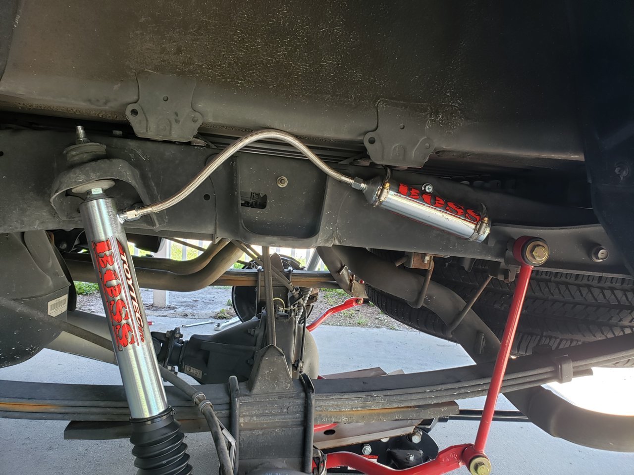

    @Tundra234 I have no problem running the rear resi just thought the 2.0 was cleaner. Is there a specific reason I should run 2.0 coils instead of the 2.5's like you?

    Money isnt an issue between the 2.0 and 2.5 just again trying to decide on the rear, and the shackles cause apparently CB shackles are super easy to install.

    Their site says they are designed to compliment the 2.0 coils but I think you should be fine with either. The 2.0 is a 16mm shaft and the 2.5 is a 19mm shaft and 2.5 shock body.
