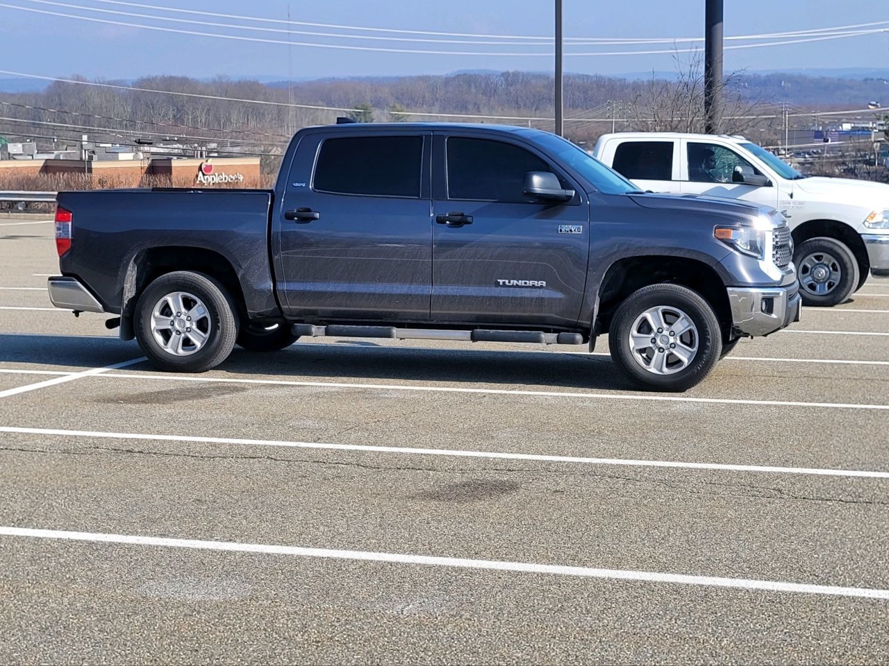

    Very good point. I'm not even looking for them to take the total loss, I'm half the equation. I just want it right. I go back and forth.. in this pic, she looks just about level. I don't know if I'm nitpicking or not. I will take measurements tomorrow.

    Looks great in that pic

    So took some measurements, and I guess I'm nuts..
    Driver side front = 38 7/8
    Driver side rear = 39.25
    Pass side front = 38 7/8
    Pass side rear = 39.00
    So I guess it's level and I'm paranoid! Funny thing is, if you look at the pic of my shock, I'm almost wondering if the spring perches are on the middle setting, even though the guy at counter said top setting.
    I only see one perch groove visible below the collar, if it were on the top setting, wouldnt I see 2 groves?
    Either way, for now I'm happy and moving onto my wheels and tires.
    I thank you each and every one of you!

    RUN with it. Perfect. Looks great in the last picture you posted. Move on to something else. You throw 2 bags of dog food, couple cases of water or a decent day of shopping at Costco in the bed, and it will be exactly level. .25 difference is no difference really.

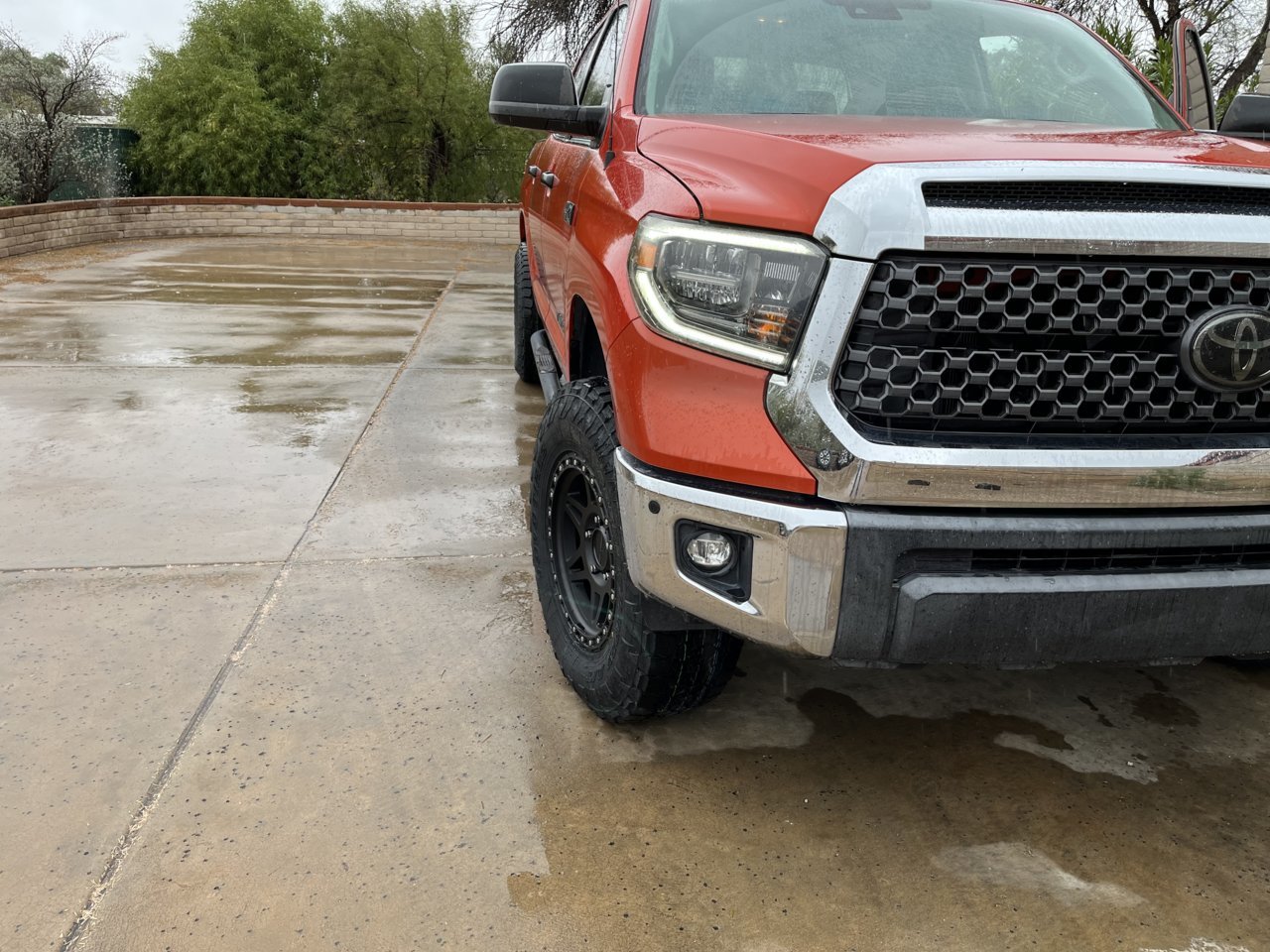

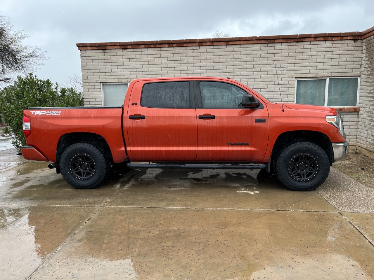

    Hopefully this will help others down the road. After installing Bilstein 5100's on the front to make it level, I went with Toyo Open Country LT285/70R18's on Method MR12 18x9 +18 offset. Wheels stick out 1.5" and look perfect. I had minor rubbing and was able to remedy it without cutting anything. On the back of the wheel well on the driver side I just used a heat gun and reworked, the well liner, passenger side required no rework. On the front of the wheel wells was where most of the rubbing occurred. I removed the lower plastic, drilled a new space for the metal grommet and then back filled the old hole so it would never work its way back into the original hole via vibration. The other smaller screw holes I just drilled new holes. This moved the front of the wheel well liners forward about an inch or so and I get no rubbing at all. This just seemed so much easier, and better looking than cutting anything out because you cannot tell I made any modifications to the wheel wells. Tundra Tires.jpg IMG_9076.jpg
