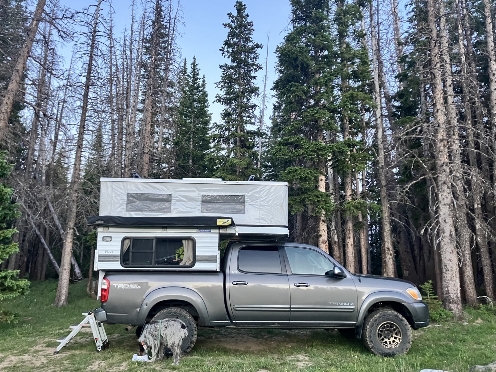

    2005 Phantom Gray DC SR5 4wd
    I recently put 5100’s + 2884 springs on the front. I plan to add an Alcan leaf pack and fresh shocks to the rear soon. The rear 5100’s though are for 0-1” of lift and I might go more like 1-2” with the new leaf pack.
    What’s the issue if I use 5100 or 5160 with more lift than recommended? travel limitation?
    Is there a downside to mixing brands, eg Bilstein front and Icon or something else rear?
    My off-roading is generally the slow rocky variety and short distances getting my camper to dispersed campsites.
