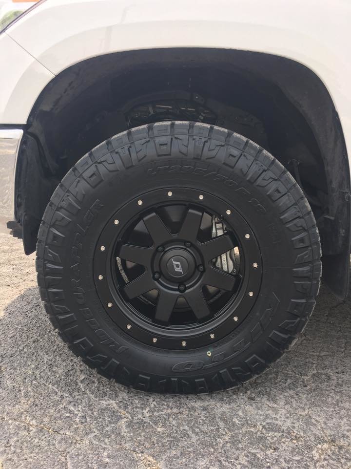

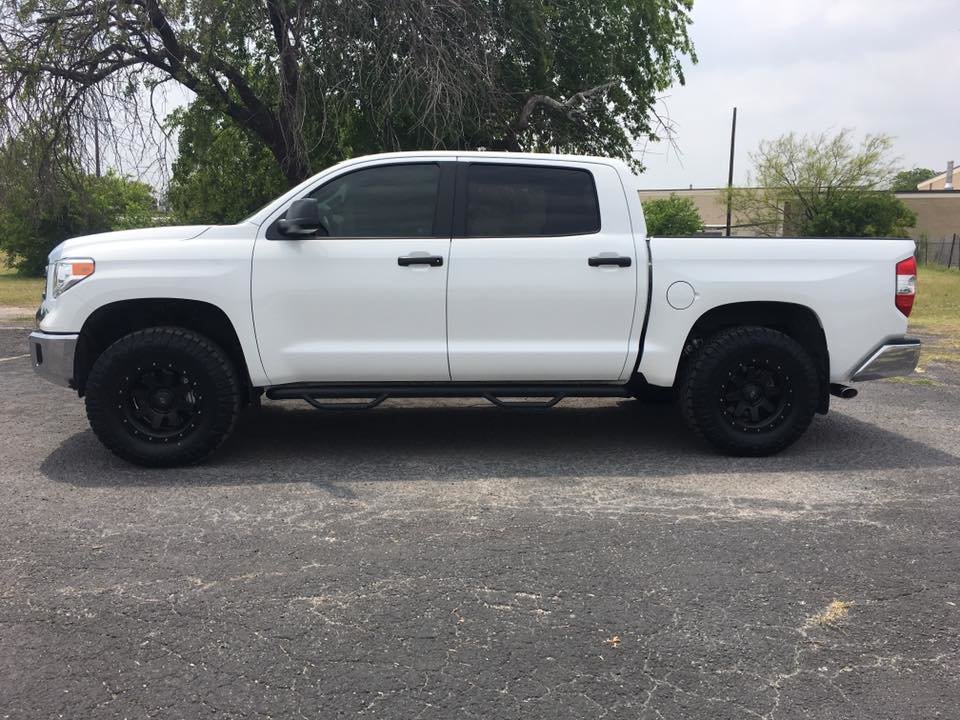

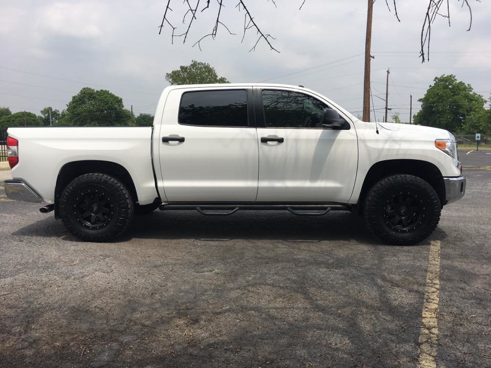

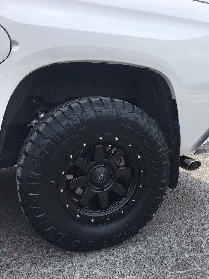

    Here's my 2017 CM with 6112's at top setting 2.5" and 5160's on rear with stock height on rear! Slight rake up front but I like it being when I do get a heavier front bumper it should sit just right!

    Yeah, looks good. The only thing I will say, is Ive heard the double cabs (like mine) will sit even higher than the crewmax in the front due to weighing a little less. If I had a crewmax like you, and planned to do a aftermarket bumper and winch, I would definitely have gone 2.5" like you chose. I honestly hope I have a little rake (nose slightly lower than the rear) so since I read 1.9" usually puts double cabs just a hair nose higher than level (or even if its level), im hoping the bumper and winch will pull it down 1/2" to 3/4" lower than the rear. If the front is more than 3/4" lower, I will probably add a 1/4" shim as was suggested.
    What size tires are you running there in the picture?

    How is the ride in your truck at the 2.5" setting VS when it was stock?
    What size tires are those in your picture?

    The ride is amazing in my opinion, It is firm but yet smooth and strong! It handles well and absorbs the bumps real good, I even try to find bumps just to see it handle well! The difference from stock is amazing and very noticeable i every way, ride, handling and with my Nitto Ridge grappler 295/70/18's it hugs the road and handles so much better then stock!
    I would advise any one who bought the SR5, TSS or TRD package to upgrade as soon as they can, they'll love it!
    18198393_10212141074380679_2946157339676270972_n.jpg 18221844_10212141073740663_8291378223976866149_n.jpg

    They look good. I was very torn between 18s or 20s. The 20s look too big (not enough sidewall) until you get to 35s. If I was going any smaller than 35s, I would run 18" wheels. In 4 years or so, once the warranty is up, I might even run 37s. So I figured 20s are a better option for the larger tires.
