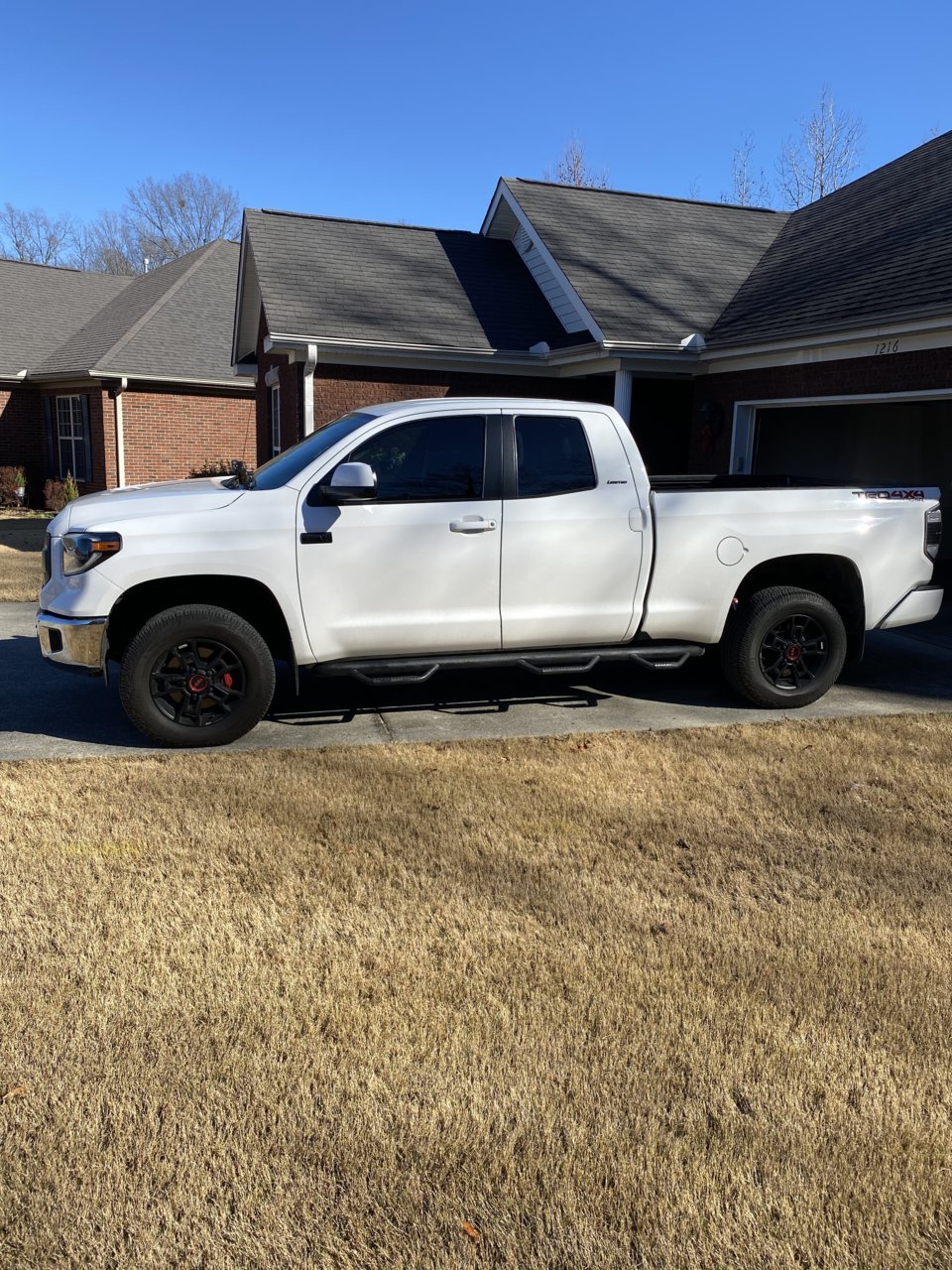

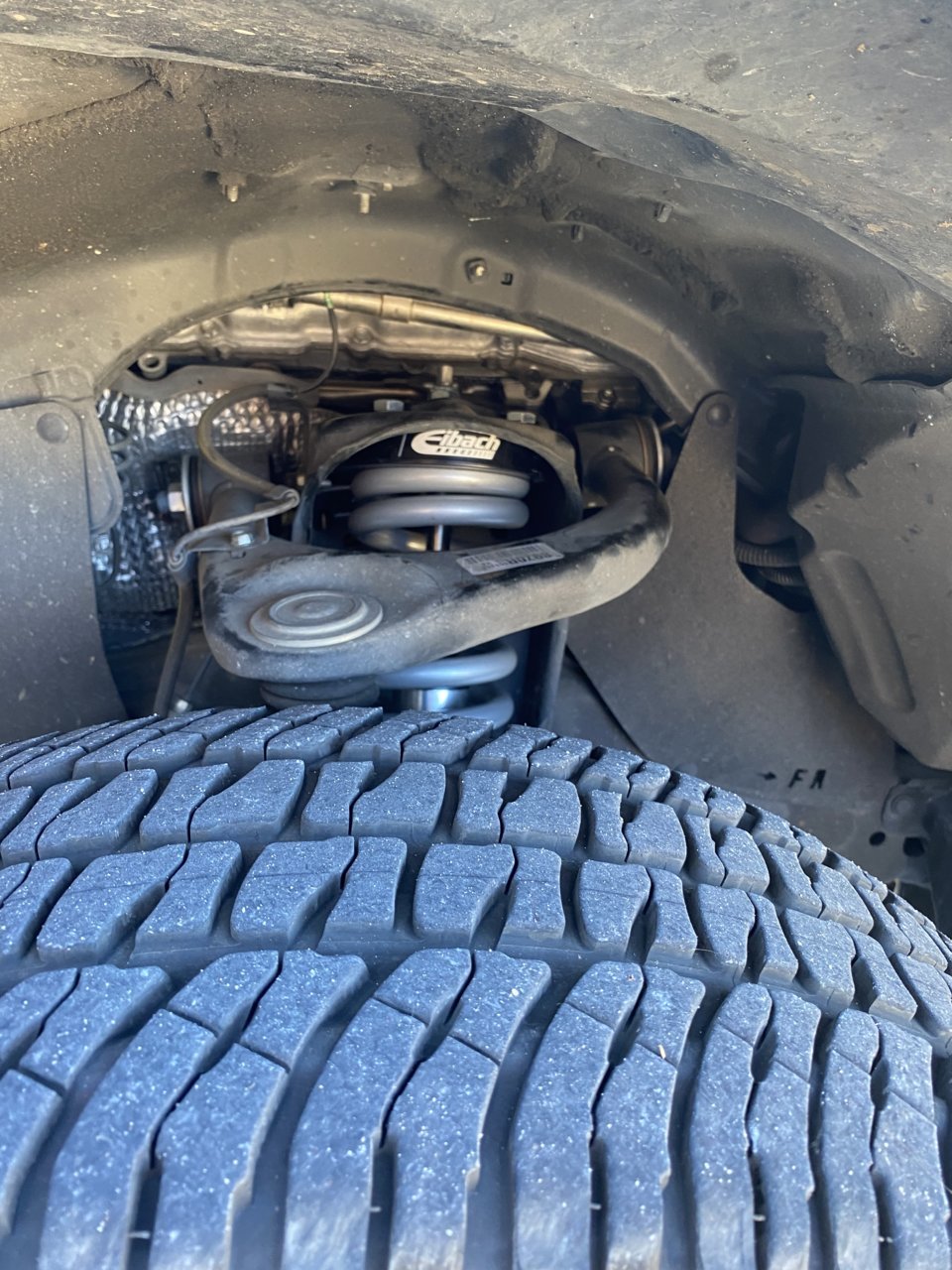

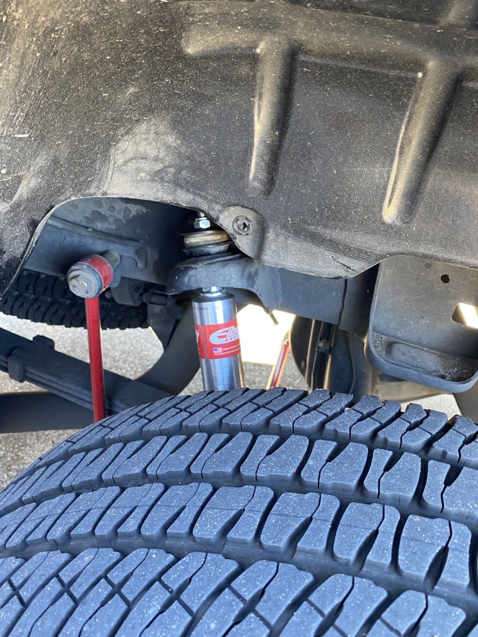

    Absolutely no regrets. Eibach Pro 2.0 coilovers front and Eibach rear shocks. I have +3 Coachbuilder shackles. Loving the rake I still have. Now I’m waiting on my ARE topper to come in.

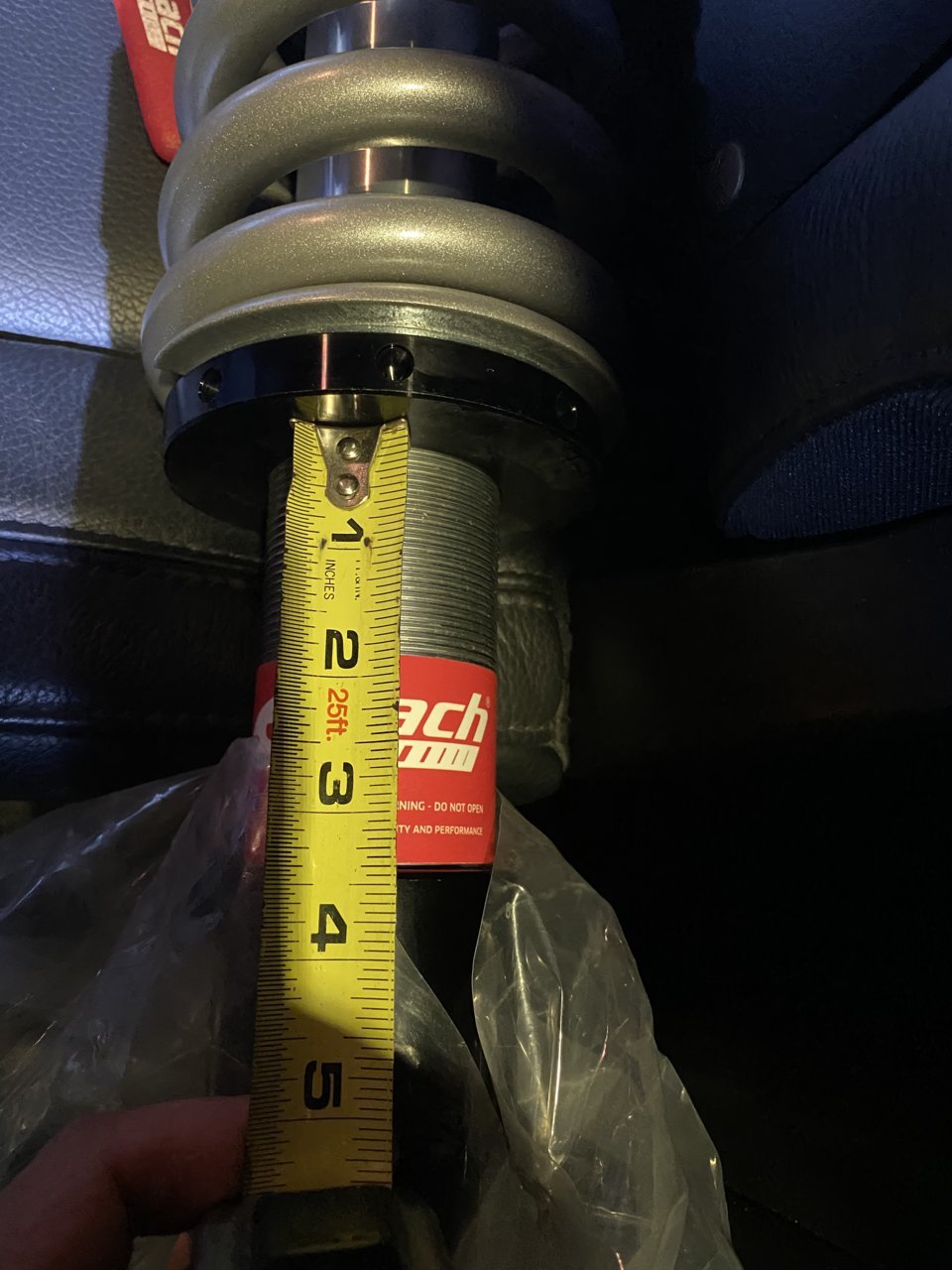

    Do you know how much lift you got up front? Did you leave the coilovers at preset?

    That was going to be my question as well. I am looking to do 2.5" of lift in the front.

    I got two inches of lift. They came preset and threads measured at 3 3/8. I believe if your turn them .25 inch that would equal .5 total.

    Thanks for this info. I will measure my exposed thread as well. I was hoping for 2 inches of lift but I heard some conflicting numbers from some people and eibach as well. I got extended bolts in order to install shims to compensate for lean and some heavy weight.
