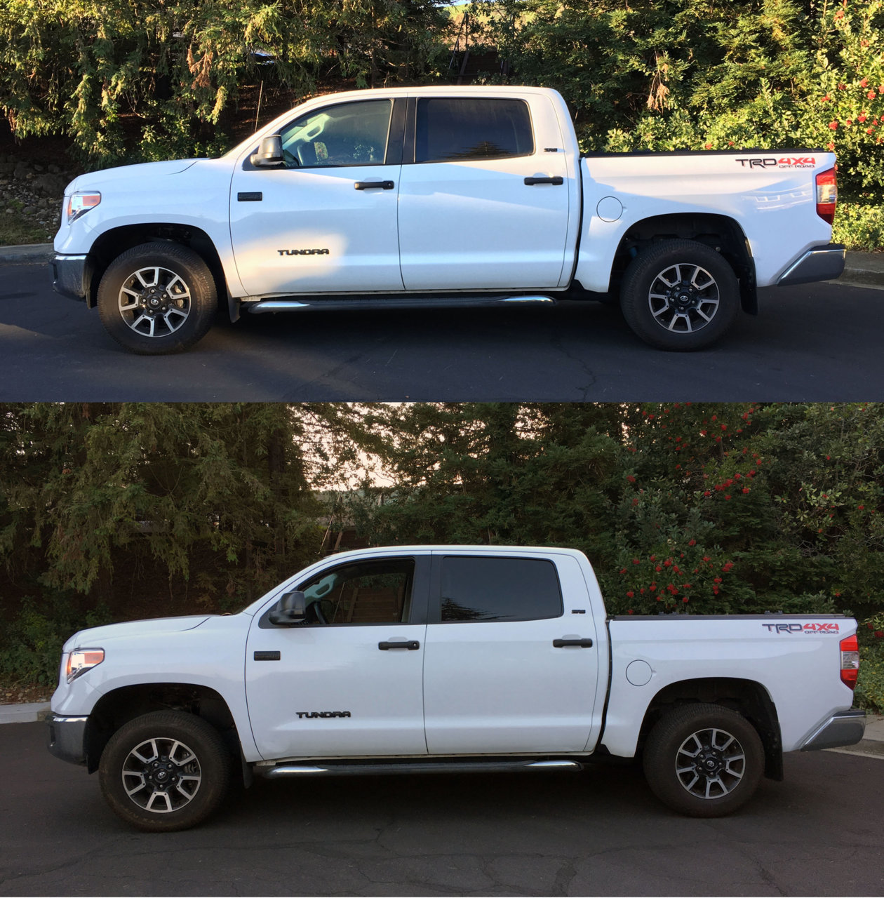

    I have 5100's on the middle setting with 1 coachbuilder shim on each side. Total lift in front is 2" and is level with the back (I did not want to add blocks or shackles to the back). The ride (IMO) is better that with the stock TRD shocks. (Currently running the stock 275/65 18's)

  11. Mar 8, 2018 at 4:54 PM
    Kmaiboy
    Kmaiboy New Member
    Sep 15, 2017
    #9681
    82
    2018 White TRD Sport CM
    Looks really good how much did that setup cost? Did you just do the front?

    Thanks. I did 5100's on all four corners. Shocks were ~$400 from Amazon (my install was scheduled and at the last minute I decided to return the spacer lift I had purchased and go with the 5100's) and the install for all 4 was ~$600. I could have paid less for the install but decided it was better to take my truck to someone who specializes in building off-road vehicles. I am really happy with how it turned out.
    Thanks - it is a slow process but it's getting there. :)
