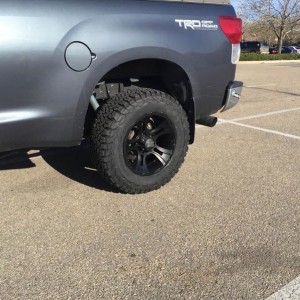

    I'm running bilsteins with 275 65r 18s with no spacers on stock rims and have plenty of room left over. I wish I would have bought the 70s now. You shouldn't have any issues with rubbing. Posted a pic to give you an idea. I put 1 inch blocks in the rear as well.

    Thanks for the pic. Looks nice! What setting did you put the shocks on? All the way up? If so did you have to put a differential drop on?

    Thanks. They are all the way up, 2.5in. No differential drop was needed. Running wrangler MTR tires.

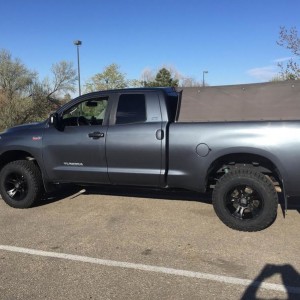

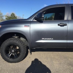

    I am going with the same Bilstein 5100's set up on my new build! I have done a TON of research on sizing on this build and my last build. Allow me to share my last build info with you and what I did and did not like about it! My prior build heavily influenced my new build specs. I am on a tight budget with the family as well.
    New Build Parts:
    -Bilstein 5100's/ max height in front 2.5 inches/ max height in rear 1"
    -Toytec Shackles for the rear at the 1" setting, here is the link: http://toyteclifts.3dcartstores.com...table-1-15-Lift-Shackles-07Tundra_p_1579.html
    -BFG Ko2's/ 285/65/R18 tires.....these came off my last truck
    -KMC 18"/ 5" Backspace/ 0 offset wheels......these cam off my last truck
    OLD BUILD PARTS:
    -TOYTEC 3/1 LEVEL KIT (BLOCKS IN FRONT AND ADD A LEAF IN THE REAR)
    HERE ARE THE PHOTOS OF MY OLD TRUCKS BUILD WITH THE 3/1 LEVEL AND WHEELS AND TIRES AND I WILL TELL YOU WHAT I DID AND DID NOT LIKE
    ::::I raised the rear approx 1"-1.5" with the add a leaf to maintain a slight rake to the overall stance because I actually use my truck to haul sometimes and don't like it when the rear is lower than the front. That being said, the add a leaf made the rear end way to stiff! It was almost like driving around with no suspension in the rear! So if you decide to raise your rear end with those Bilstein 5100's to their 1" max height in the rear go with the 1inch shackle lift from toytec! It will be better on your other parts than adding a 1" block in the rear. If you don't want any rake than leave your rear 5100's set at 0 and your fronts to max height.
    ::::I went with 285/65/R18 tires and i had very minor rubbing on my old build which required me to remove the tiny mud flap in the front with a socket(super easy). My stock tires were 275/65/R18's and bumping up just the width made a significant size difference!
    ::::My new wheels have a 0 offset which pushes them out quite a bit from the stock wheels. This was on purpose! When you raise your truck, even 2.5", you are raising your center of gravity! After I had my level kit installed I drove around with the stock wheels for a week. It was to top heavy!!!! So when you lift your truck buy those Wheel spacers you are looking at to augment your stock wheels!! My ride was MUCH more balanced and stable after my new wider wheels were installed. Look at my first picture and you'll see they only stick out about 1 1/2 inches. So if you go to a 275/70/r18 the tire will be higher in addition to your lift. Push them out a bit for a more stable platform with wheel spacers and for a slightly more aggressive look since those tires are the same width as what you already have on your truck. If you just level it and put on taller tires it will still appear more stock and is a waste of all that money on the leveling shocks and larger tires for something that looks almost the same as stock (in my opinion).
    :::: I was told to use the diff drop kit for 30$ just to be safe. It might not make that much of a difference but for that price it doesn't bother me and anything I can do to take stress off the stock system sounds like a good idea.......I hope this help! In hind sight I would have gone with a taller tire like you to fill more wheel well space.

    The pics are of your old build with the 0 offset rims? I like the way they look. I think what I'm going to do is go with the boss kit from toytec UCA shackles in the back and 295 70 18 tires on stock rims with spacers for now and then get rims later. That way I can save a grand without the rims

    Yes/ The pics are of my old build with the 0 offset rims! Good call on tire size/ those are what I'd like when these tires wear down. Please post pics of your ride when you are done with it! I'd love to see that tire size on a Tundra man! Cheers!!
