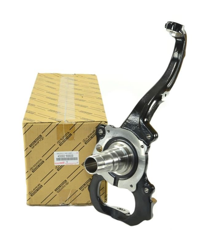

    Wasnt there a 555 ?sankei? Lbj that was supposed to be adequate?
    okay, nvm. They seem to be popular with landcruiser guys, but their knuckle has the lbj in compression.
