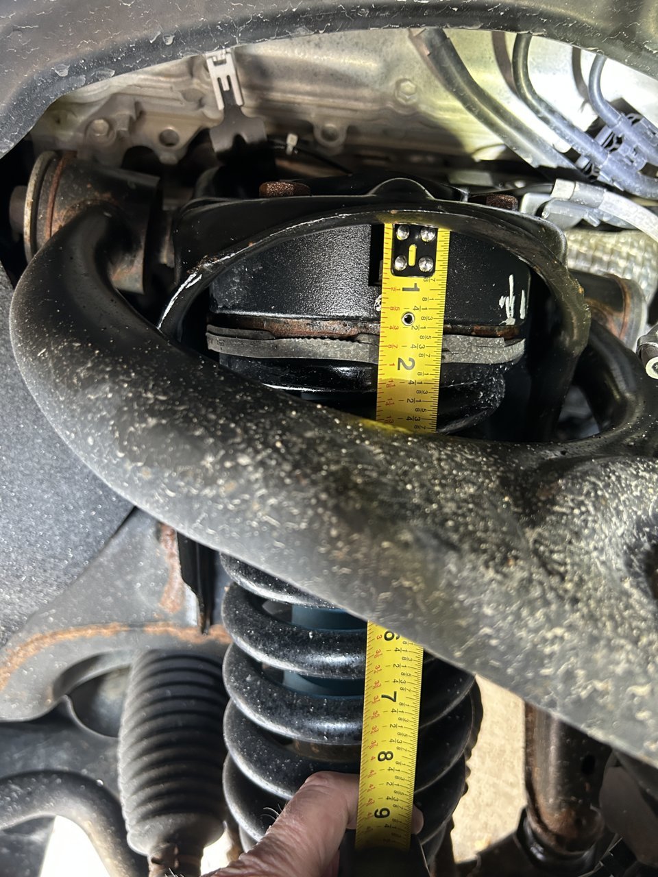

    Right now I have spacers on my 2013 CrewMax Off Road and have 5100 Adjustables and Coachbuilder 1/4” spacers on order.
    I’m trying to decide on a setting for the front shocks with my stock springs.
    The truck’s current stance is fine so keeping the front height close to what it is now is what I’m shooting for.
    This is the spacer I have. It measures 1.5” thick so what is my actual lift?
    Plus, I don’t understand the rubber pieces I see under the spacers. I don’t recall seeing them on other ppls struts.
    Any suggestion on the setting I should chose on the 5100s to get a comparable lift? Middle setting or highest?
    I’ll have the shims to fine tune the lift if I need to.
    Thanks in advance for any suggestions.

    The easiest way to answer this question is to get your hub to fender measurement. Measure directly up and down the distance between your wheel well opening and the center of your wheel on both the driver's and passenger's side. We know the stock hub to fender of your truck so that will let us know how far from stock you currently are. It'll be easy to figure out where to set the new shocks from there. As for the rubber thing that is called an isolator. That is a common piece, and should be there so that's good.

    Thanks memario1214.
    I measure 23 1/4" both L and R front and 23 3/4" on the rears.
