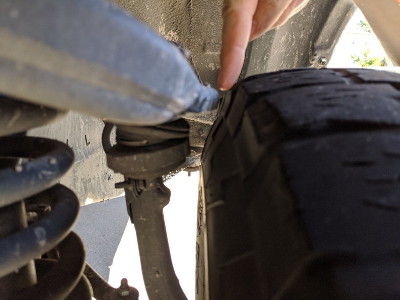

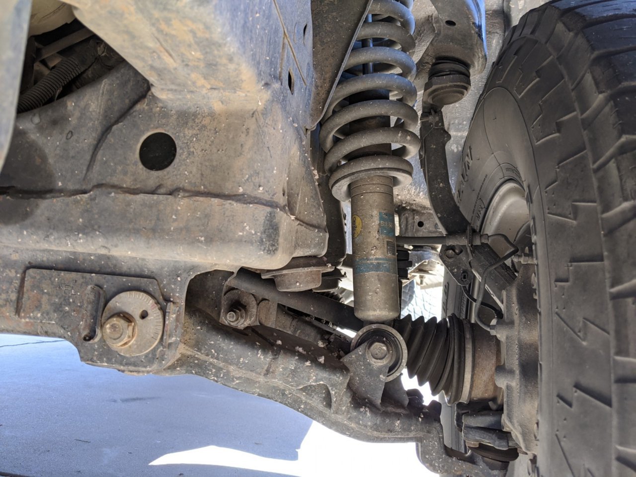

    I just joined this forum to ask research this very issue.:thumbsup: At first I was on the side of "the higher the 5100 clip setting the more compressed the coil", but after some thought and then confirmation here, I have flip-flopped to "the coil isn't any more compressed than it was when it rolled off the production floor" side.
    BUT...
    I too have a 1 gen tundra with 5100's on the top clip setting. (I bought it this way and have slowly been discovering the mods and their effects.) Let me say that the top clip is very rough, especially on the rebound. It handles whoopy hills and such just fine, but when I hit the smallest change in the asphalt (transition from dirt to asphalt - 1" lip) or wash-boarding along a dirt road, it feels like I hit a row of cinder blocks.
    IMO I think the highest clip setting is rough/stiffer, because it changes the a-arm angle.
    example: IF the a-arms were perpendicular to the wheel (parallel to the ground) when the truck was at rest, there would only be resistance/support from the coil during a sudden change in elevation. BUT if the the a-arms were at a 45 degree angle (sloping down towards the wheel), some of the impact energy would be transitioned into the a-arms and into the frame; resulting in a "stiffer" ride. The bump would be felt more, because of the energy being transferred through the frame.
    I could be dead wrong, and would love to know what your thoughts are. I am here to learn and get me truck to a happier/smoother place.
    I am currently on a quest to return it to stock, because I'd rather have it ride nice than have a "large" tire. If there's a way to fix the ride without dropping tons of money, I'm all ears.
    Other than a rough ride, look how close that upper arm is to the tire.
