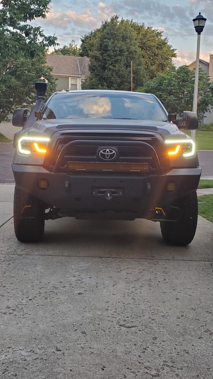

    Beautiful Rig... Looks a lot like my vision for the 2012 crewmax I just bought... A few questions... Did you have to mod the snorkel at all to get it to fit? I'm coming from a LC and I'm sold on the Safari Snorkel, that would be awesome if it could be made to fit. When you swapped in the Sequioa headlights, was that just a straight replacement or did you have to make modifications? What is that hood protector? Mine has the clear OEM film, and it looks like crap...

    Great minds think alike...Safari snorkel was for the 200 series Land Cruiser. Only thing is that it will eliminate you radio antenna so install and rerout if necessary.
    Sequoia LEDs were plug and play. You need the harness from xrunnerdude67.
    Hood protecter is one that I got from Cabelas...
    Good luck on your mods! Let me know if you need anything else.
