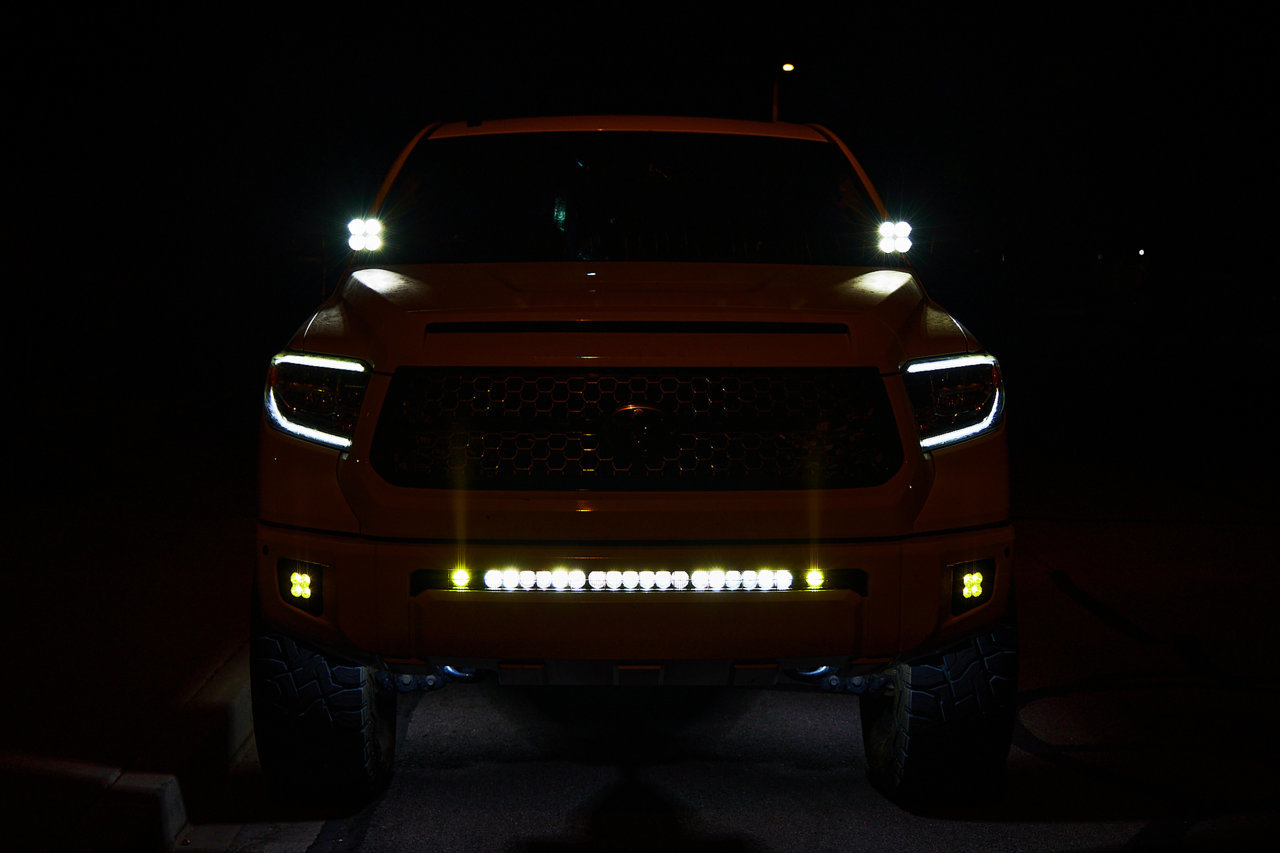

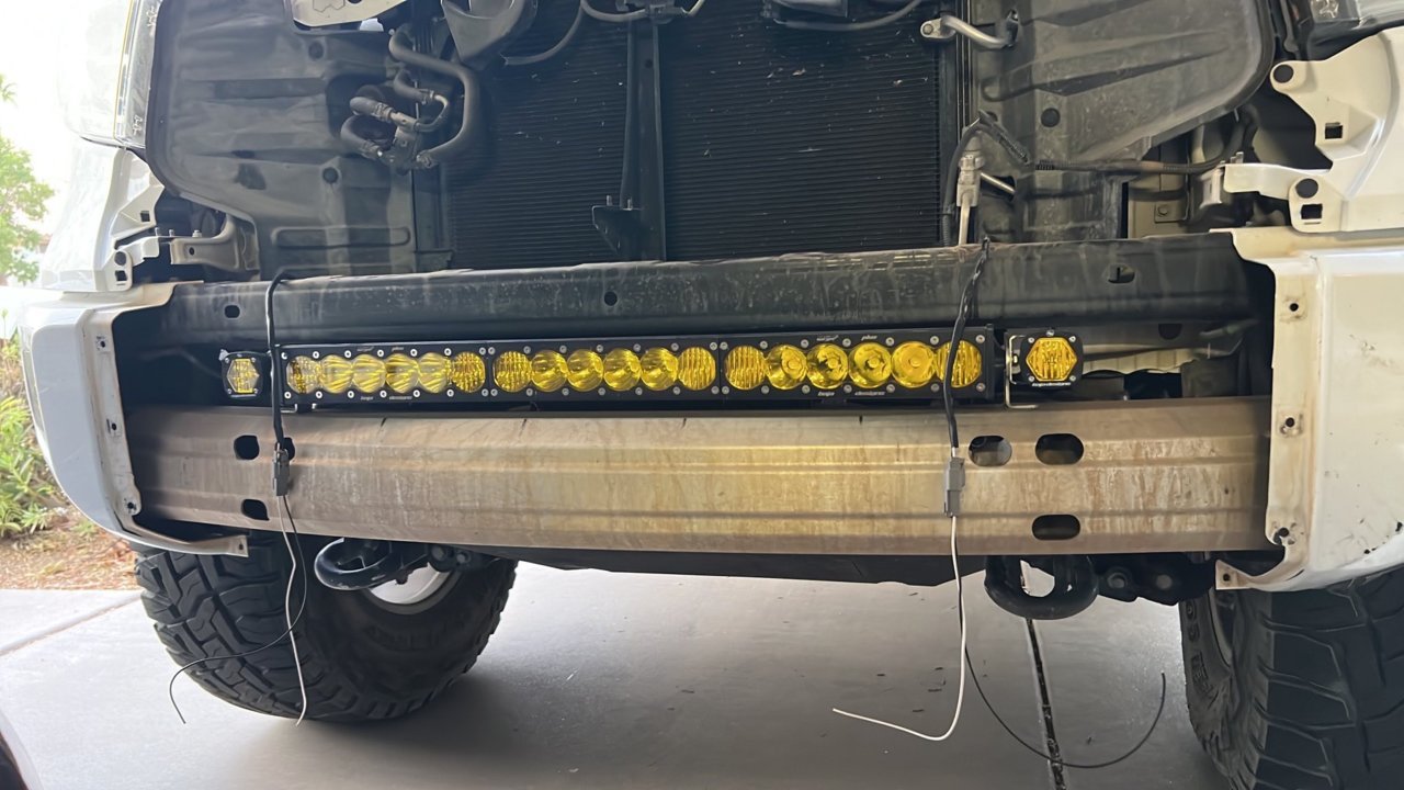

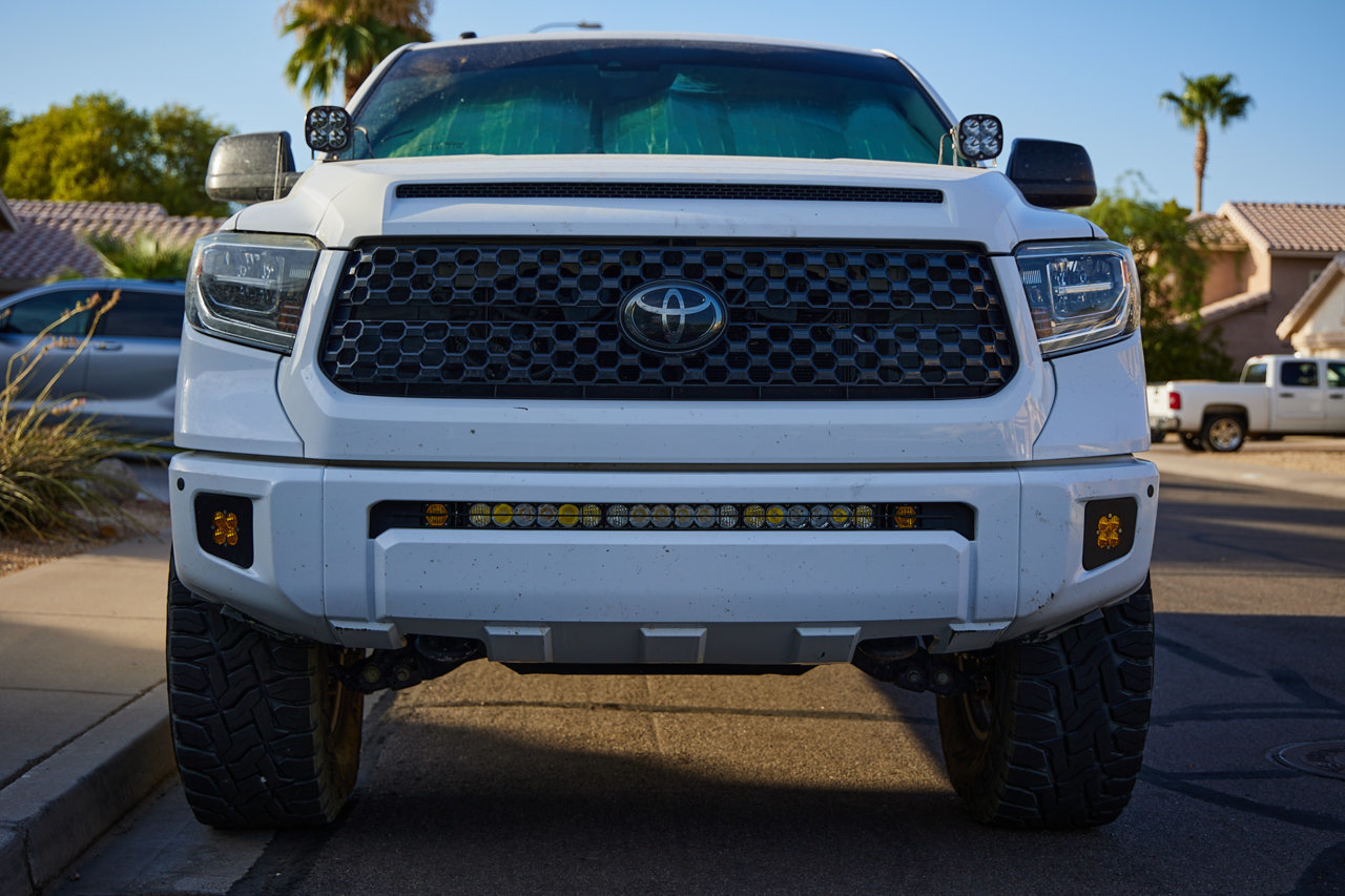

    Forward facing lighting refactor:
    After destroying my 3rd set of OEM fog bezels, I decided to transfer the Baja Designs Squadron Sports to @Bannock452 's fog lamp plates which is a far more solid of a mounting solution, even on plastic end caps.
    Downside is they're not longer operating as a forward facing "fog" lamp and more of a cornering lamp...this is by design.
    So in attempts to mitigate this, I chose to borrow my a pillar mounted S1s, bolt them to the sides my 30" onx6 stealth, tie them into the same circuit as the "fogs" and trim lower grille to fit.
    Before:
    During:
    After:
    Which yielded a much better near field lighting pattern...
    Day:
    Night (heavily filtered to capture the "look"):
