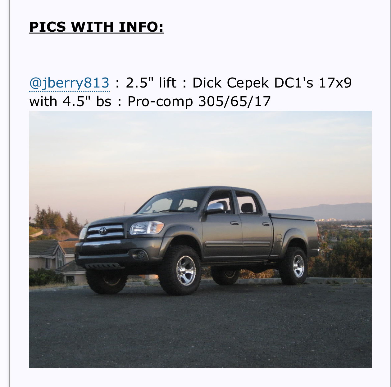

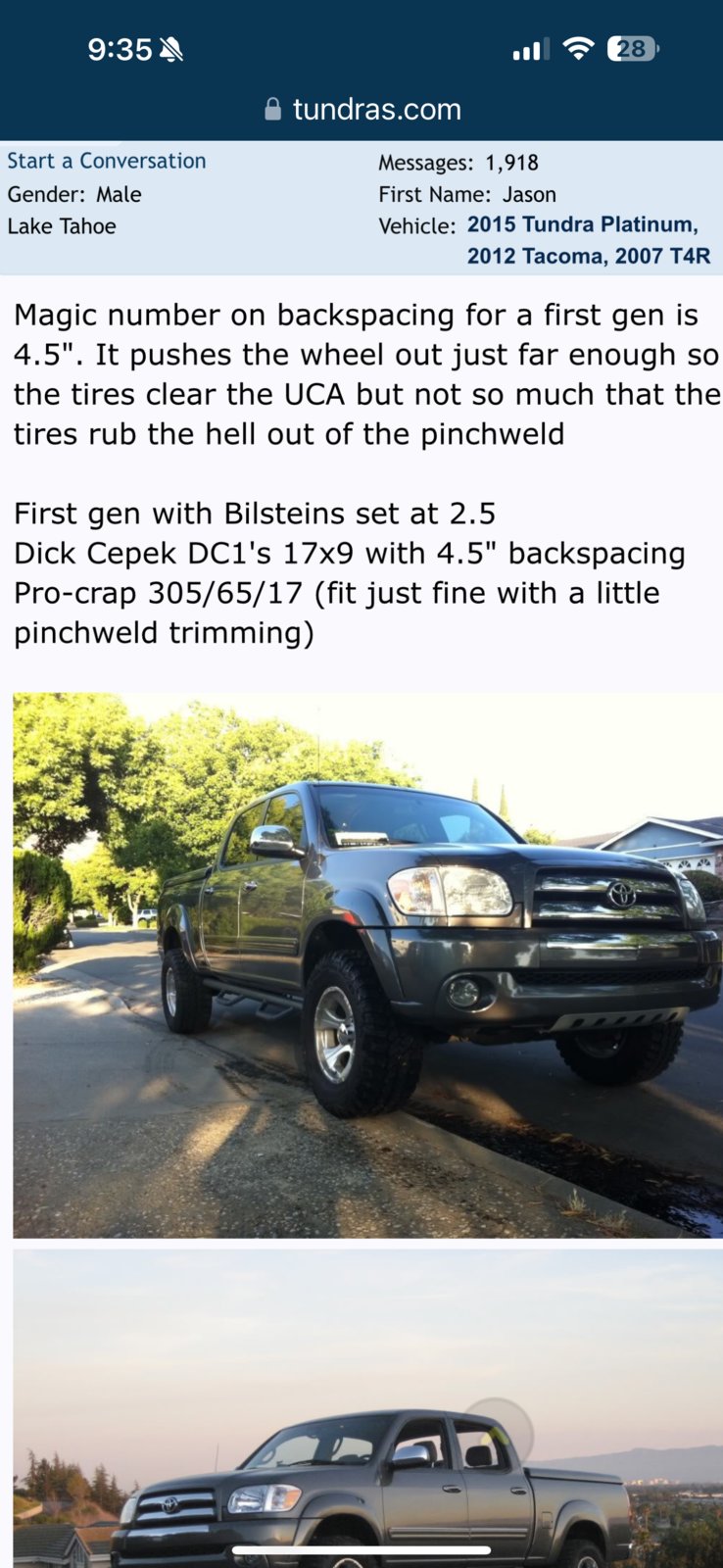

    Bilstein 5100's with 2883's - close to 2" Replacing the 2883's and going back to the bottom perch ASAP -mobile/apple play stereo with sub and backup cam -Power stop HD front calipers and rotors for towing -20" wheels with 32" tires (305/50's) Toyo AT 3's with no rubbing -Westin nerf bars -Detroit axle new (not rebuilt) steering rack with poly bushings, inner and outer TRE's -Suspension Maxx extended front sway bar links -Overland tuning - medium level -Power front leather seats and steering wheel from 06 Sequoia -fully de-chromed/blacked out trim -all light housings incl 3rd brake light and tag lights replaced with smoked lenses, LED where appropriate -mini projector headlights -fully rebuilt trans and new torque converter -new complete drive shaft with spicer u-joints and carrier bearing -all LED interior lights including backlighting -new lower window seals for all 4 doors -all new hardware and clips for tailgate Next: Dirty Deeds racing exhaust with LT headers, yellow box, 12 hole DD fuel injectors, redo or replace door panels
    sorry if this has already been posted, but post number one in this thread has good information, most of which is already ITT, but if you look at the first example on down in the very first post @jberry813 said he was able to install 305s successfully with a leveling kit and pinch weld mods with no rubbing or scrubbing at a -12 offset. This is also on a 2006 tundra double cab, same as yours if I'm not mistaken (I went ahead and added screenshots of his OP about his setup). As shifty said elsewhere, his 4.5 backspacing is based on 17 x 9" wheels. If you change the wheel width, then that backspacing is no longer valid.
    he went with 305 65s on 17 inch wheels so thats about 1.2" smaller diameter tire than what you were suggesting. His are 32.6" tall. Your 305/70/17's would be 33.8". 1.2" taller would definitely cause more problems
    I really like his set up because it has the beefier tires that you and I both appear to like, but without the crazy, negative offset sticking way outside of the fender. I believe it is as close inside/the most minimal negative offset you can get away with
    https://www.tundras.com/threads/official-tundra-wheel-and-tire-setups-pics-and-info.95/
    I recently did some testing on this and can confirm the -12 offset should clear everything on the inside. But I'm only going with 32" tall 305's. I'll be interested to see if the part about only pinch weld mods is true for me

    I believe the magic # of 4.5 is directly dependent on wheel and tire width. I’ve noticed (w/ other builds) that go with 33+ inch tires that going with a more negative offset (or less backspacing) yields the best results.
  20. Feb 29, 2024 at 3:02 PM
    #50
    Weagle
    Weagle I survived my timing belt change
    Sep 24, 2023
    #104402
    1,072
    Prattville, AL
    2006 Tundra SR5 DC 4.7 2WD LSD towing pkg
    I don't disagree. That magic number absolutely changes if you go to a different width of wheel
    he didn't say it that way, but from my experimenting with something similar, his magic # was very specific to his exact set up.
