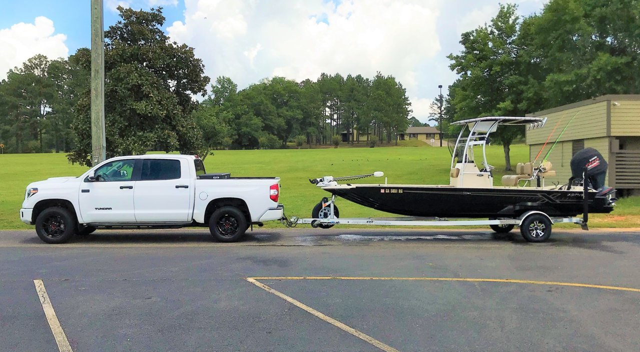

    Bad Cow
    Bad Cow GOD Bless The USA
    Jan 17, 2020
    #41355
    613
    Georgia USA
    2019 TRD PRO - SUPER WHITE
    Leather Steering Wheel, +1.5" Shackles
    + 1.5" Shackles, perfection achieved.

  14. Jul 4, 2020 at 4:06 AM
    #44
    Bad Cow
    Jan 17, 2020
    #41355
    613
    Georgia USA
    My truck drives and rides as smooth now as it did with the factory shackles. No vibes, no harsh ride, nothing. I can't tell any difference in ride quality at all. I'm very pleased to now have some RAKE to the truck, rather than it sitting so flat and level.
    BEFORE:
    AFTER:
