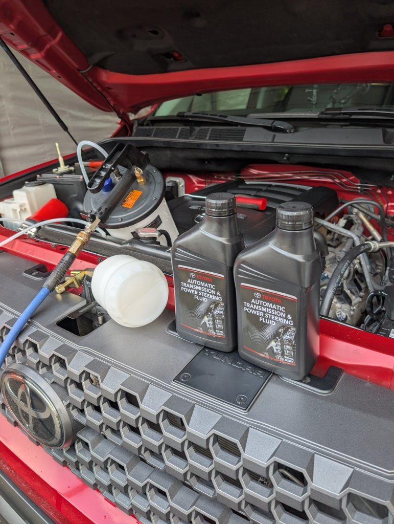

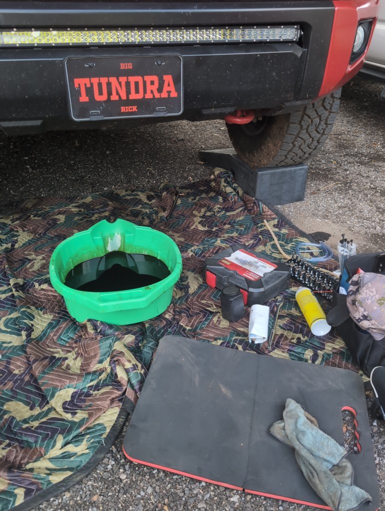

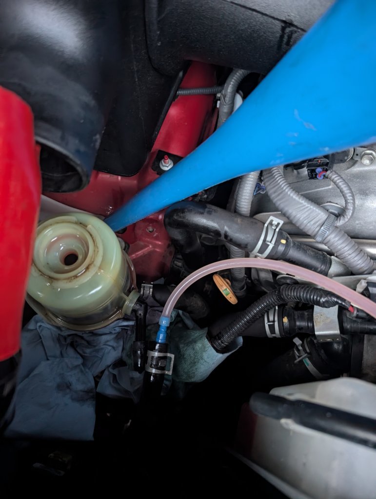

    Power steering flush
    Tools and supplies
    Toyota Transmission and PS fluid/ 2 qts
    Hose pliers
    Vacuum pump with fittings
    Plenty of paper towels or rags
    Air compressor to run pump

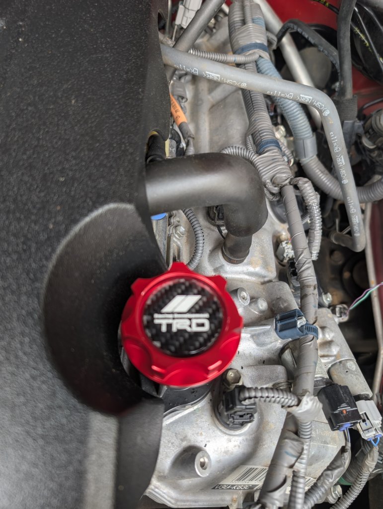

    Replaced oil filler cap with a nice looking billet aluminum off eBay PXL_20250516_184721608.jpg

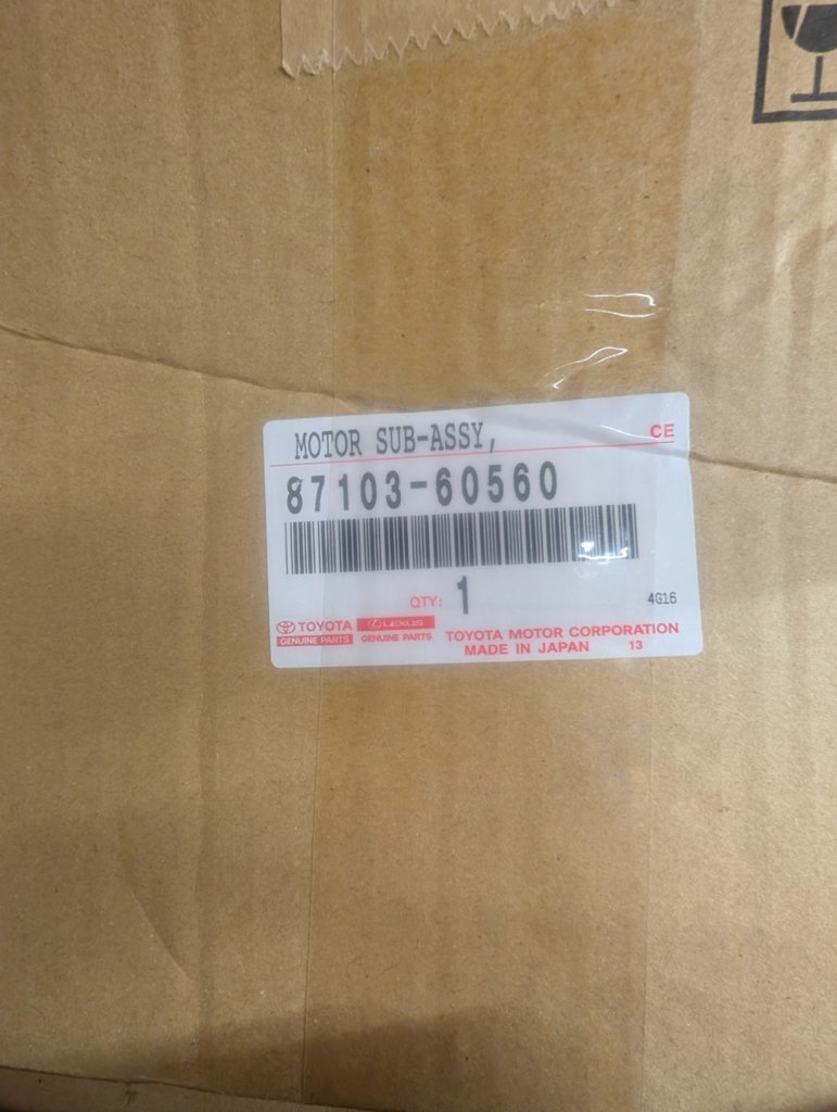

    Blower motor part #
    PXL_20250518_113619683.MP.jpgand the Dasaita Android 13 256GB with T-Mobile digits only SIM is awesome so far with about a year under my belt.

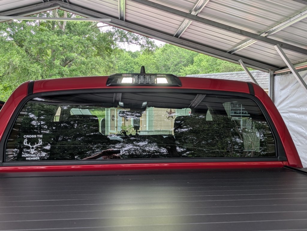

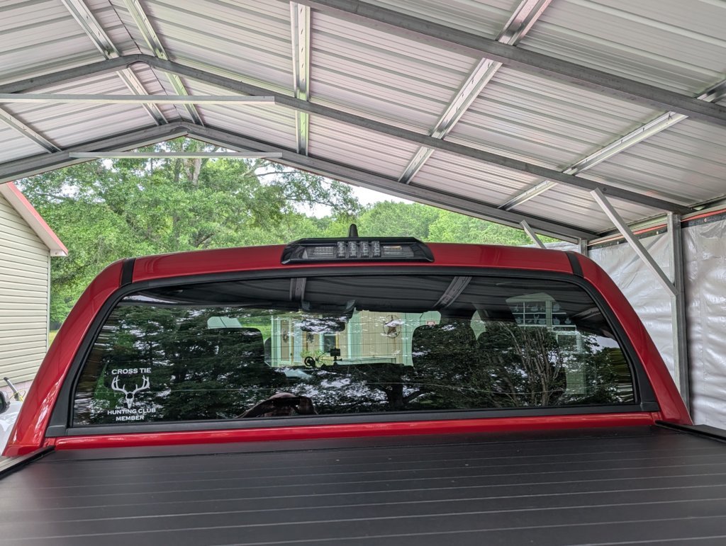

    Morimoto 3rd brake light installed and it was a PITAPXL_20250511_202936260.jpg PXL_20250511_203021244.jpg

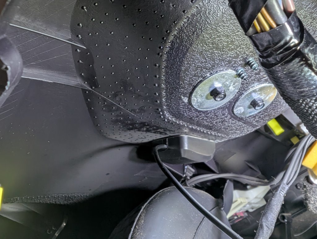

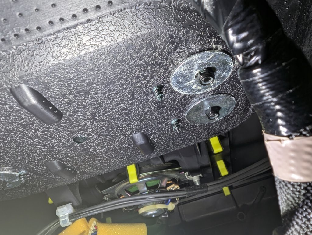

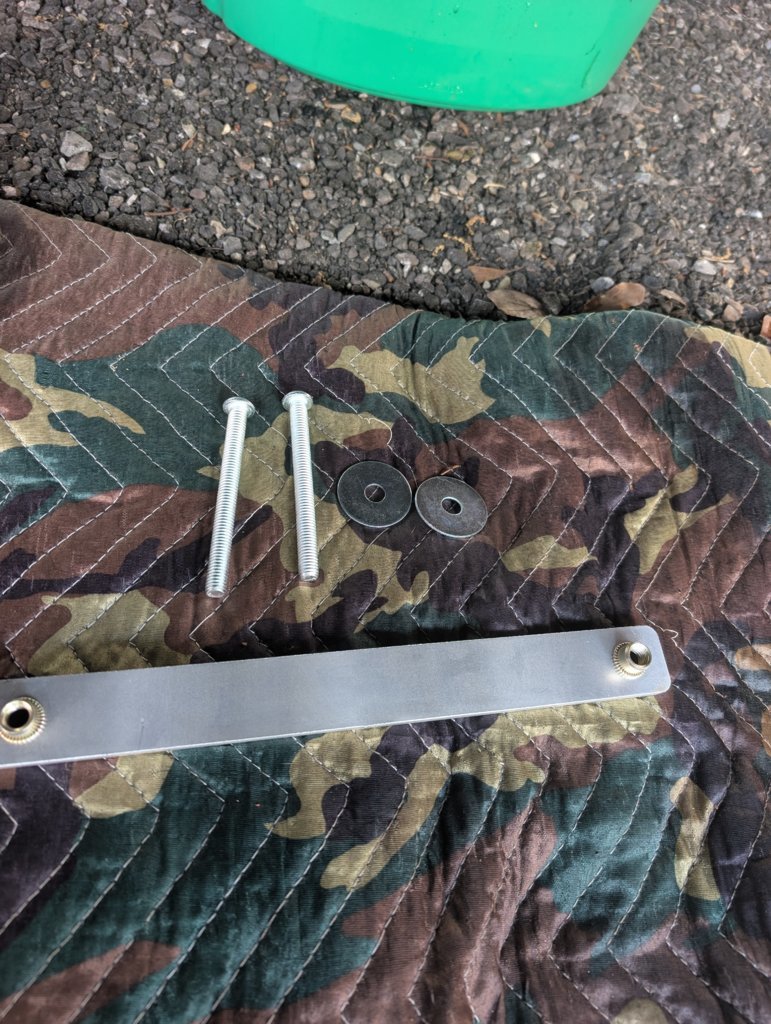

    Pics of bullet point install
    PXL_20250202_022930417.NIGHT.jpg PXL_20250202_022952829.NIGHT.jpg PXL_20250202_025148723.jpg

    Had to remove the head unit again for the bullet point install.You have to drill 4 small mounting holes and a larger hole for the USB wire to pass thru the dash down to a 12v connection that will have to be tapped for power.I also used some fender washers on the underside for stability.I have a magsafe phone holder and my camera mounted with no problem .Since the install I ordered a rubber mat that I cutout to go around the rest of that area that the mount leaves uncovered.I didn't like that look
