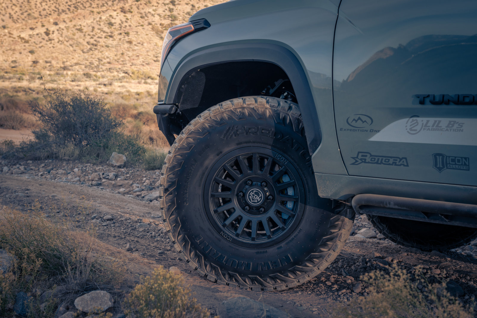

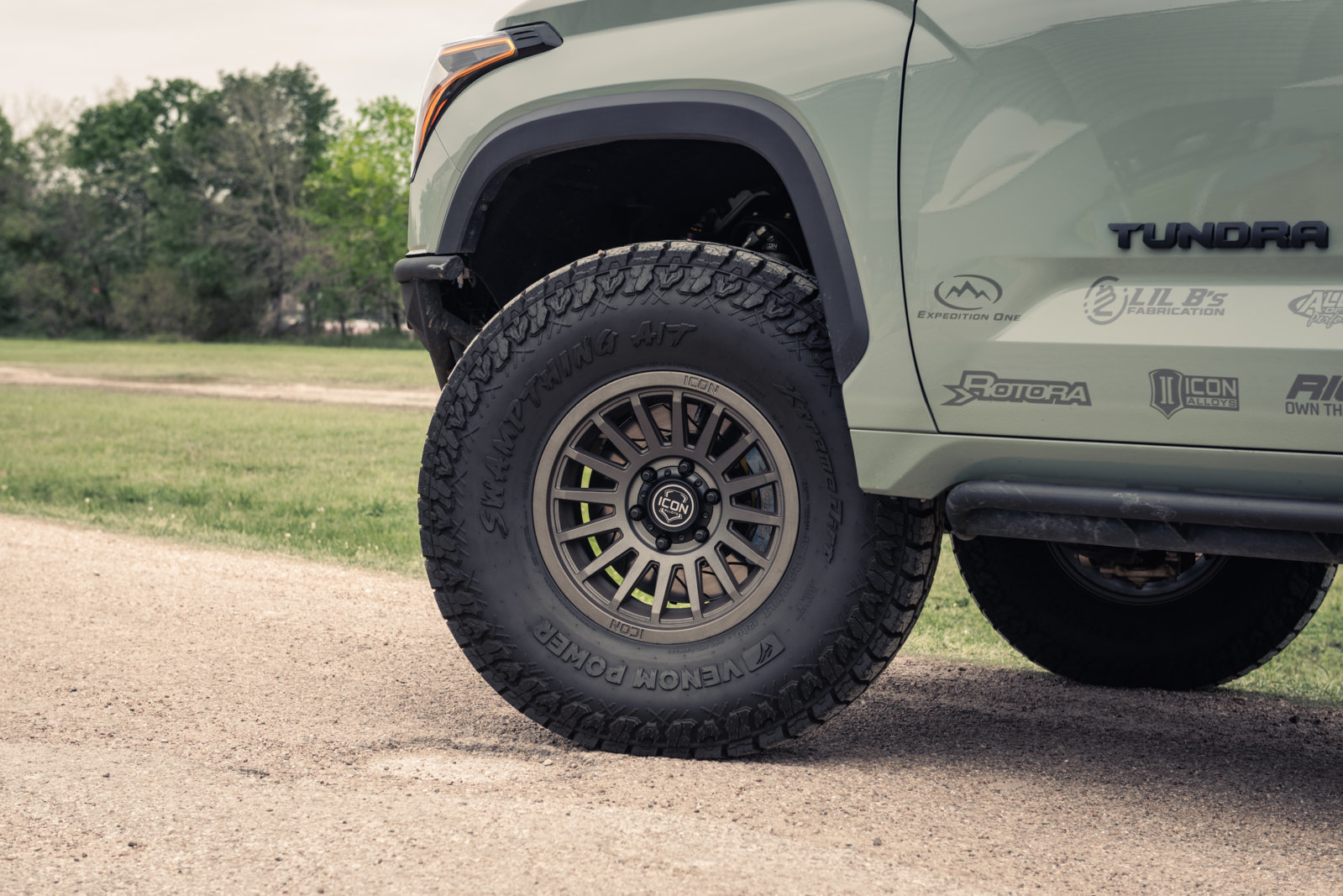

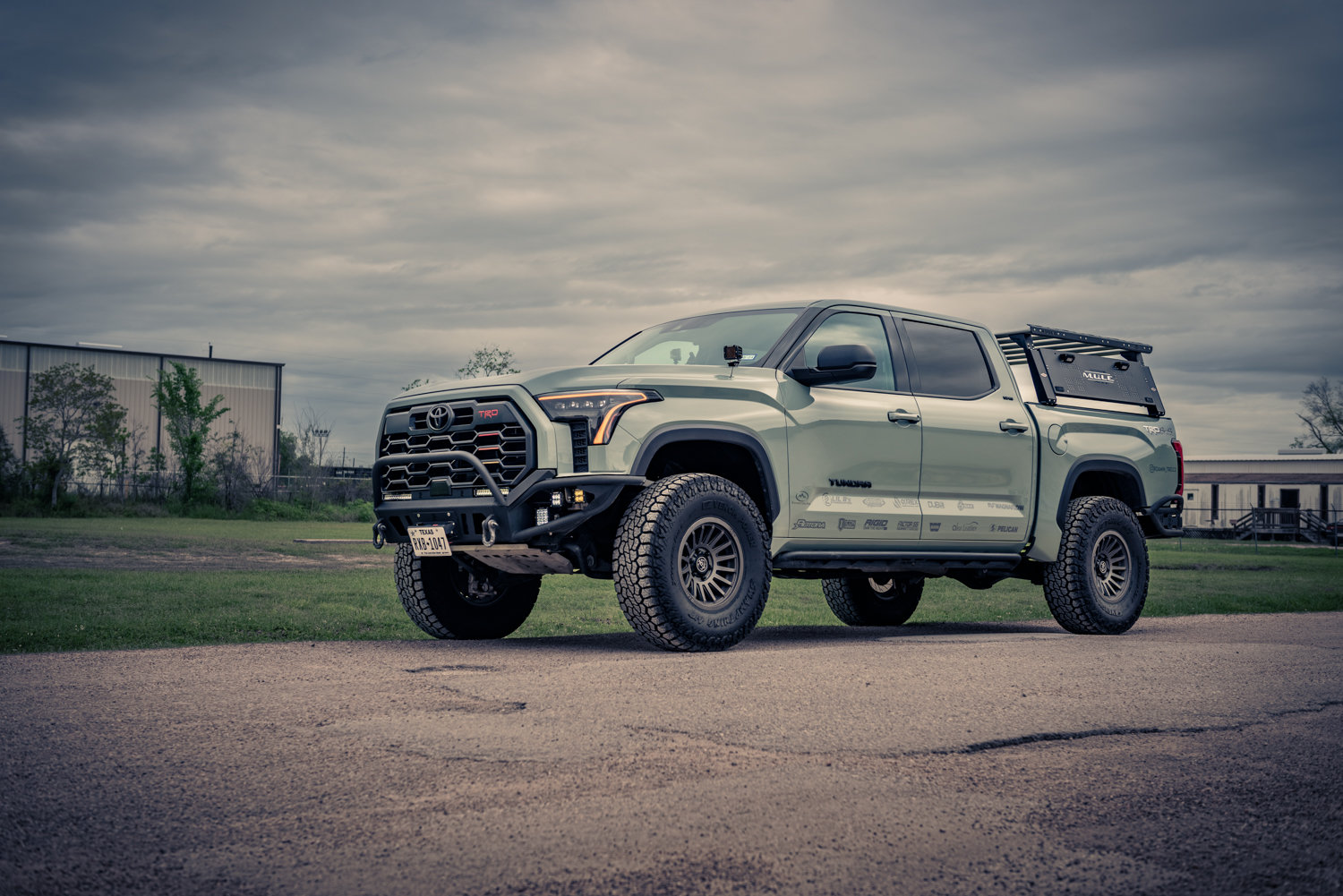

    I have a set of the Rotora brakes on mine (6-piston front / 4-piston rear). I've had mine since October and so far so good. Massive difference in braking performance over stock.
    jnasty[OP], kirkb, wxman91 and 2 others like this.

    Wow it fit a 17 inch! Good to know! Thanks!

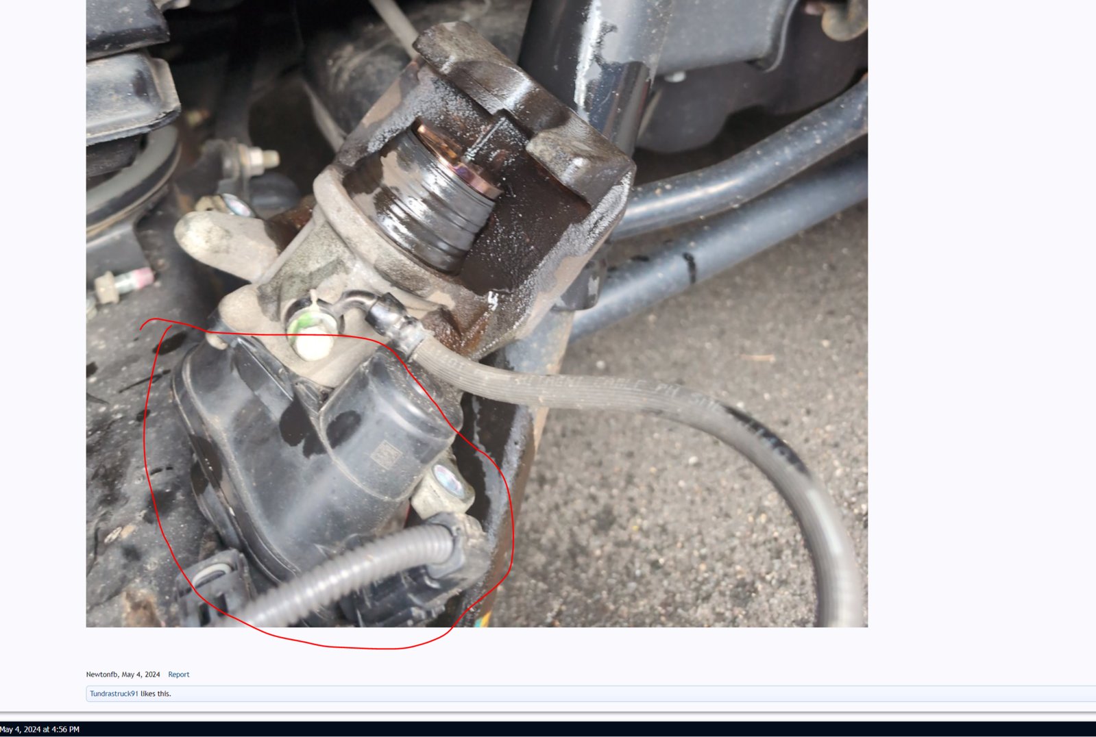

    Thanks for the reply, so you're saying the Rotora 4-piston caliper in the rear has a provision to accept the the electronic actuator that applies the electronic e-brake then? Curious to know if it applies two pistons or just one. Or if it applies all 4. I thought the actuator is mechanical and pushed the one piston out rather than through brake pressure. This is also why I would assume most big brake manufactures are staying away from the rears because they would have to work with the Toyota actuator or have their own. If Rotora has that figured out I agree with Ryan they are actually pretty competitively priced compared to others on the market.

    yes, standard EPB uses a ballscrew mechanism, this photo shows it looks like it uses a similar set up,
    https://hpbuilt.shop/products/rotor...ston-rear-electronic-parking-brake-compatible
    Wilwood and others have also done this for a while, some like the EPB to be a standalone caliper, it reduce the complexity.
    Then I've also seen these integrated ones.
