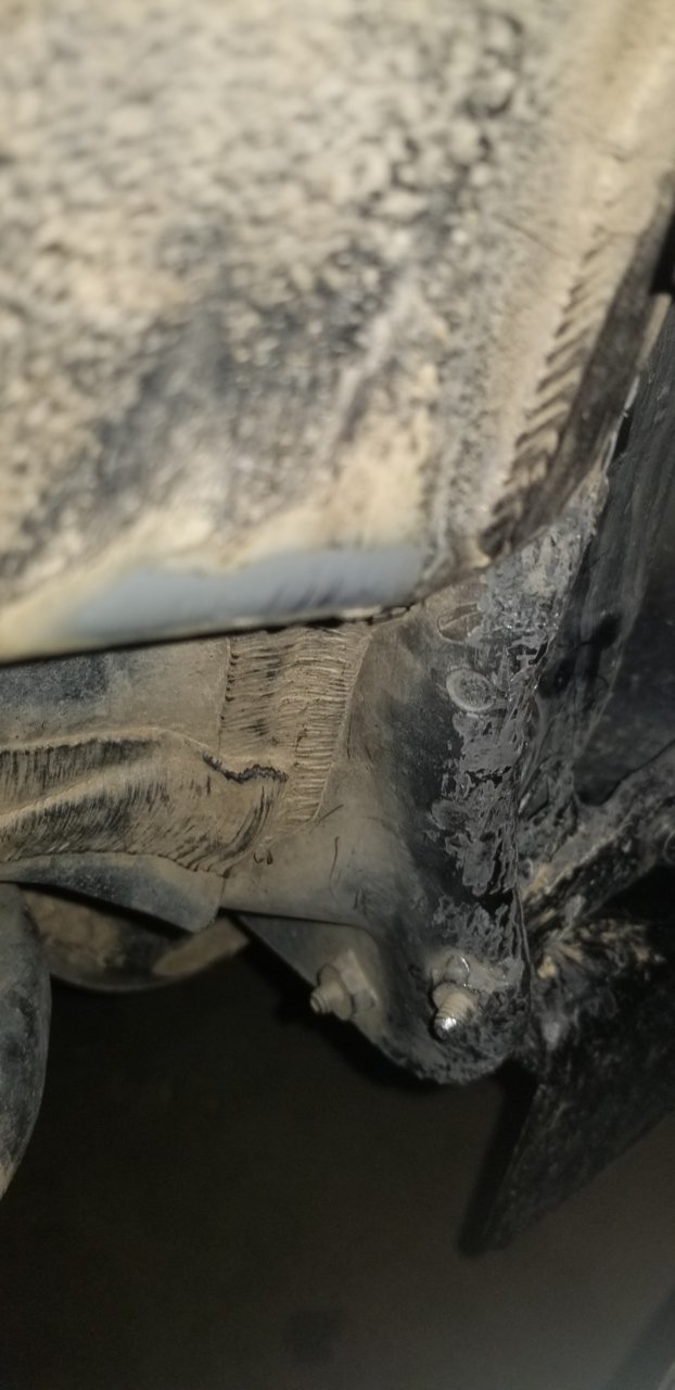

    A little update since T2S…as you have all guessed, 35’s don’t fit unless you have a 6” lift or a tubbed firewall. If you say otherwise, you’re full of shit and I want what you’re smoking!
    7BCCD8AC-EADA-42B5-985E-A24935A15DE5.jpg After 17 hours of suspension install and alignment, my dumbass forgot to attach the brake line bracket back to the spindle. After 800+ highway miles, 7 miles on dirt and two big washouts, the hardline snapped at the caliper fitting. Thankfully it happened on a flat forest road while I was with @des2mtn.
    We were able to safely limp it to a camp spot for the night with no brakes. Spent an entire day trying hardlines from Oriellys and even a new oem line from Toyota of Flagstaff with nothing but brake fluid down both of our arms.
    The only fitting that would fit in the caliper was the one from the snapped line and no shop would reflare the line without the truck there!! So, Judy got her first flatbed ride of her life with me. Sad day to say the least!
    After wasting a night in a hotel room she was fixed and ready to finally get to T2S. It was awesome meeting @FrenchToasty and his fam! Thanks to Mo and Brent, the mod fund has to grow larger for rear discs and a CO rear bumper!
    Judy wasn’t close to being 100% and I was hesitant to wheel her like I’m used to with the old 34’s. I’ve got a lot more work to do but I will make these 35’s fit! There’s no going back to 285/75’s after seeing these yokos on there! Here are a few pics from the trip:
    EEADCF23-5703-4320-BA50-FBD5196CC387.jpg 862ED500-4132-4069-844B-76FCEA147848.jpg
    Sorry @des2mtn
    A9320713-6C71-4EDC-9F8E-E8746FE41597.jpg E57E6408-CAD0-47CD-BBB3-1CF35360516A.jpg 6A082CE3-B418-473B-95AE-20C03A579D61.jpg 75F8DBE9-A0BC-4B27-9C38-188AC322D0D2.jpg 115C4C20-3944-413A-A2AE-B9E9FB8AFBD1.jpg
