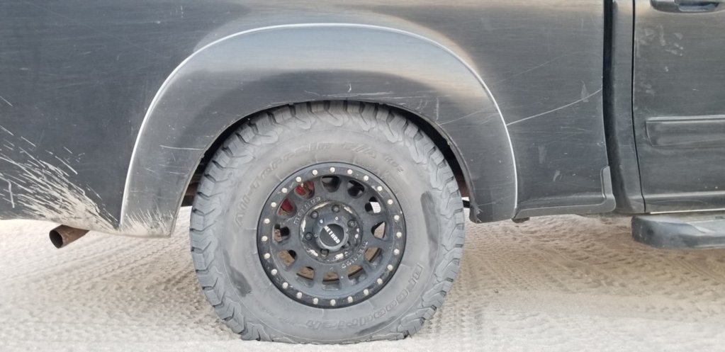

    I've ran exclusively e-rated tires and I'm usually able to get decent flotation and traction, I've gone as low as 15psi. I do a lot of desert/dune driving that requires the flotation and I definitely notice a difference versus when aired up to 40 PSI.
