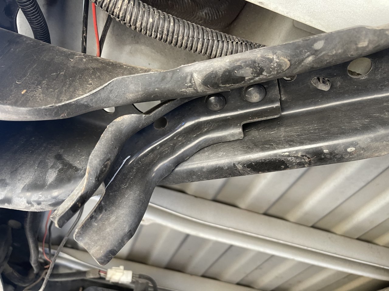

    I just paid a local mechanic $40 to air hammer them out. They did a really good job, and I just put some black spray paint on the small area of bare metal to prevent rust.They used a reciprocating saw on the back of the rivets then air hammered the brackets out.

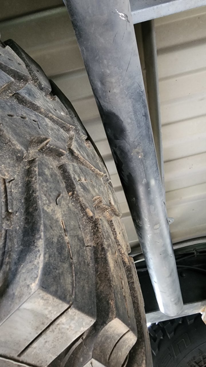

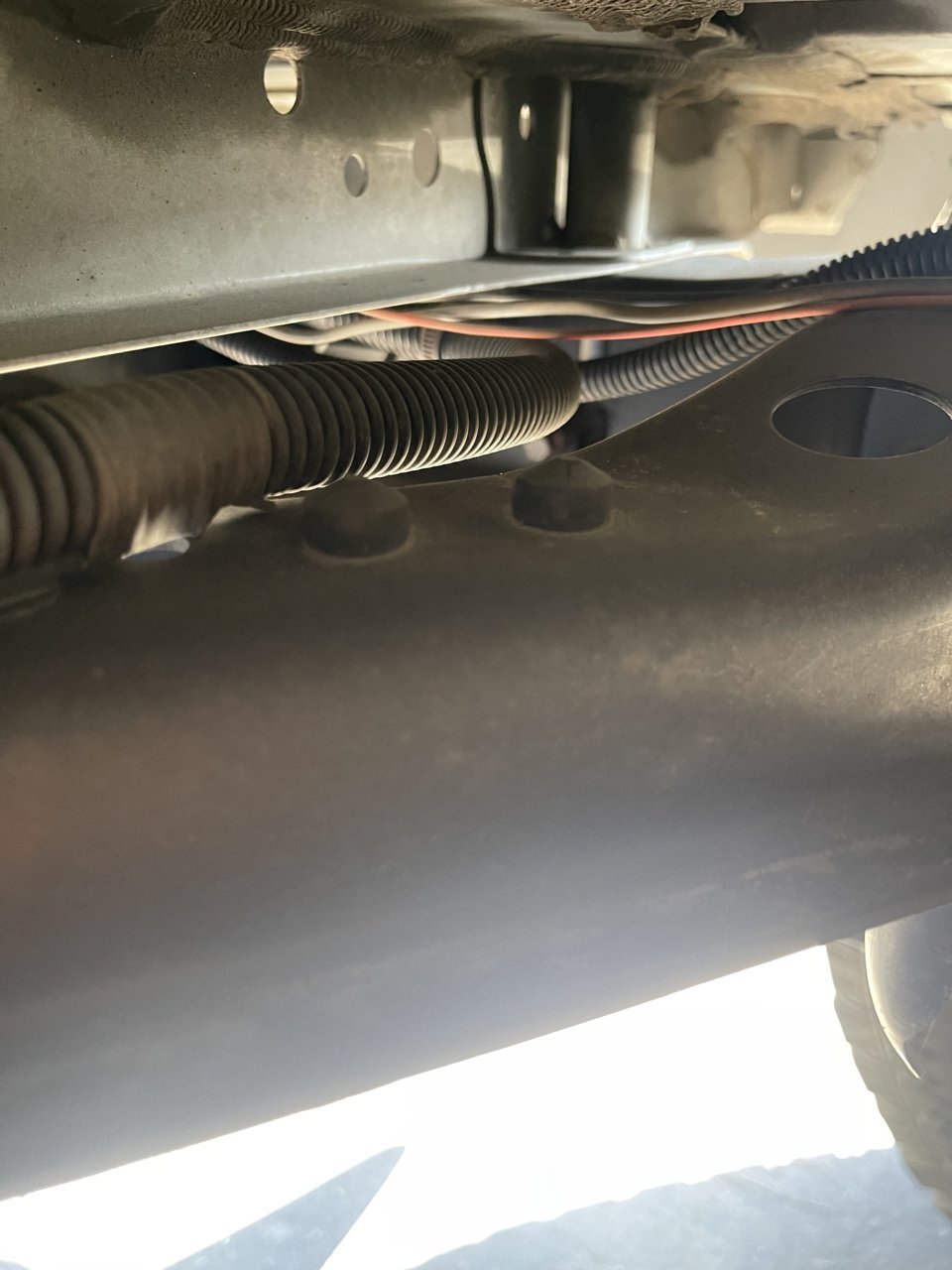

    Just an update. I found a used 285/70/18 tire on Facebook for $40, got it mounted and balanced for $42 at Discount Tire. Went to raise it into place under the truck and it fits between the coachbuilder shackles, but it is hitting the rear bumper and resonator from DirtyDeeds.
    I'm supposed to drive 350 miles this weekend. Is it okay for the spare to rub against the resonator? Any thoughts on a quick solution to get through this trip? Should I buy heat wrap at AdvanceAuto and wrap the resonator? Try to adjust it?
    Thank you for everyone's advice and help so far on my spare tire questions!

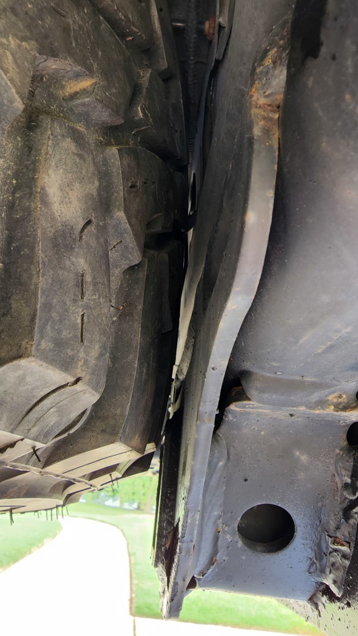

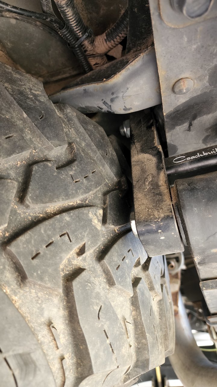

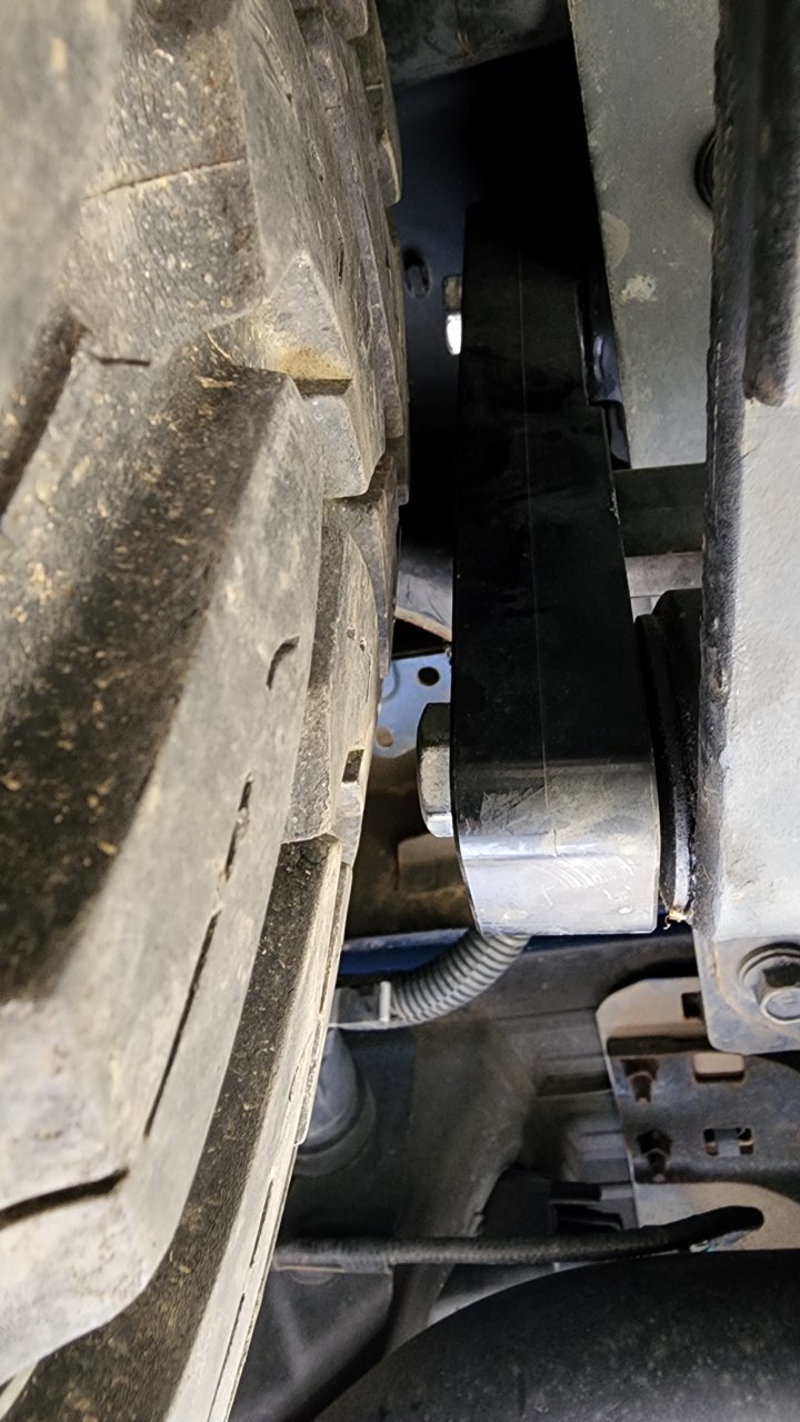

    Thank you for everyone's feedback. I unbolted the DD resonator and shifted it a little forward and up to make space for the tire. Plenty of clearance now.
    285/70/18 used Toyo Open Country spare on stock rim
    +2 Coachbuilders shackles
    DD resonator
    Removed the tire guides so I guided the tire in place manually as a friend cranked it up.
    Passenger side- There is less than 1" of clearance from shackle to tire
    Driver's side shackle
    Resonator
    Rear bumper

    I just cut the tabs from the bottom flush with the mounts. Took me 10 seconds on each side. Now I have a 35x12.50 up there.

    I saw some of these posts talk about a reciprocating saw and assumed you could get between the rivet head and the beam it’s mounted to. Are those who cut it off just cutting through the entire rivet head?

    I joined to see what is possible
    your very last photo, the top side rivet heads. get a reciprocating saw, put it flat against the frame and saw it off flush as possible. then hammer away at the brackets. pops off very quickly. i think i got all tabs off in 30 mins or less. i think this is hands down the easiest method and its clean. obviously dont saw your line in the way.
