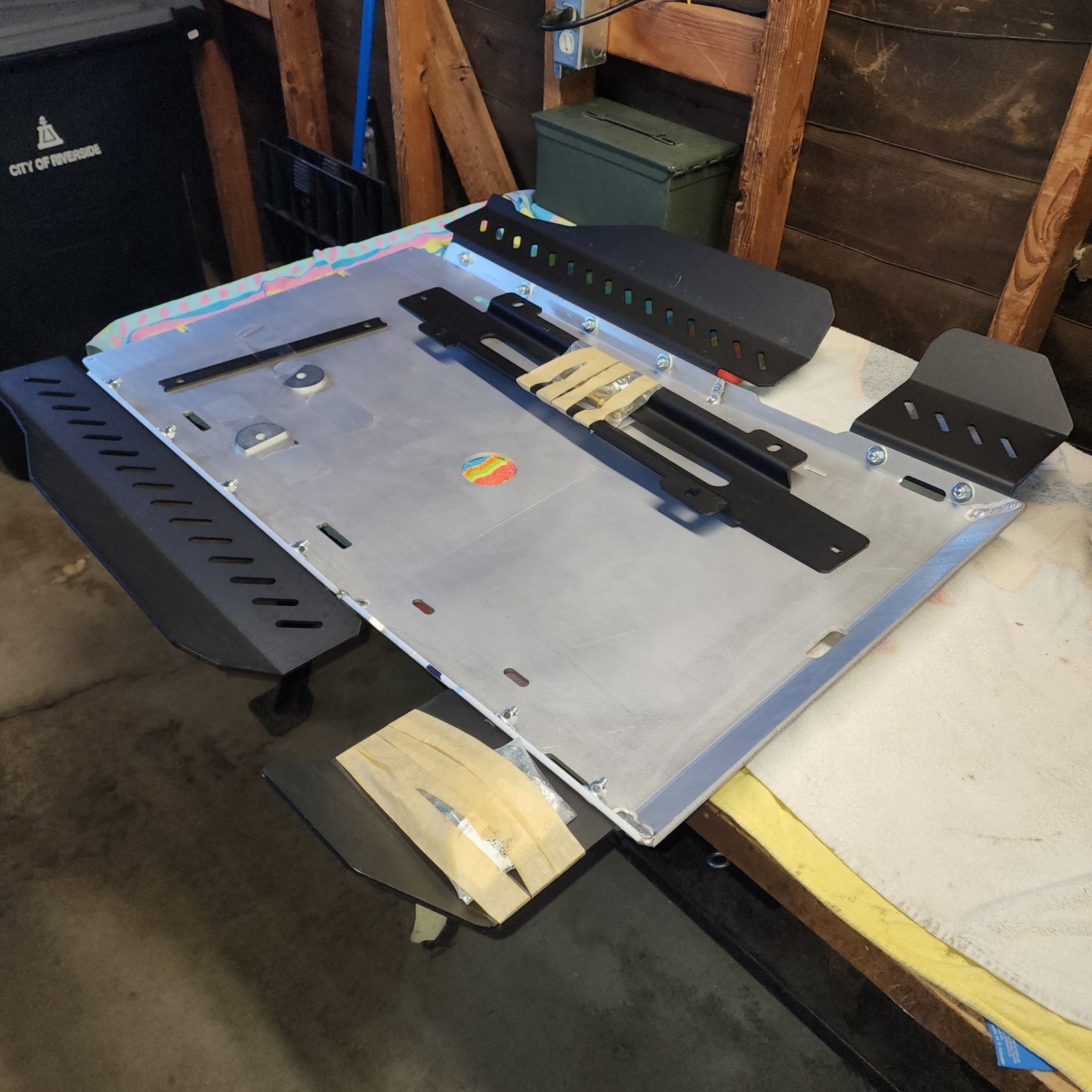

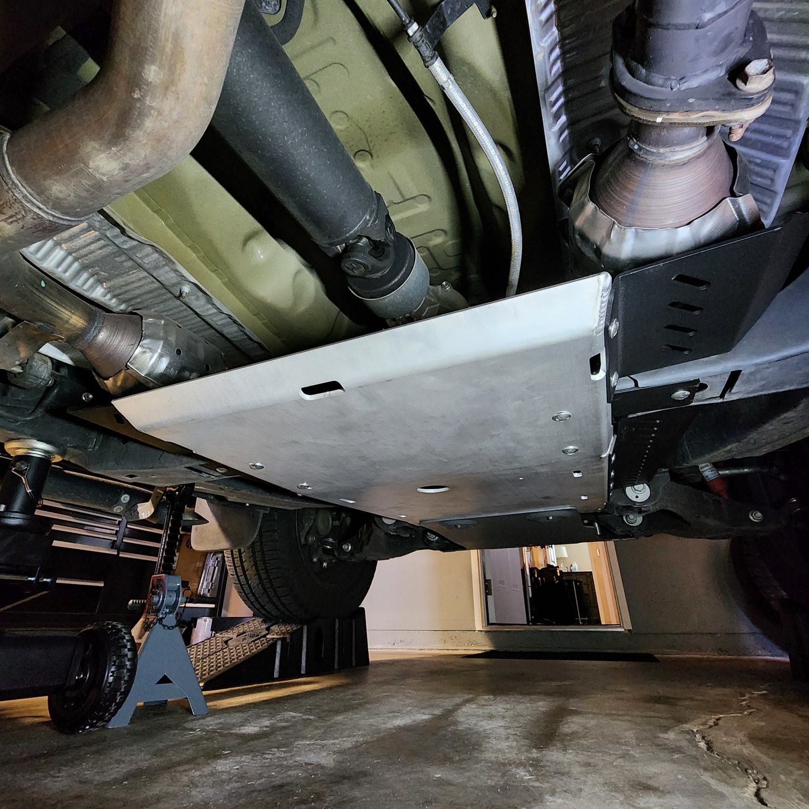

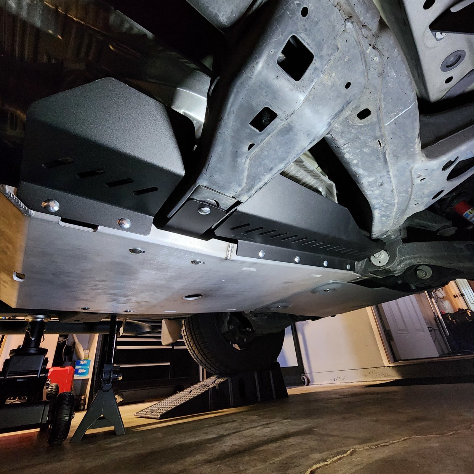

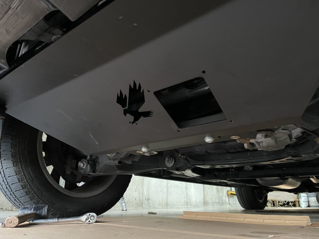

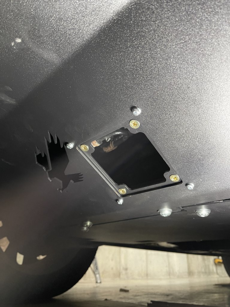

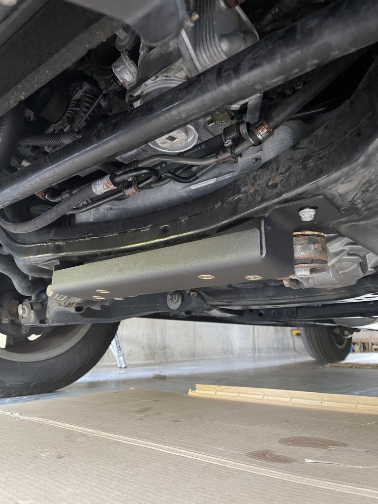

    Here's mine... 2wd CrewMax

    Alot of them
    Nice floor jack. I have 2 of them :thumbsup:

    Yeah, that thing is a beast!:muscleflexing:

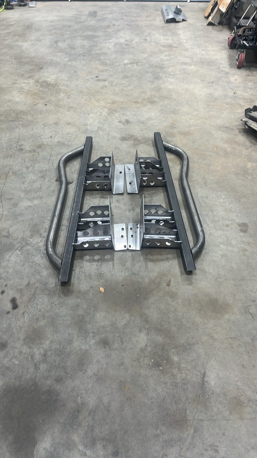

    I need to look at how they mount, but I think our transfer case bracket might interfere.
    we are working on our own rock sliders that will work with our skids, but not sure when we will have a release.

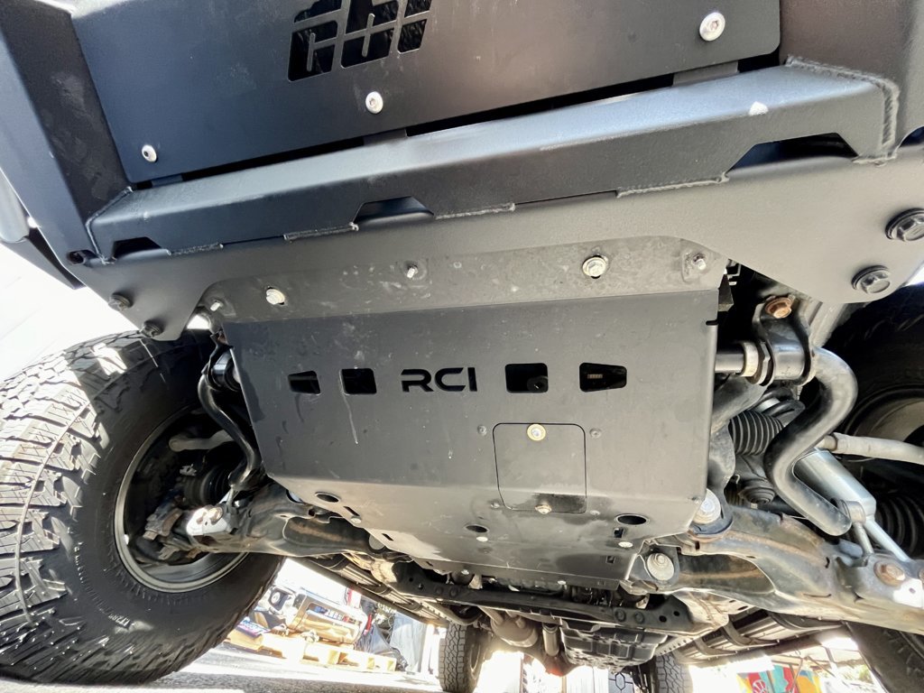

    I like my RCI!

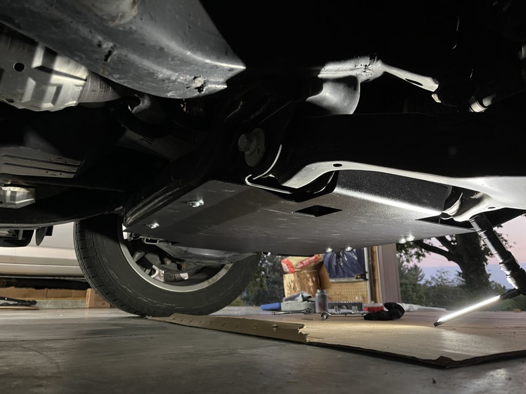

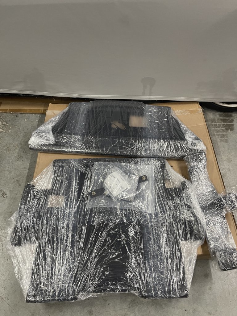

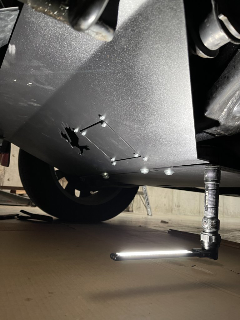

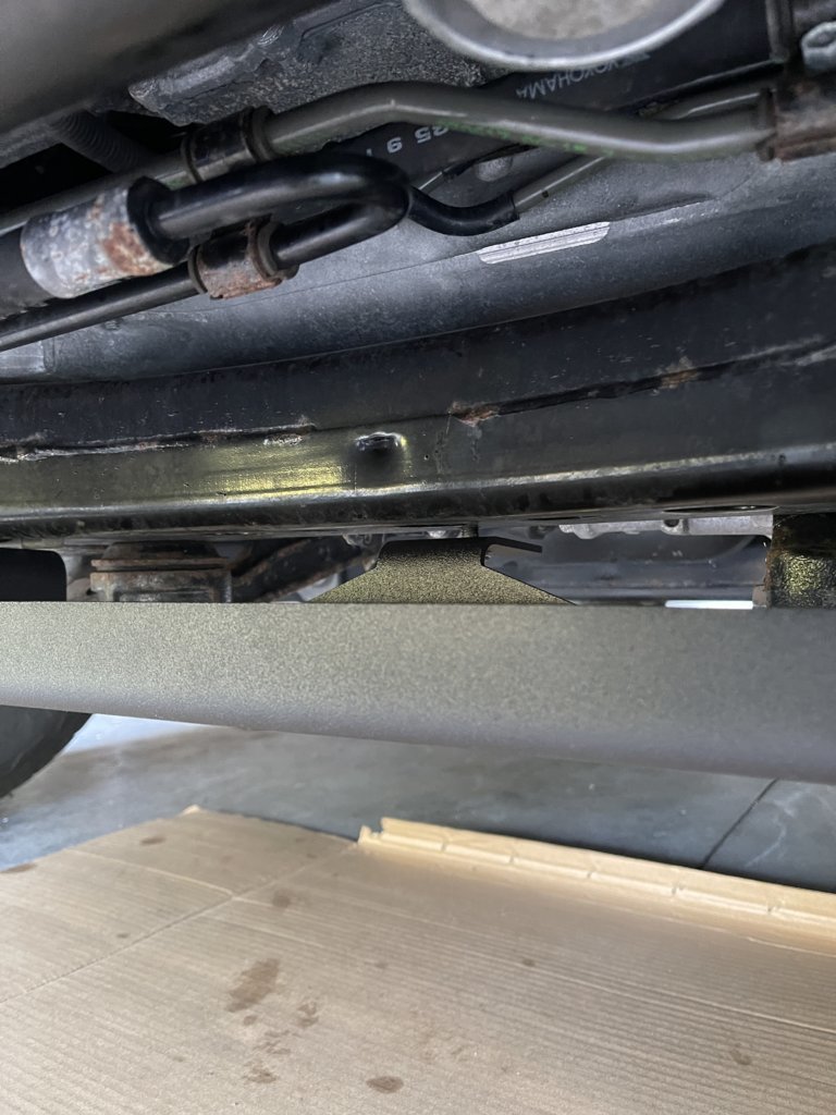

    I’ll throw up some photos later post install once it gets here.
    Update: 8-28-2024
    got it done tonight. I like it. The hardest part was removing the tow hook bolts. Mine started to seize due to rust on one of the front passenger side bolt. Almost stripped the thread. Added anti-seized to all bolts. Should not have any issue for future removal. 2nd, semi, hard part was the rear plate. Used a jack to help lift it up and that helped a lot. Trying to lift it while lying on the ground was NOT working. overall, very pleased. Product shop quickly. It was shipped out the next day after placing the order. No waiting time.
