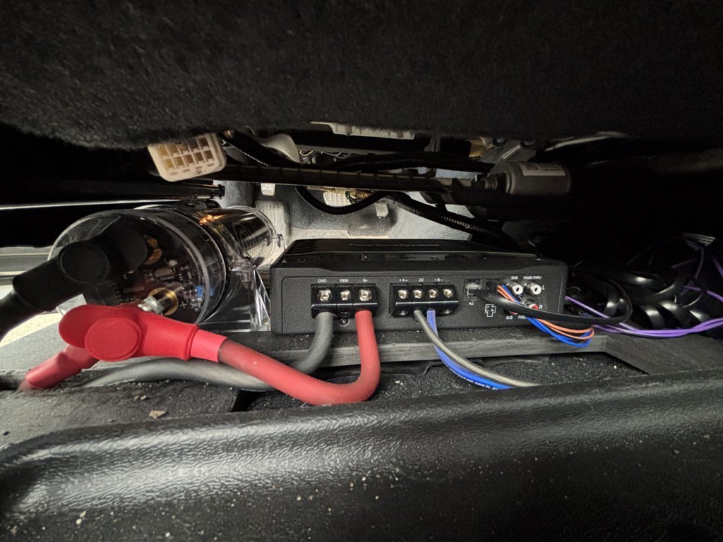

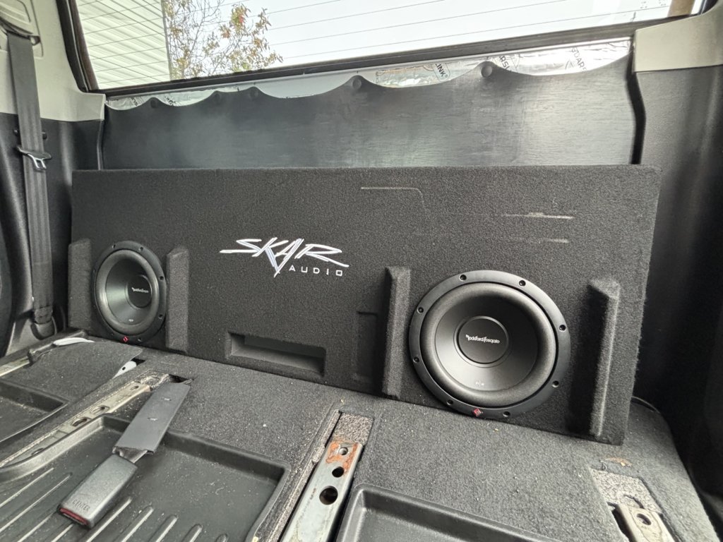

    Been awhile since December and this thread has lots of great info. Installed the Fosgate subs at beginning of year behind rear seats with the Skar box. It comes ported and decided to run as is, even though the size was not right for ported. 2x Subs want a sealed box at 1.18 cf and the ported box was 1.2 cf. sure enough it did not hit right.
    Upper frequencies hit very hard, but the lower range was butchered. Overall not very well balanced and just wasn’t right. Cut two pieces of 1x4 and stacked them. One that fit the hole and another an inch bigger all around to plug the port. With sealant and a decent amount of nails from the gun it is sealed now.
    It sounds extremely good now. Overall very smooth and well balanced. Plays all songs very nicely. Natural sounds like drums, bass guitar, etc sound accurate and clean.
    For rock, country, R&B, oldies, etc. I would not change a thing for the subs. Hip hop, rap, house, 12’s will get the extra low end.
    Box is forward facing. I am very curious how it would sound rear facing. Has anyone tried the same setup front and rear and have comments about the performance?
    Some pics of install. Box has spacers for drivers which is nice to ensure no rub rings. It fits very tight behind seats but works. Sound deadening on back wall. Cut a piece of plywood sprayed black for under driver seat. Will try and get a pic some time of that. Sits flush and leaves an opening for floor vent.

    I don't know that anyone's tested front vs rear firing, thing is you'd have to have 2 different boxes to truly test the same setups. Closest I can think someone could do without building boxes would be to test how the JL stealthbox sounds since it's rear firing, and then remount the pair of 10TW3's that come in the stealthbox into a front firing wedge box of the same airspace. Since MDF is cheap I may build both the front and rear firing boxes and test/see which I like more with my Wavetech. In theory rear firing should have more output due to corner loading but then it becomes a question of cost/benefit of increased output vs increased rattles from the rear wall area.

    If you make it and test it, let us know. Any car I’ve had rear facing always sounded superior. The thought of the extra pressure on the rear glass section and messing with internals did have me thinking about that wear. But the whole car shakes when bumping it, so not sure if that’s a valid concern, lol.

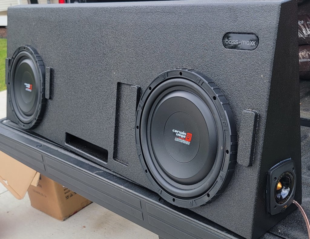

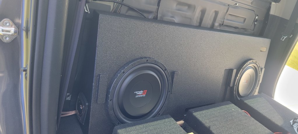

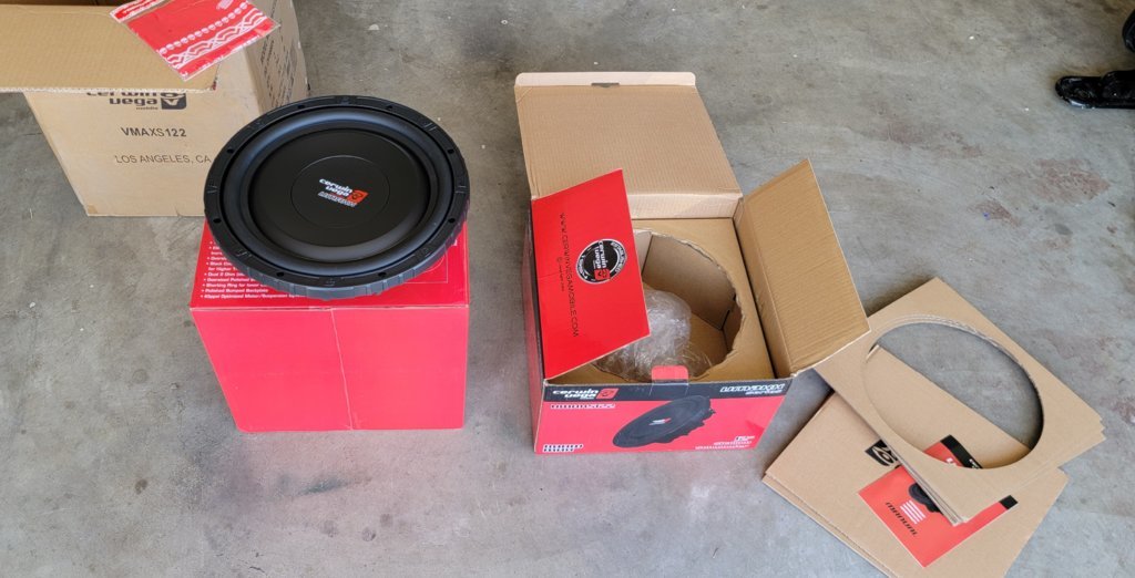

    Got the CV's in not it's time to test and compare to the dd's20250414_121014.jpg 20250414_121004.jpg 20250411_113258.jpg

    Man, I haven't heard that name in a minute! What are you going to power these with?

    At the moment I have a new audio control epic2000 but once I get done doing my testing I'm going to put the dds back on the audiocontrol and put these on a new Stinger mt1500 and run all 4 at 2 ohms.

    I've got an epic1500...awesome Lil amps. Pushes my dual MPS 250s real nice like. If you ever want to get rid of the 2k, let me know.
    What DDs are you running? Nothing but love for those guys, they make awesome stuff.

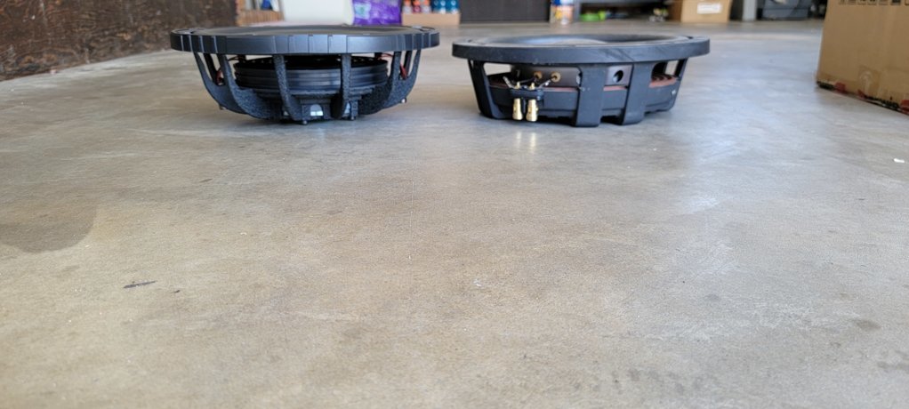

    I am running 2 sl612s and have been happy with them. An opportunity came up to try the cerwin vega subs so I jumped on it. After trying them I'm going all 4 and seeing what happens.:headbang:
    I have been happy with the epic200 myself and rarely do I get rid of stuff but if it does happen I will let you know.

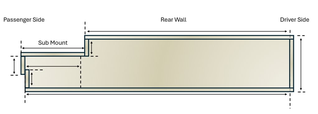

    I'm hoping to have my box finished by the end of this week. It's for a single Wavtech thinPRO 12 which calls for 0.4-1.0 cf. My box should 1cf on the nose give or take a hundredth since it's kind of a hard shape to calculate the exact volume of. That said, my box/design could definitely be adapted to be taller (my height is 13.5" to leave room above for amps) if you're not mounting amps behind the seats. Design could also be adjusted to create a dual enclosure since the seat backs are the same on both sides. This is a sneak peak of the top down view of the design. Essentially a rear firing wedge box wherein the sub mount location is a different 2 angle wedge to account for the seat back.
    It's somewhat akin to the JL Stealthbox design for 2014-2021 crew max's.

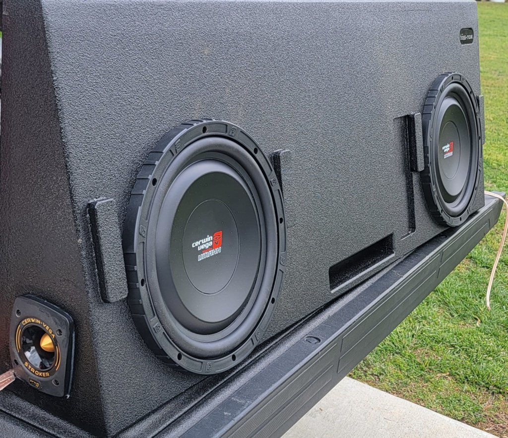

    The box I ordered off ebay for these cerwin-vega 12s behind the seat was $180 and for the most is a well made box. That being said the cerwin-vega's with a mounting depth of a little ove 3in fit fine with its basket design, the dd sl612s will not fit depth wise and the older memphis shallow 12s with a mounting depth of 3 inches won't fit due to basket design20250319_151246.jpg 20250411_113248.jpg

    I agree, some is better than none, so far I'm happy with the cv's but I haven't put them through the ringer a whole lot yet but so far I like. Power handling and size is less than the dds but for somone looking to add bass to their crewmax tundra and not do any mods I would say they are a good option. The dds are 600 rms and the cv's are 400 rms

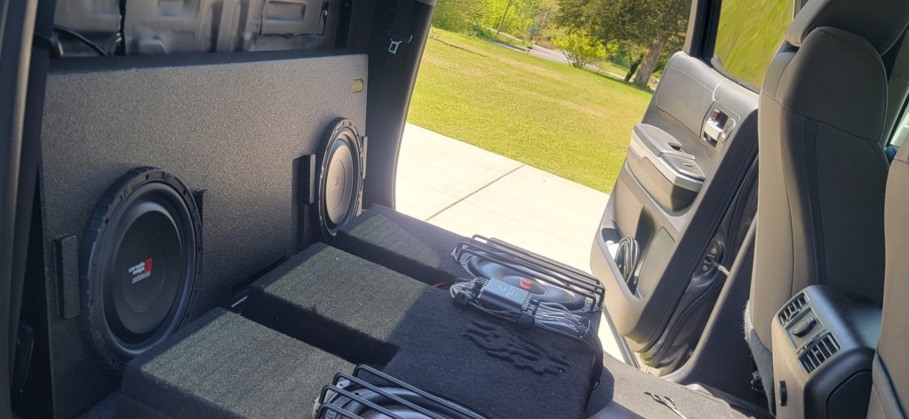

    This is my 1st setup behind the seat and the box is setup for 2 subs and I didn't have the jbl sub to begin with so I have nothing to compare but I can say if the seats are down it makes a good bit of difference than having the seats folded up. Folded up let's the subs shine
