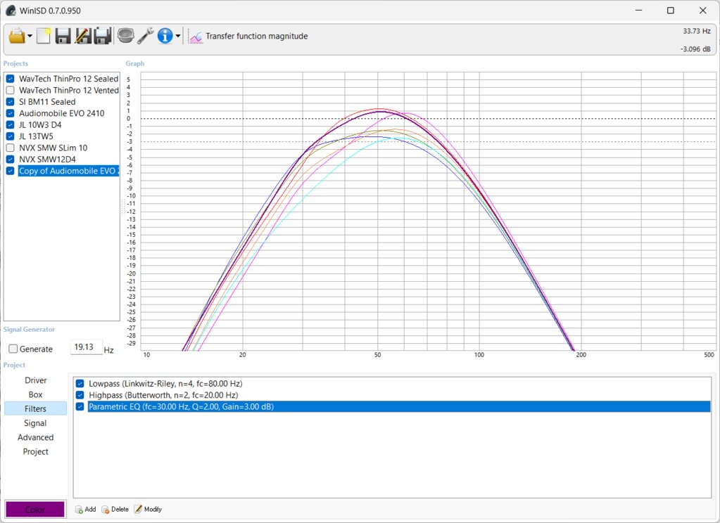

    3,447
    @Snert

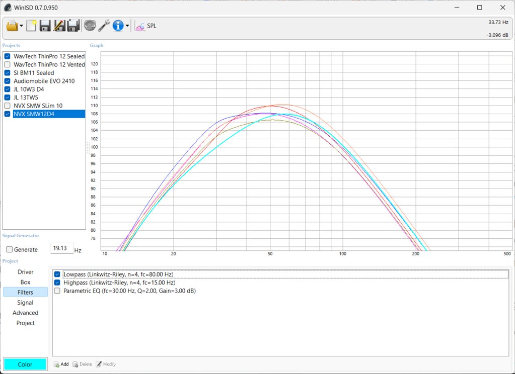

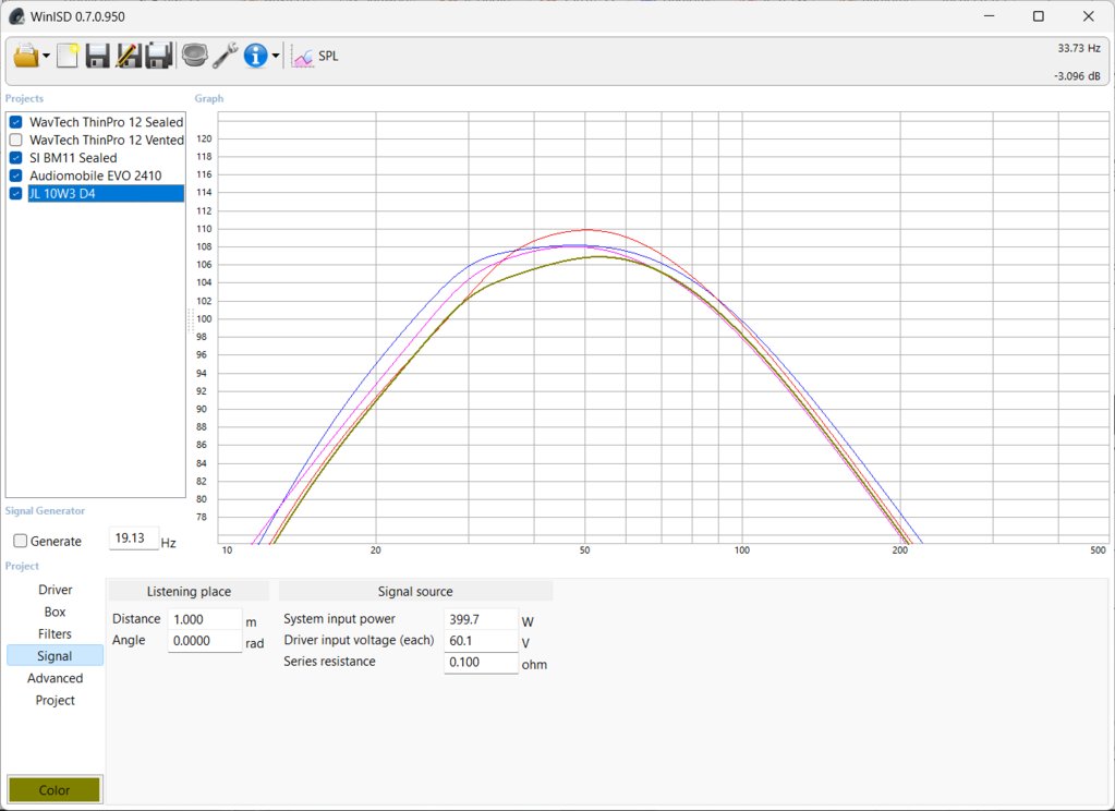

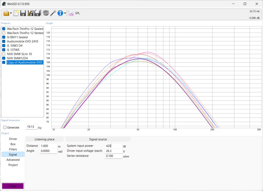

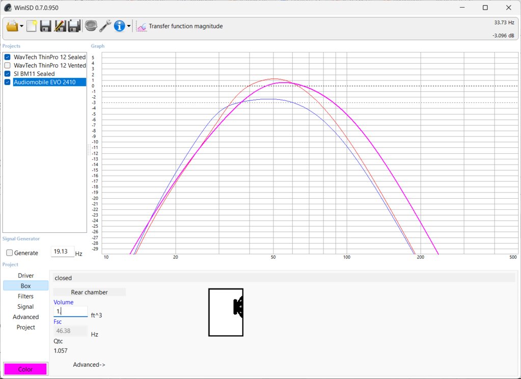

    Here are a few more WinISD sims for some of the drivers on your list, plus a cheap $90 NVX slim sub, just for kicks and giggles.
    AudioMobile EVO 1204 is up first. I will caution that there are several different sets of TS parameters floating around, but I pulled these ones off of AudioIntensitiy website. VAS is drastically different on another set of TS parameters that I found, but Fs and QTS were the same. So the model may not be completely accurate. Initial box suggestion from WinISD was for a 92 cu ft box! Or, in other words, free-air... Again, not sure which specs to trust, but if you can't find the MFG numbers consistently, I'm not sure where to go other than testing a driver directly.
    Standard filters without boost shifts tuning much higher in the MFG suggested .5 cu ft box
    Up the enclosure size to 1.0 cu ft and you have a bit more low end.
    Cone Excursion is fine without boost at 600 watts, but adding 3db at 30 hz to get a bit more low end requires us to drop power down quite a bit to keep excursion happy.

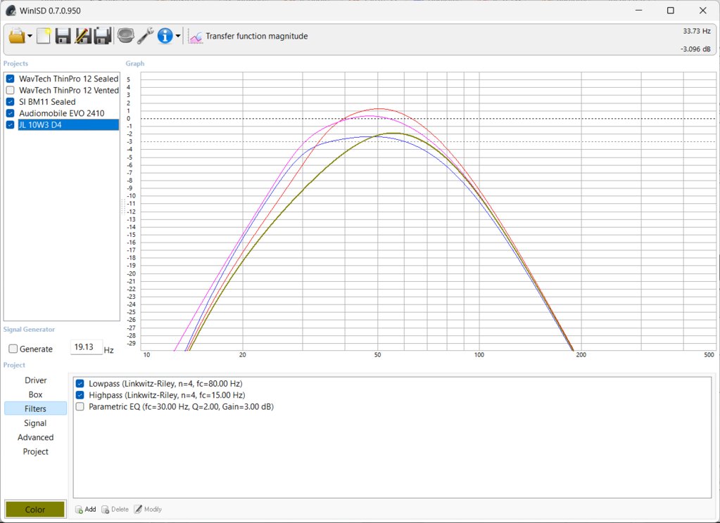

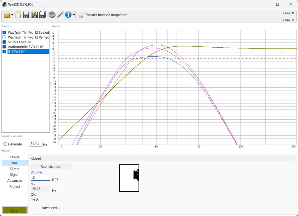

    Next lets look at JL 10WT3. Super easy to work with. Very robust and flexible setup.
    Apply the standard filters

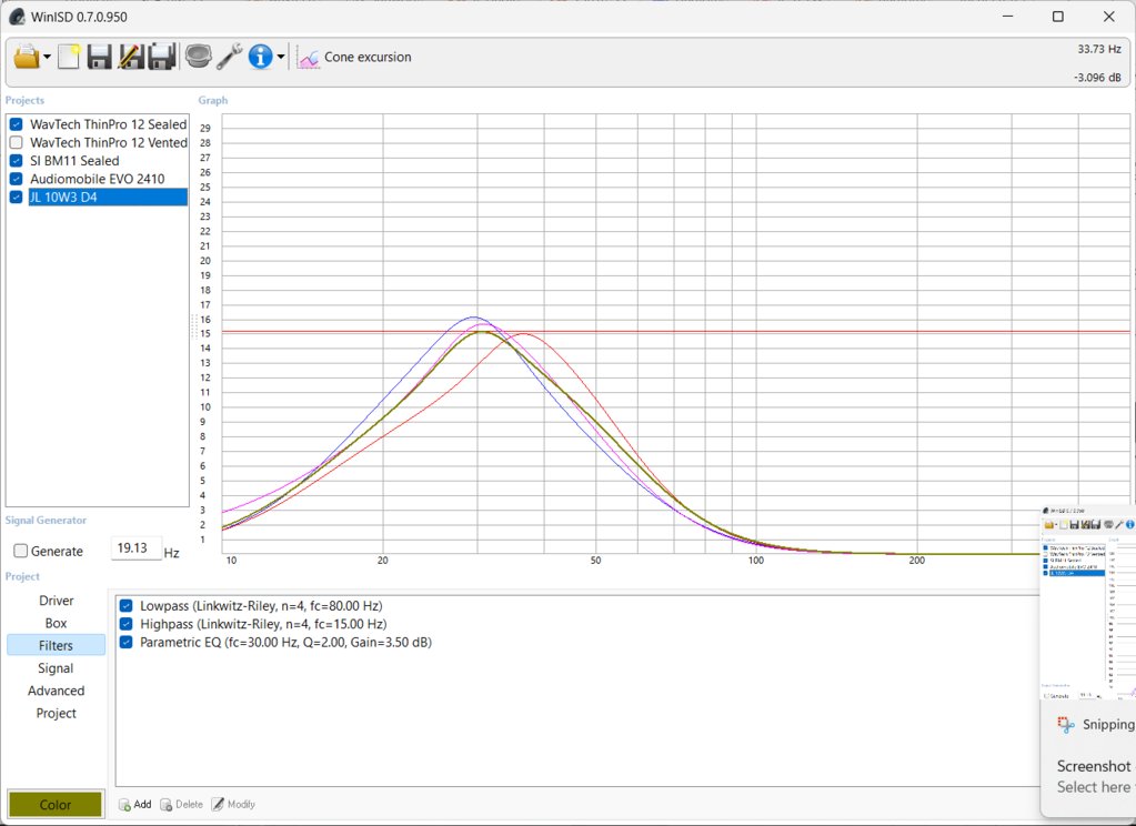

    Now for some EQ; the low end is a little shy, but you are in .5 cu ft.
    Xmax is happy, even with the 3db of boost and 400 watts (making for 800 watts at 30 hz).

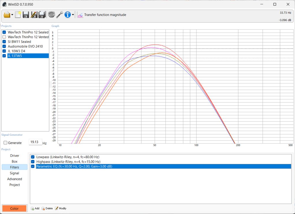

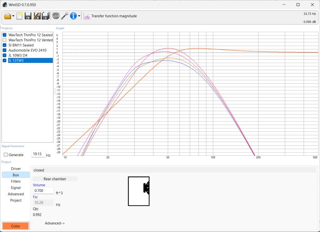

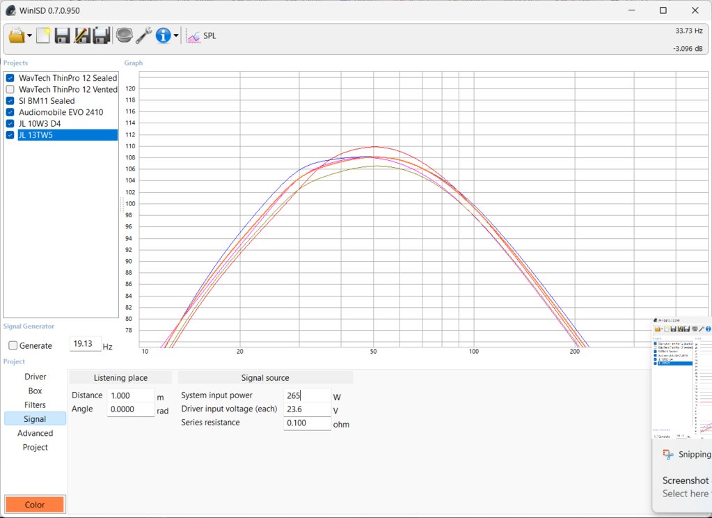

    Lets look at the JL 13TW5. Less xmax, larger cone, nearly identical results, but less power.
    Standard Filters. Again, low end is a little lean like the 10TW3 even with 3db of boost

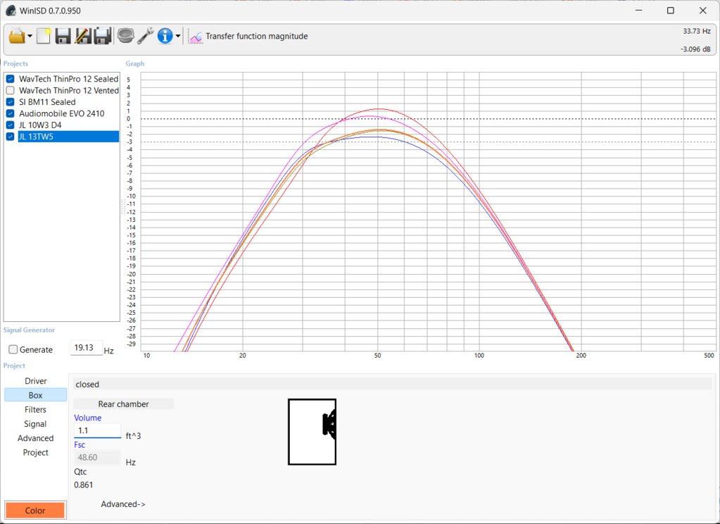

    Increase the box size to 1.1 cu ft and low end fills in.
    But at the expense of power handing if using boost. Power drops in half so the sub is seeing under 600 watts at 30 hz, half there everywhere else.
    Overall SPL looks almost identical to most of the other drivers, but with less power than some.

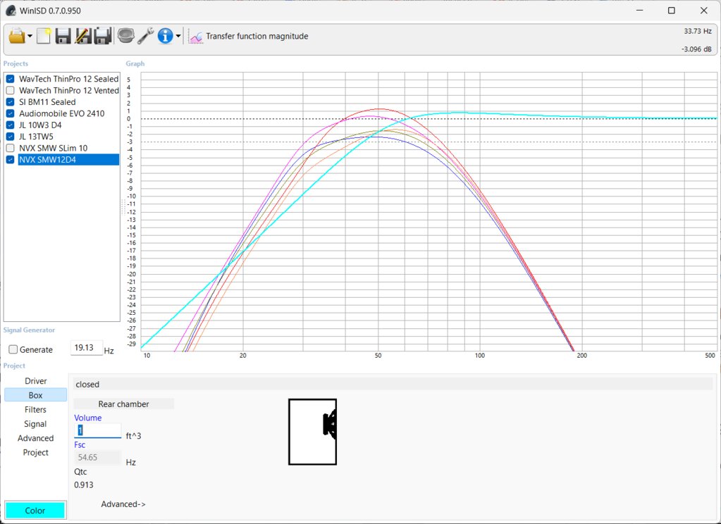

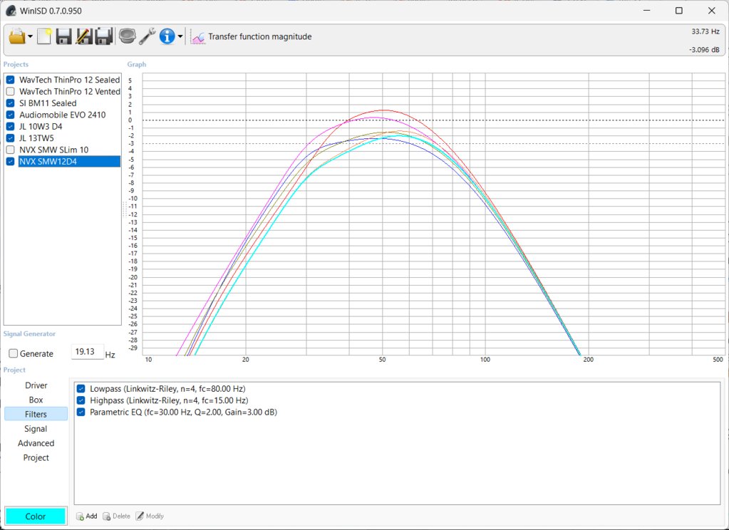

    Now for the bargain sub - an NVX SMW12D4 slim 12" sub that on paper has no business playing with the big dogs. No, it's not going to mop the floor with all the other high dollar subs, but you can see what 4x the price gets you.
    Typical higher rolloff of large sub in small box. 2.8 cubes is optimal, 1 cube minimum.
    Standard filters with boost makes for a leaner bottom end, but....
    ... SPL WITHOUT boost gets you this...
    ... and on only 250 watts, no boost required.
    Again, I'm not saying the NVX is better in really any way except price. But it's surprisingly close.
    Also, note just how close in response the various drivers are given the box constraints. The limited space we have to deal with is the big equalizer here; some drivers overcome it with power, some with boost, some with cone/motor design. But all are subject to hoffmans law - you want it low, loud, and compact: pick two.
    Merry Christmas!

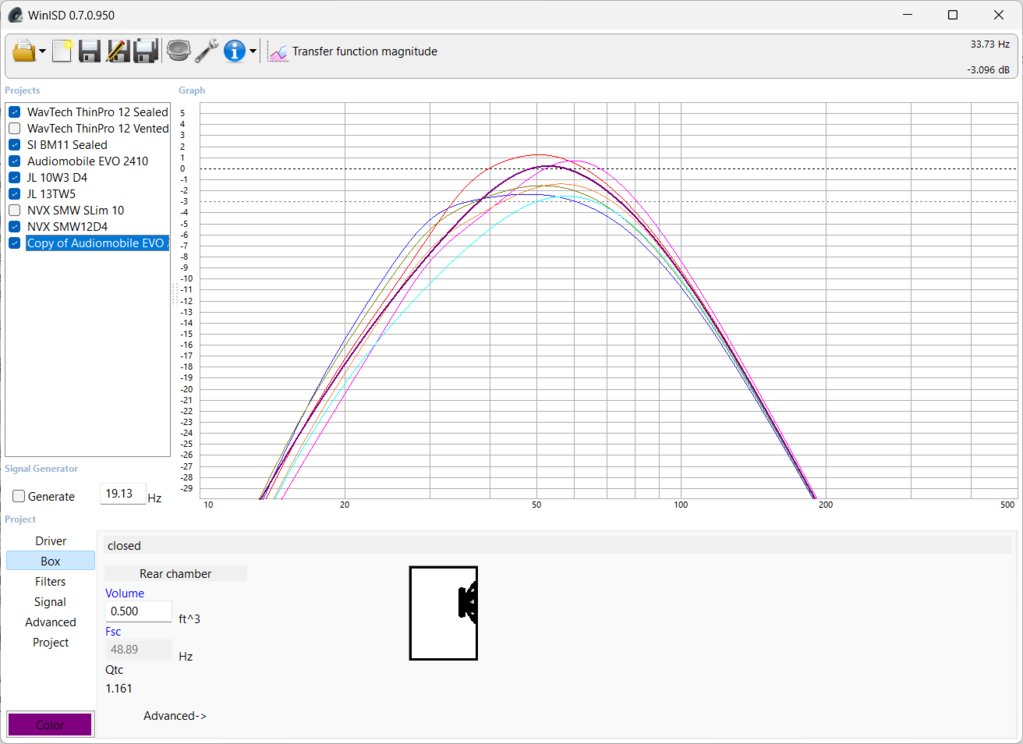

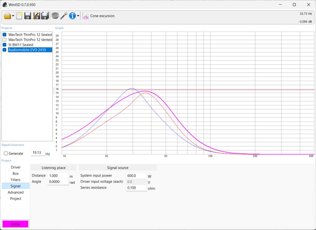

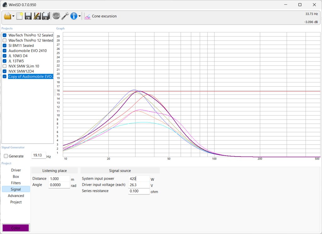

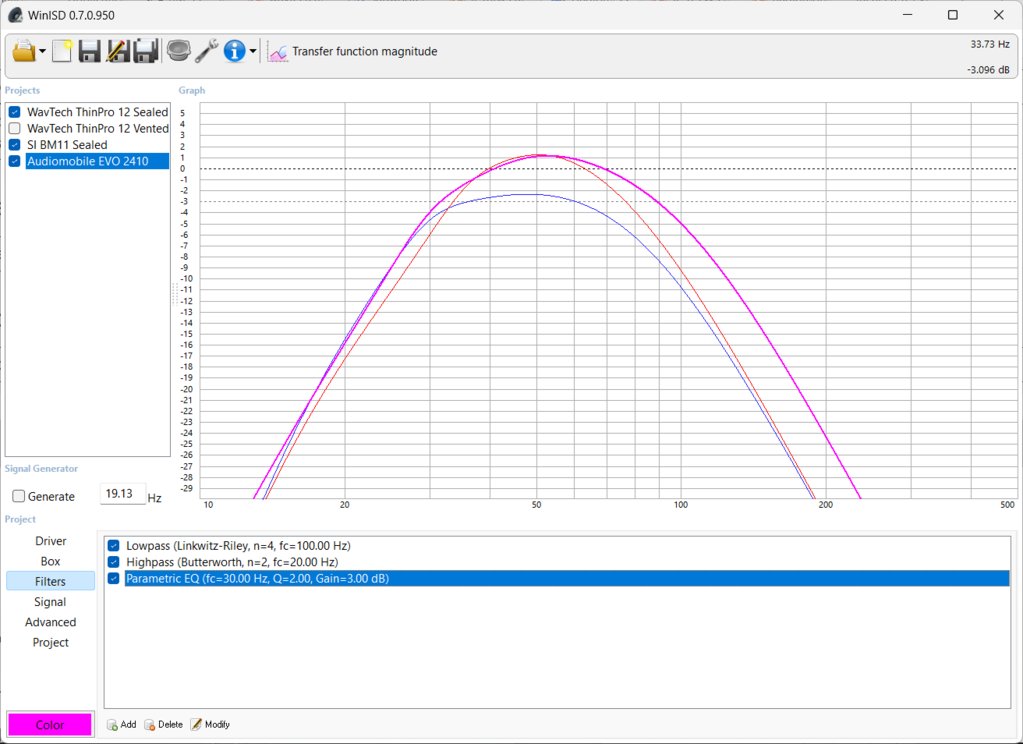

    I reworked the Audiomobile EVO 2410 with a different set of parameter (namely change VAS to 25L) and found a nicer frequency response, but less ouput.
    With High and Low Pass filters
    Add some Boost - 3db at 30 hz
    Excursion was little unhappy at 500 watts with 3db of boost, so we drop down to 420 watts to keep excursion in check
    SPL drops a little bit as well, but response curve looks good in .5 cu ft. Going with a slightly larger box will get you a little more on the bottom end, but will take less power (or less boost).
    EffectiveZed likes this.

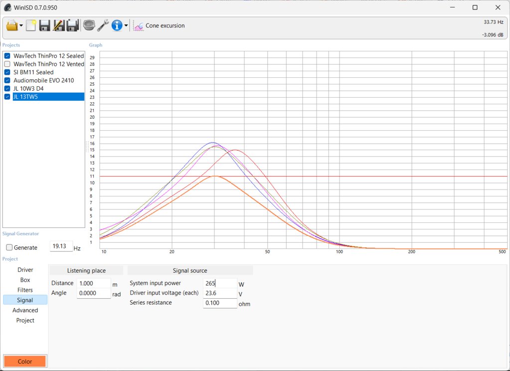

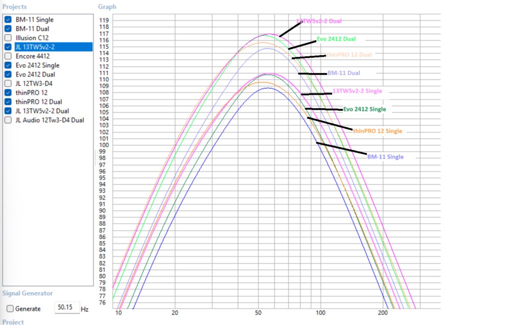

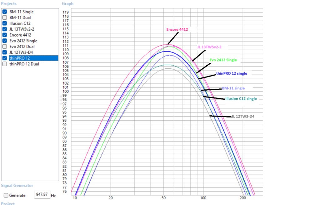

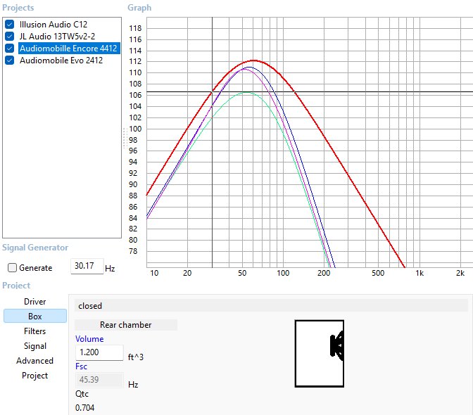

    Looking at various pre-fab boxes and I see that those Taco folks who shall not be named have a pre-fab box for a single 12" with a listed mounting depth of 5.6" and 1.45 ft^3 of air space, with a note about removing the rear wall padding which I've already done since my amp rack is bolted via rivnuts to the rear wall panel that's sound deadened as well as the rear wall. That makes it seem pretty promising that an Encore 4412 would fit. Doing a bit of modeling in Winisd and I got these results, although I'm not super confident in my setups on everything. Used all the T/S parameters I could find for a few drivers to start, set them all to an 80 Hz low pass filter, put them all on recommended RMS, and put them each in the recommended sealed box size and came up with this for SPL:
    The Encore 4412 is the thick red line, JL 13TW5 is the blue line, Evo 2412 is the pink line, and the Illusion C12 is the green line. Was entering the BM-11 and clicked something that closed the whole program before I could compare it to these, but it's SPL response looks fairly similar to the Jl13TW5 and the Evo 2412. The real standout (as expected?) is the Encore 4412, 1000w RMS seems to give it greater SPL across the entire response curve. If someone like @blenton wants to chime in model it to double check my results I'd sure appreciate it :) On paper the Encore 4412 seems to have the best low end output I'm looking for, which I guess then leads me to the next question of beyond SPL, is there any way to discern SQ from modeling? Are there certain cone/magnet/motor materials (take the SI BM-11 neo magnets for example, or the SI/Audiomobile carbon fiber cones for example) that make for a "better" SQ sub?
  21. Feb 13, 2025 at 9:10 AM
    #141
    Snert
    Snert [OP] New Member
    Jan 31, 2024
    #111218
    754
    2021 SR5
    Messing around with more modeling. Seems to me that roughly ~1.5ft^3 or just under would be about the max air space for a wedge box behind the rear seats. With that in mind, comparing the SPL response of single drivers SI BM-11, Illusion C12, JL 13TW5v2-2, JL 12TW3-D4, AM Encore 4412, AM Evo 2412, & Wavtech thinPRO 12 with each driver in max mfgr recommended sealed box size to maximize low end output, 20 Hz highpass, 80 Hz lowpass, and max mfgr recommended RMS power. All of that nets these plots:
    It would appear the Encore 4412 is still the front runner for SPL output. Again, that's not my main goal but ability to dig deep and have good low end output is one of my main goals along with SQ.
    The Encore 4412 appears to have 2-3dB greater output up until about 60Hz. The TW5 and thinPro 12 look about the same until 40Hz when the TW5 has more output thereafter.
    I don't feel I'll need the output of dual subs, but just for shits and giggles I modeled dual subs for the models that would still fall under the ~1.4-~1.5ft^3 max sealed box volume. Got these results compared to their single driver counterparts:

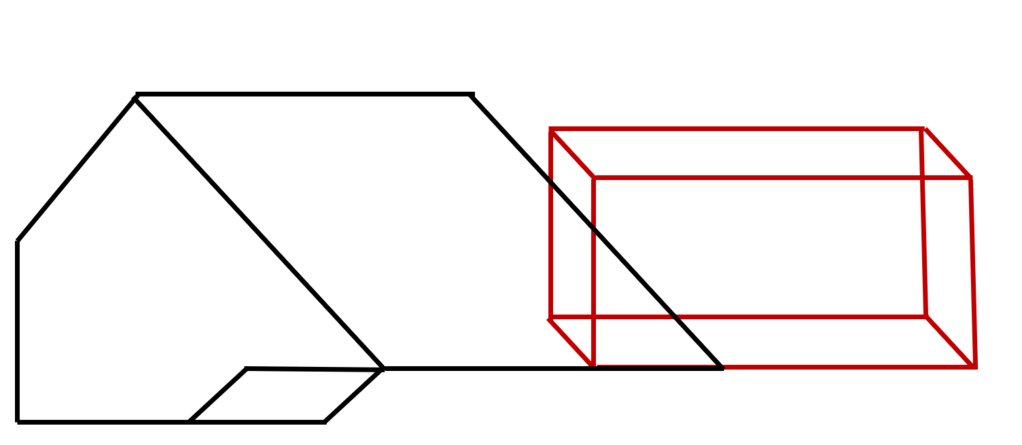

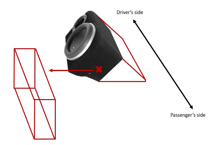

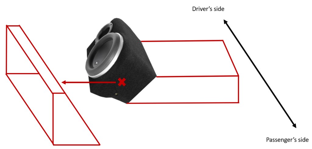

    They only have a dual 10" box for crewmax and the mounting depth is too shallow as well as magnet diameter.
    Thanks for the input! I might be going to Chicago in April so maybe I'll see if I can check them out. I'm guessing they're box is for the Evo 10's as those are a little shallower and have a less wide magnet.

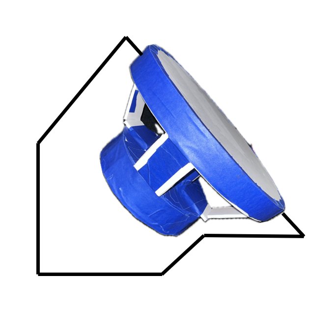

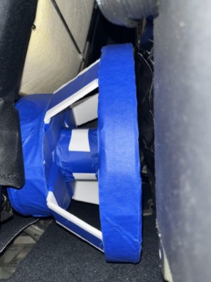

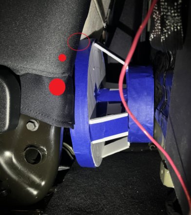

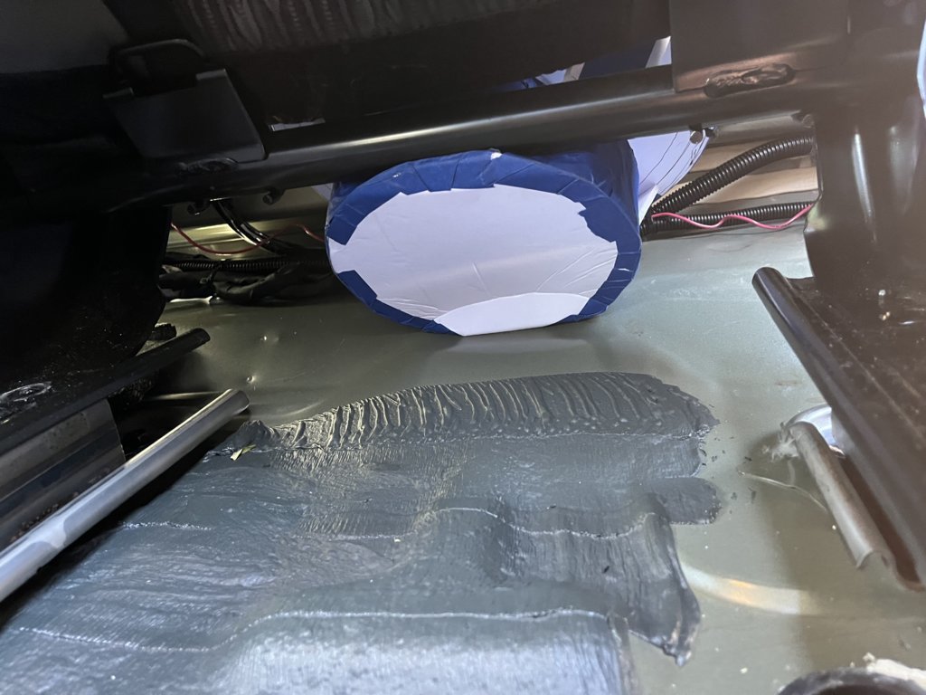

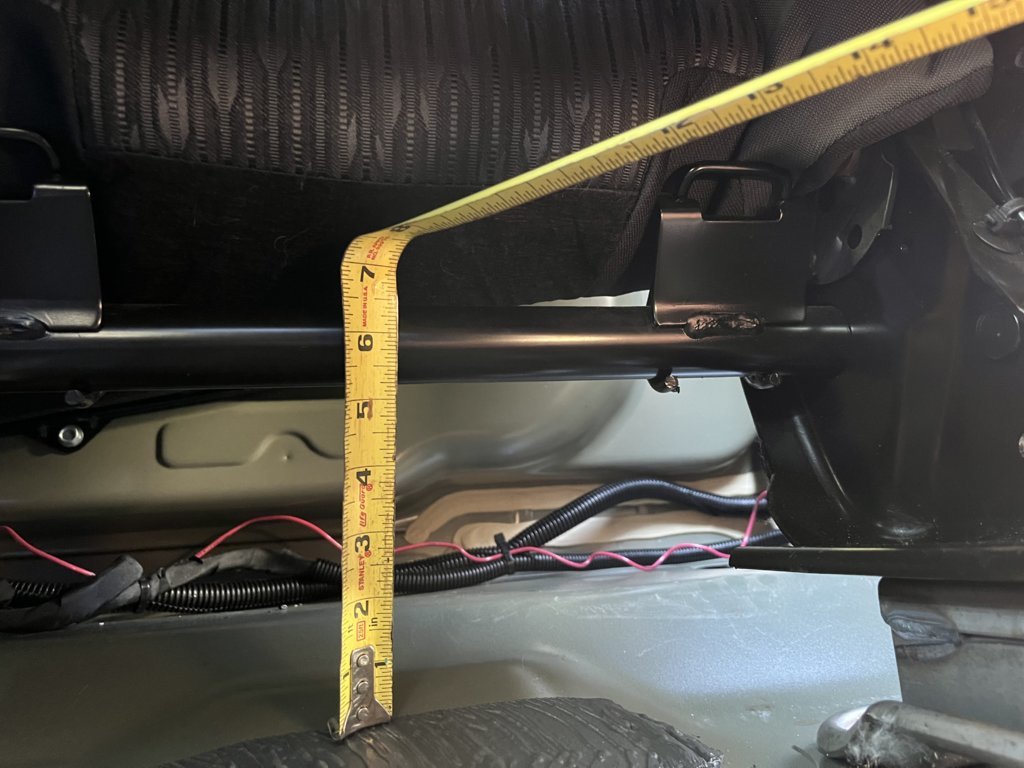

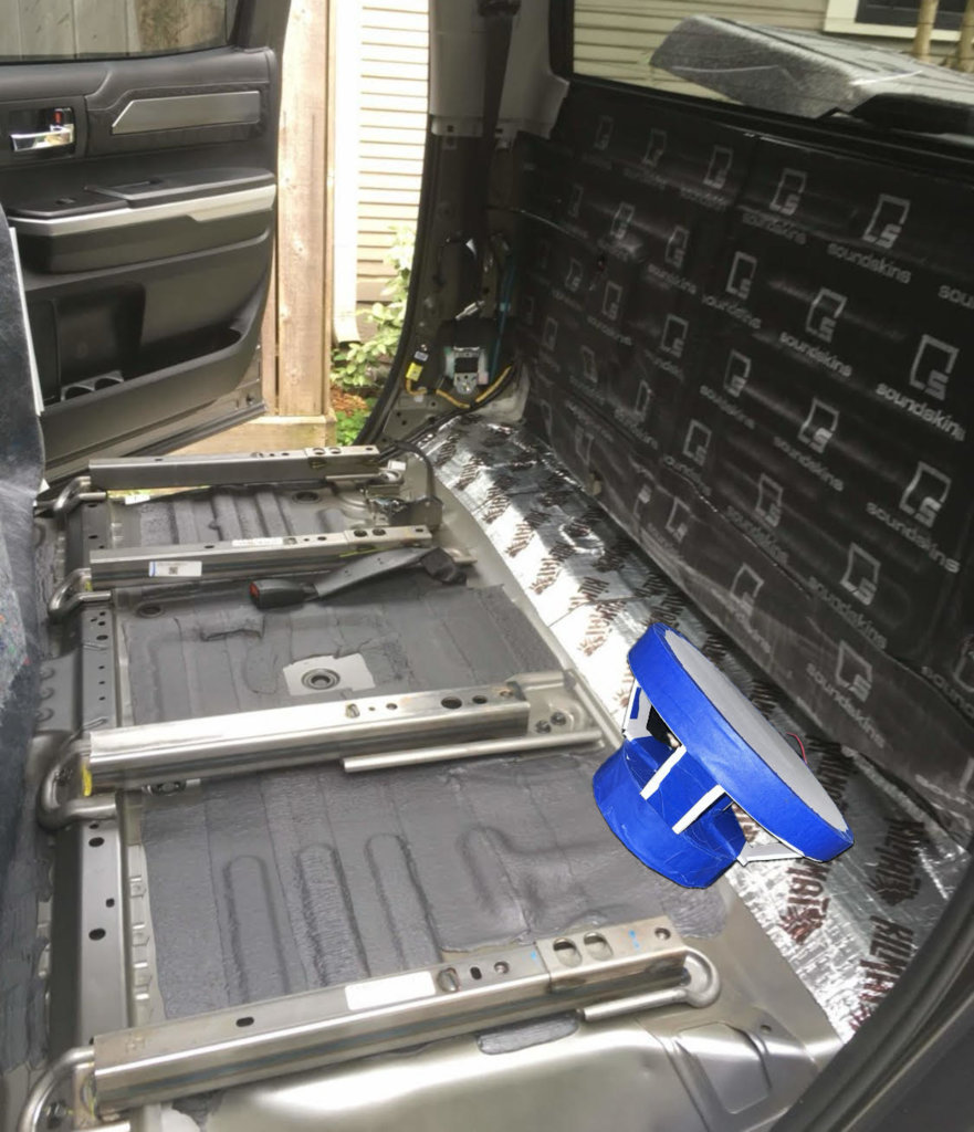

    I've been taking a ton of measurements, doing some more modeling in Winisd, and I even resorted to mocking up an Encore 4412 using foam poster board. The frame angle dimensions aren't perfect, but the surround is 12" wide, magnet is 190mm/~7.5" wide, mounting depth is 5", and the surround is 1.5" tall from mounting surface. Overall it's close enough to get a decent idea of fitment. With the sub front facing, there's no way to make it fit without hitting the seat frame and foam at a couple spots, and that's with the magnet touching the rear wall:
    I started thinking about removing foam to drop the surround down some to clear the seat frame, but quickly realized the foam doesn't extend all the way to the back wall and there's a metal hump/slope that comes out from the back wall and drops off at about 3.5", more on that in a sec. That got me thinking, take a page out of the JL stealthbox book and check fitment reverse firing:
    Can see here that with the sub push all the way back against the seat frame, it clears the back wall by ~1.5". I found an article that listed a spec for the surround height being 25mm, which is just shy of an inch, meaning my mockup surround is .5" too tall which is good. Overall I think this fitment would still be too tight though. I then started thinking again about removing foam, this time to drop the magnet down and put the sub on an angle, that's where I'm at right now. Not a realistic solution on the passenger side since the jack brackets etc. are over there (don't care about relocating the jack but there's a bunch of sheet metal etc. that would have to be removed as well) but on the driver's side it's nothing but foam and the seat legs/frame is wider on the drivers side. The dilemma is the geometry of everything, essentially the magnet needs to be able to drop at least a few inches to clear the seat frame, and then with it angled back towards the seat, the surround still needs to clear the seat frame as well. I've got my seats pulled and plan on removing the c?-pillar trim back there to roll the carpet back, remove the foam, and see how things layout. I found some pics of trucks with the carpet rolled back and foam removed to get an idea of the slope of the metal, and it's fairly gradual which is a good sign.
    This pic is from another member's truck with my mockup laid overtop, not to scale, but to get an idea of the potential layout. I'm stubborn and once I get something in my mind I'll go to great lengths to try and make it work until I'm 100% certain it won't haha.
    The bottom edge of the sub would probably be a little closer to the back wall at a steeper angle, but again, won't know until I get the carpet pulled back and foam out to tell.
    Overall the box shape from the side would look something along these lines:
    and then to get the required cubic foot airspace I would either just extend the depth out under the seat, or slap a wedge box with opposite slope to match the seat backs or just a rectangular box next to the sub chamber, and make it as wide as needed behind the seats, sort of like this:
  25. Feb 27, 2025 at 9:11 AM

    If I can work out making this sub fit, it might open the door to other regular subs that have a lower mounting depth and not super wide magnet. I think the biggest thing is just going to be deciding if it's worth cutting the carpet. Ultimately it would be cutting 2 extra seams in the carpet and removing foam, which would be barely noticeable if you put the truck back to stock and stuck the foam back in, just have 2 extra seams in the carpet.
    Take like a JL 12w3 as an example, 6-5/8" mounting depth with a 5.5" wide magnet, or even a JL 12w6 has a 7-9/16" depth and a 7" wide magnet, Audiofrog GB's are a very popular SQ oriented sub with good SPL as well, the GB10 is 6-1/4" deep with a 6-1/2" magnet and the GB 12 is 6-5/8" deep with the same 6-1/2" magnet diameter.
    Obviously this is a big "what if" and maybe the reason I've never seen it done is because someone else has tried and failed, but I can't find anyone talking about doing a box like this so I'm not sure if anyone's taken the effort to try.
    I remembered that for the double cabs JL did an 8w7 stealthbox that extends under the seat, cropping that box (ignore the port etc.) to visualize looking at things from the passenger side to illustrate:
    Could remove all the foam under the seat and have the box replace it, and then if need be to get the air space could put an opposite sloped wedge attached to the side with the X, basically would need to clear the lowest bar of the seat frame and be about a 75* slope
    or could make the box under the seat more or less a wedge, and then again could attach an opposite sloped wedge to it or a rectangular box again to get the necessary air space sort of like this:
    Could essentially play around with any combo of these shapes so long as the sub itself can fit which again comes down to the sub's magnet clearing the lowest bar of the seat so it can drop in under the seat and have enough room off the bottom to then have the proper angle for the surround to not hit anything either.

    Alas I think it’s time to stick a fork in it. I got my carpet pulled back and threw the seat in. I underestimate how much of a hump there is under the rear driver’s side seat. The space between the seat frame and floor pan is ~5-1/4” give or take:
    As you can see, the seat frame hits smack dab in the middle of the magnet.
    That bar is at the same height across the middle seat, and although the middle seat has less of a hump I think you’d run into the same issue. I tried flipping it around, having it down firing etc. to no avail. I still think you could maybe squeeze it in rear firing but you’d have the mold/fiberglass the seat back to squeeze out every available millimeter of depth. With it rear firing you’d maybe have 2” to play with, give it 0.5-0.75” at the back and 1.25-1.5” in the front for excursion and it just maybe could squeeze in. I don’t have the skills or know how to do that so it looks like I’ll be settling on a true shallow sub here

    Boneskull420
    Boneskull420 God loving,Tundra driving,rednek custom joker!
    Dec 11, 2024
    #127230
    680
    Mark
    Tn
    2018 tundra crewmax magnetic gray trd offroad
    Ironman 4x4 foamcell pro 3.5in lift Complete custom stereo with 2 12's under rear seat S&B/stillen Frankenstein cold air intake True dual exhaust with Carven Tr mufflers Rough country hood bulge led strip Running board led's
    Would a .5 - 1 inch seat lift make any difference in that situation?
