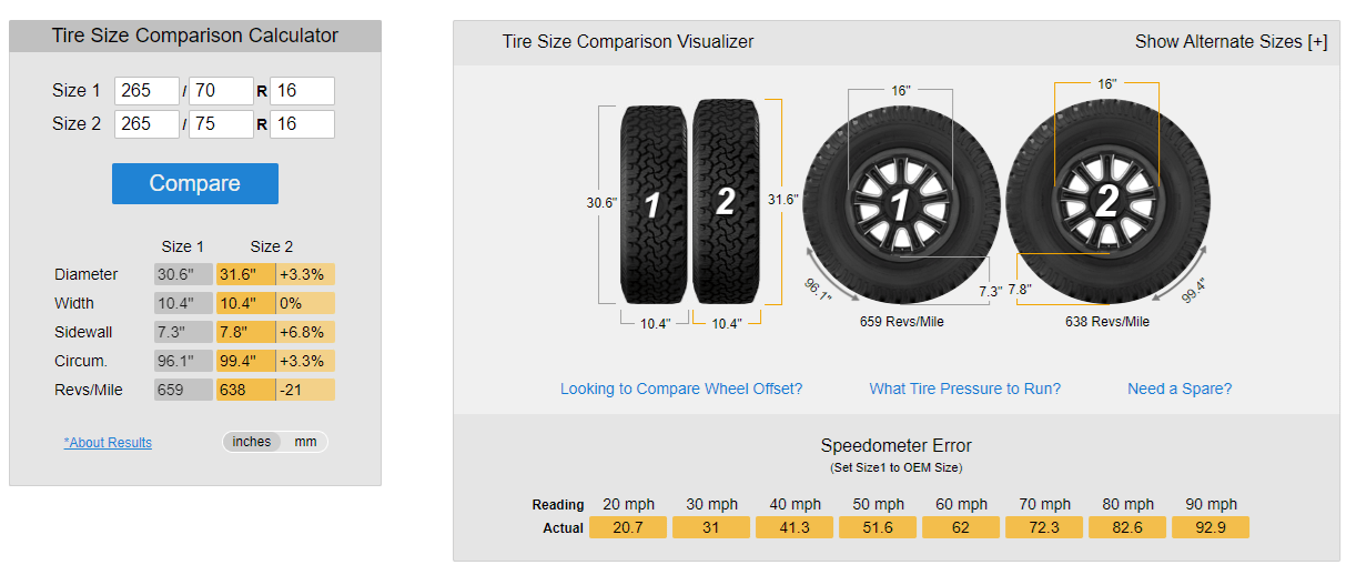

  14. Jun 19, 2024 at 6:08 PM
    tt9309453
    tt9309453 [OP] New Member
    Jun 15, 2024
    #118451
    10
    I just looked at the window sticker, and it came with 265/70R16. Checking tire sizing comparison, do you think I could get away with 265/75R16 given that it is a 16" wheel?
  15. Jun 19, 2024 at 6:17 PM
    shifty`
    shifty` In South Dakota Trouble ain't hard to find
    Jun 20, 2020
    #48239
    28,677
    ATL
    '06 AC Limited V8/4WD
    That would be a very similar upgrade from the stock 265/65r17 in 17" wheels going up to 265/70r17. You're gaining an inch in diameter. May be able to align out any rub without a strut spacer or proper lift.
    Worst case scenario, run it. If it rubs, try aligning it out, or throw on a small strut spacer until you can lift a little. I think you can probably get away with running it. But it's your money, not mine, so don't hold me to it. We've had other guys make a 1" jump with (supposedly) no rub.

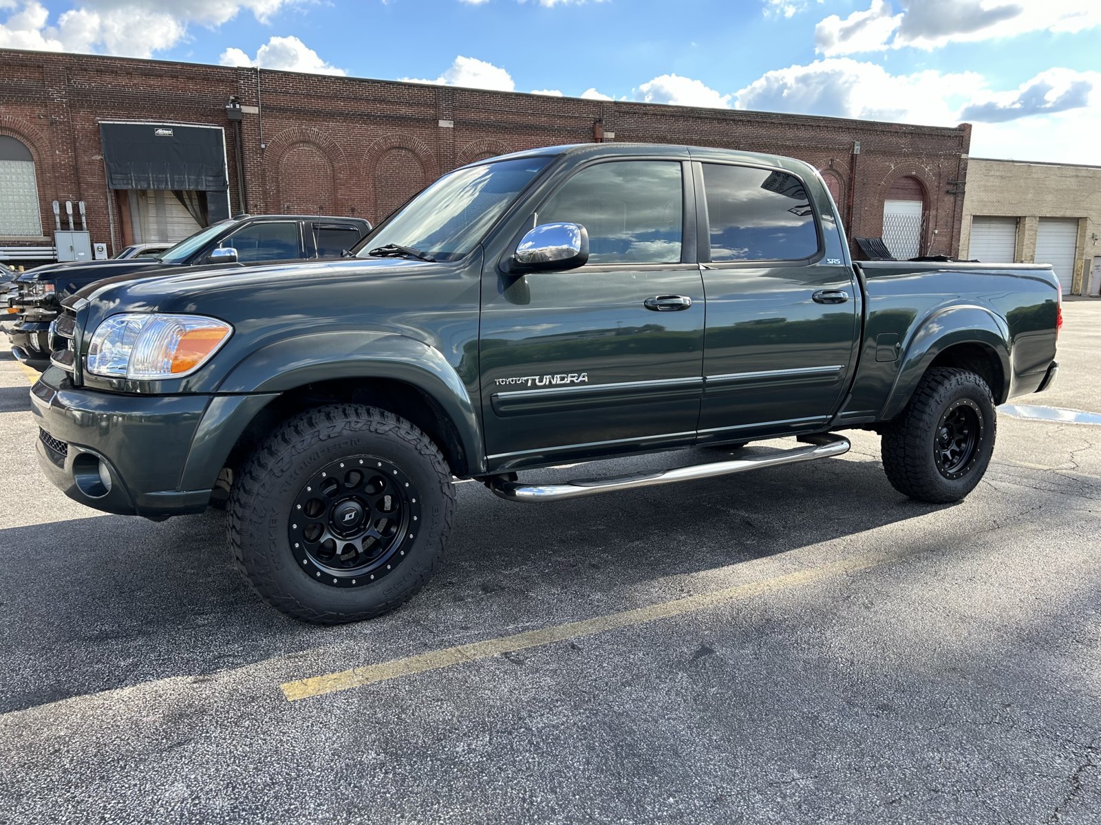

    KTM_AJ421
    KTM_AJ421 New Member
    Sep 1, 2023
    #103221
    420
    AJ
    2006 SR5 DC 2WD 4.7
    265/75r17 M/T Baja Boss AT 17x8.5 -10mm SCS Ray 10’s Bilstein 5100’s 2nd notch
    I’ve put this up a bunch. I went with 5100s on the second notch with stock 158k miles springs. They ride great on the freeway maybe a little stiffer with big potholes which we have a lot of in St. Louis but the roads suck here anyway. I’m running 265/70r17s and no rub or anything and got about 1” of lift.
    if I had to do it over I’d probably go 5100s bottom notch with 2883’s or 4600’s I still have enough take to look good and not be too high. A little bit of lift on these trucks makes a huuuge difference btw.

  18. Jun 19, 2024 at 7:53 PM
    KTM_AJ421
    Sep 1, 2023
    #103221
    420
    AJ
    2006 SR5 DC 2WD 4.7
    not sure I haven’t had to go into any but it’s not super high. Just for the stock 1GT height an inch or two makes a big difference. It’s not a monster truck but I don’t want it any higher
