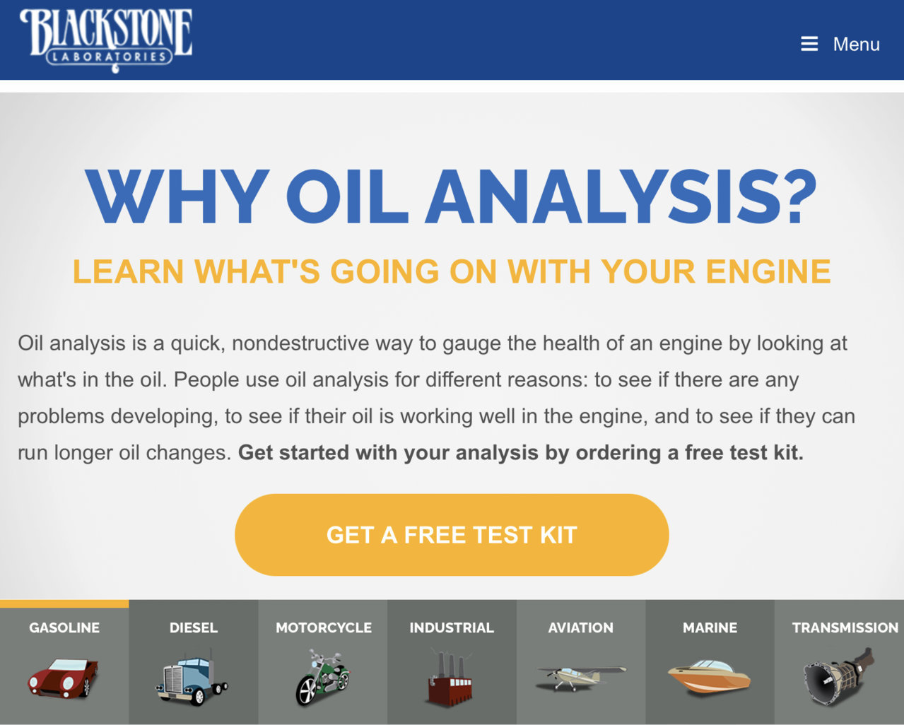

    I have sent samples in from a 3.4. I will do the Tundra once I am a few synthetic oil changes in.

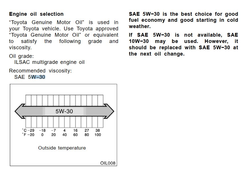

    Oh boy, here we go again :D
    Depends, where are you, hot climate or cold climate? You may want to change viscosity depending. Heavier viscosity if you're in super hot areas. Lighter if in areas that see ultra-freeze temps. 5w30 is the 'optimal middle'.
    I personally use Mobil1 Extended Performance 5w30 full synthetic with the OEM filter which kicks every other filter out there's ass, hands-down.
    But just to put this to bed, RTFM. Here, I'll do some legwork for you. This is directly taken from the Owner's manual. The book is there for a reason, friend! ;)
    (It's also downloadable online)

    I never assume ppl know specifics, so I'll say it. Number before W is the cold viscosity, number after w is hot viscosity (at temp). Higher the number, the more viscous/thick the oil is in each state of cold or hot. (if memory serves)
    It's my belief the hot viscosity number is more important to get right. While weather can radically impact cold viscosity, engines are only going to get so hot before they overheat and stop running, it's only going to get so hot, thus so viscous. Higher viscosity could, in theory actually create more heat.
    I'd personally stick with what the manufacturer recommends. But I've seen plenty of cases in my life where people in ultra cold areas swear by 5w5 - 5w10 lighter than what the OEM recommends, and I've also heard guys in ultra hot areas swear by running oil 5w5-5w10 heavier than OEM reco.
    I distinctly remember reading one mechanically savvy in Alaska saying he'll only use 0w20 in V8s similar to our later model 1st gen Tundras versus OEM reco 5w30. I personally think it's a little extreme and wouldn't go below 0w25, but that's just me.
    I would say, it's your truck. Don't take my advice, I'm not a pro. My uncle used to build high-end drag engines in Vegas, he could calculate all this based on engine tolerances so it's something I'd usually toss at him for advice. We lost him to Covid last October.
