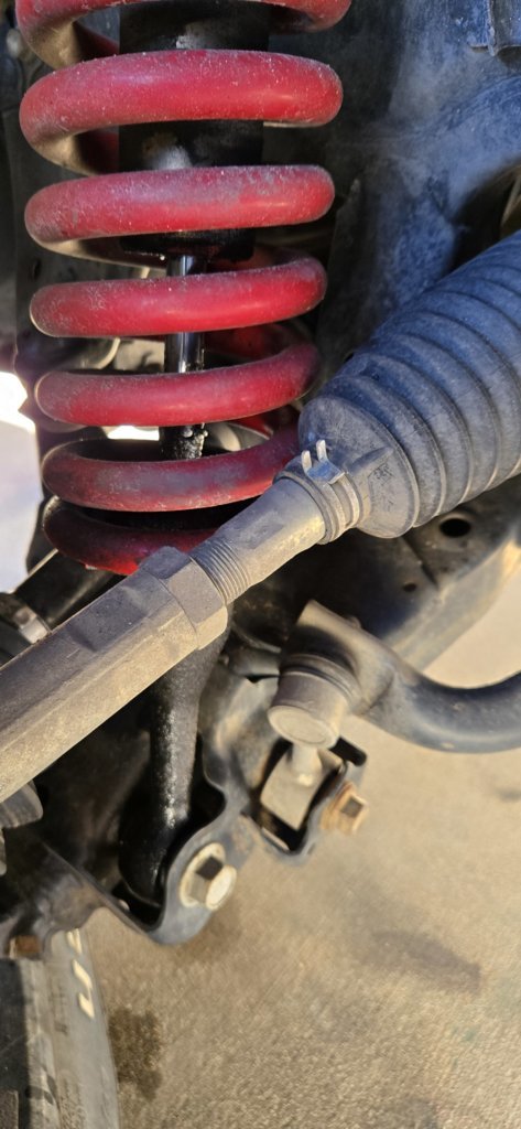

    So I'm guessing this isn't good?

    what is the difference between the Bilstein 8112 Zone Control DSA + and the 8112 Zone Control?
  16. Feb 8, 2025 at 4:36 PM
    #226
    Tundra234
    Tundra234 New Member
    Nov 30, 2018
    #22402
    18,460
    George
    Florida
    2020 Tundra DC SR5 Barcelona
    Alot of them
    The DSA+ has low speed and high speed damping adjustments as to where the regular 8112 does not. I see you have a Toytec that looks like it's leaking where the shaft goes into the shock body? They are rebuildable but I have no dea what the cost is.
    reywcms and memario1214 like this.

    They are rebuildable, it's about $500 but to take them off myself and then wait the 2-3 days to have them rebuilt is a PITA. I could take them to the shop and have them do it but that increases the cost to $1300. Just seems like a good time to upgrade.
  18. Feb 8, 2025 at 4:52 PM
    #228
    Tundra234
    Nov 30, 2018
    #22402
    18,460
    George
    Florida
    Alot of them
    Yes a rebuild is expensive considering they are $1400 or so for the pair when new. Mine have about 55K on them and will most likely be coming out soon as well.

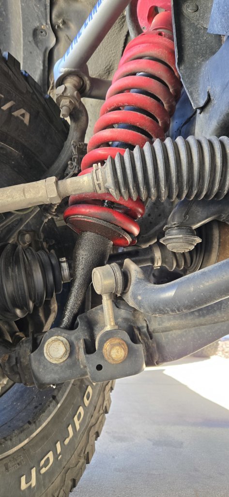

    Ok I need some clarification. I have come across 2 different product SKU's for the B8 8112, they are both listed as left front. SKU 41-326022 and 41-284544
  23. Feb 13, 2025 at 8:24 PM
    #233
    memario1214
    memario1214 Hotshot Offroad Staff Member Vendor
    Dec 13, 2015
    #2252
    12,750
    Colton
    Missoula, MT
    '21 Limited MGM CrewMax
    The 544 part number is the old silver shocks. Both are non-adjustable versions, but the 022 is the newest version that is gray and yellow. The 544 has not been in production for 3 years.

    Ok, need some advice. Just got a call from toytec. They will rebuild the fronts, put new shocks in the rear. In and out in about a day. The total is about $1500. Or do I ignore the rears and buy some bilstein 8112's for the front and do it myself?
  27. Feb 18, 2025 at 9:59 AM
    #237
    Tundra234
    Nov 30, 2018
    #22402
    18,460
    George
    Florida
    Alot of them
    What do you have in the rear now? As far as rebuild, the front coils are like $1400 for the pair. To me it's not worth the cost to rebuild them. The rebuild on those alone is $800 to $1K.
  28. Feb 19, 2025 at 8:00 AM
    #238
    dbldutch
    dbldutch Full send
    Oct 2, 2017
    #10024
    80
    Dutch
    Highlands Ranch, CO
    2021 Black SX SR5 crew
    Trd pro headlights, baja designs fog lights, total chaos uca's, toytec lift
    Actually the whole cost is about $1550 for rebuild of front coilovers and brand new rear shocks from the quote I got from toytec. That's way cheaper that just the cost of new bilsteins up front and doing nothing to the rear.
