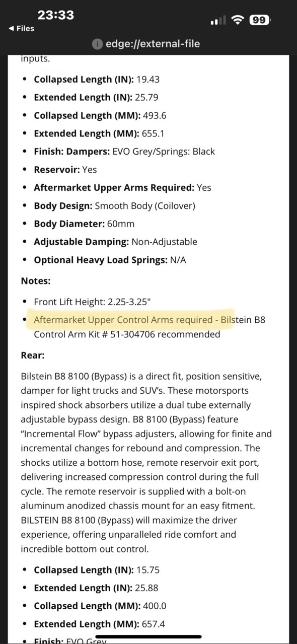

    I’d bet they’ll fit, but not so sure it’s the best plan. You’re looking at some pretty high end shocks here, so why leave the stock/weak/limiting UCAs? I get that the money adds up, but it would be a disservice.
    Several quality options out there for not a huge ticket price!

    Totally agree here. Bilstien and Built Right make UCAs that work great with this Shock. the original 8112 actually had a uca reqthat called out these two UCAs and a third I do not recall

    Any quality UCA for our trucks should be fine. Just because they're listing two specific models doesn't mean that several others aren't just as appropriate. Lots of good options...

    Screen Shot 2023-08-24 at 3.58.28 PM.png Thanks for the input. I appreciate the benefits of an aftermarket UCA but would prefer to use the stock one if possible. Is there a clearance issue with the stock UCA and the 8112 coil over assembly including the hose for the remote reservoir? It looks like the 2015 Tundra TRD Pro that was prepped for Baja has 3 inch diameter coils over 2.5 remote reservoir shocks with the stock UCA and LCA. They fabricated inner fenders with way more clearance and ran the hose for the remote reservoir. Also, the 'stock LCA' somehow has a triple bypass shock attached to it.
    In summary, I bet it would be tighter that a _____ if you were able to fit the coil over and hose in the stock UCA and it would likely rub.
