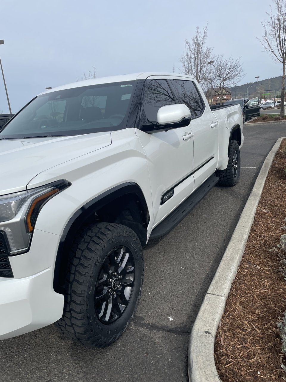

    huh?????
    pics above of 22 Plat are 34.1 Firestones with ZERO MODIFICATIONS, no pinning back of anything, no issue with full lock, no issues backing etc. NO issue when 900 lbs in bed, NO issue towing 7k up and down WV mountains..
    Above is not theory or conjecture .

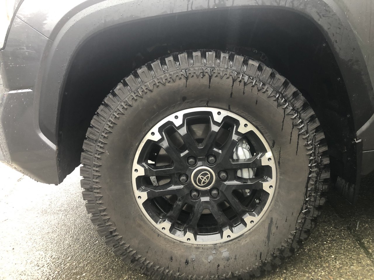

    Here you go sir…295/70/18 Atturo Trailblade XT on stockers, no lift and no mods whatsoever (even have my mud-flaps).
    This same Combo on Methods with a Bilstein 5112 on top setting (18x9 +25 offset ) rubbed like crazy on my 2015 …had to remove mudflaps and trim front fender and still got funny looks reversing on a hill at full lock cause it sounded like a cheese grater.
    On the 22 it’s a breeze no matter which way the suspension is loaded :thumbsup:

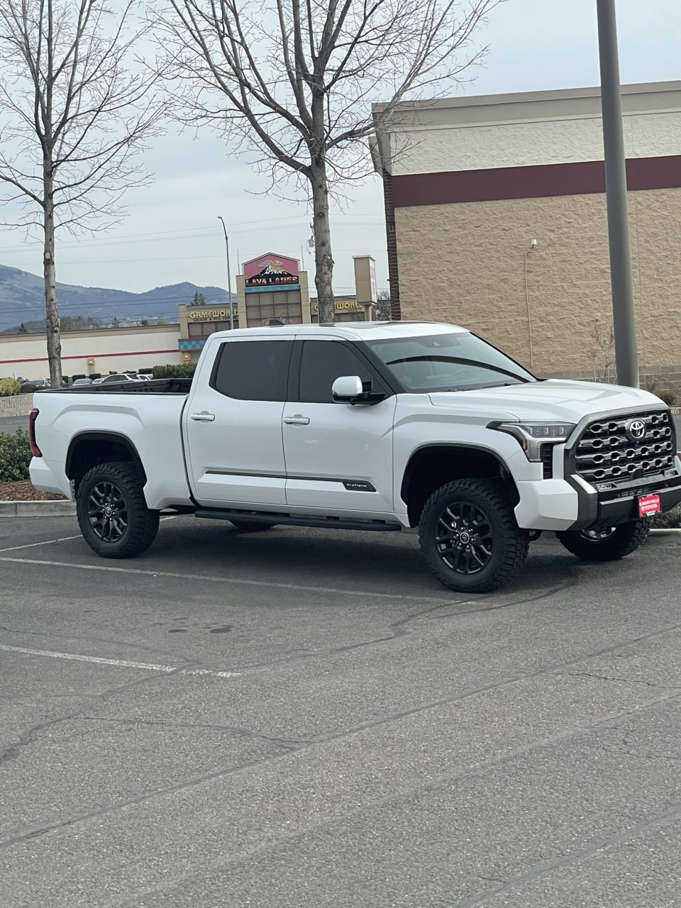

    Picked up a Rough Country 3.5” Lift, Mickey Thompson Baja Boss 295/60/20 today on Toyota Wheels. I’m happy with how it turned out. Not the best pictures…

    Looks nice.
    How do you like these tires, are they quiet?

    Tires are extremely quiet, it was a prerequisite, wanted something aggressive looking but also quiet. They are good, I have about 7 miles on them ha,ha. Plus they are made here in the States so that’s cool as well.
