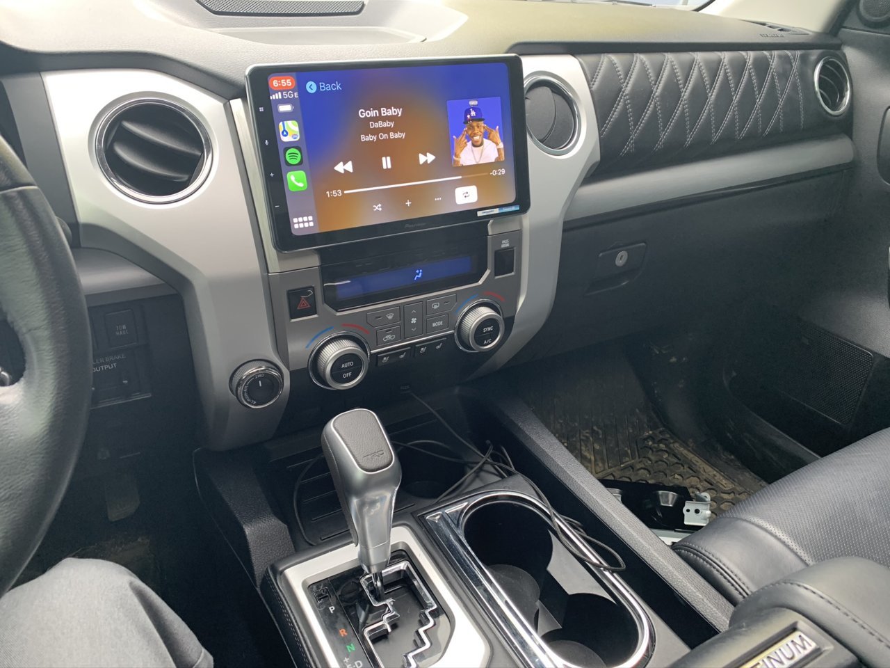

  25. Jan 18, 2022 at 1:36 PM
    #55
    PyroTitus
    PyroTitus New Member
    Jan 5, 2020
    #40797
    44
    Thomas
    2015 Orange Tundra TRD PRO
    Do you have a picture of it installed?

  27. Jan 20, 2022 at 7:14 PM
    #57
    Minarets
    Minarets New Member
    Dec 20, 2020
    #56440
    600
    Nashville
    2021 TRD PRO
    Love that look. How do you like it?
  28. Jan 20, 2022 at 7:56 PM
    #58
    akmerle
    akmerle New Member
    May 12, 2019
    #30440
    584
    Wasilla, AK
    2018 Tundra Platinum & 2024 GX550 OT
    I really like it, and while not cheap, it is WAY worth it over the stock laughable HU.
    Made my new speakers / amp / sub come ALIVE, Wireless CarPlay works great, and love how clean the look is without the volume knob (especially now with AJT full interior kit).
    dkrou and Minarets like this.
  29. Jan 20, 2022 at 8:26 PM
    #59
    mountainpete
    mountainpete Explore more
    Oct 24, 2018
    #20928
    2,612
    2018 Cement Crewmax TRD
    Function before sparkle.
    Do you take your truck off road? Any vibrations in the screen? I love the features but worry that a floating screen is going to rattle and blur on rough roads.
  30. Jan 20, 2022 at 9:19 PM
    #60
    akmerle
    akmerle New Member
    May 12, 2019
    #30440
    584
    Wasilla, AK
    A decent bit of trails / rough dirt roads, and a ton of choppy snow / hard pack / ice living here in Alaska.
    Also 32 speed bumps (8 each way, twice a day) taken at a minimum 30mph each day.
    Its perfectly solid.
