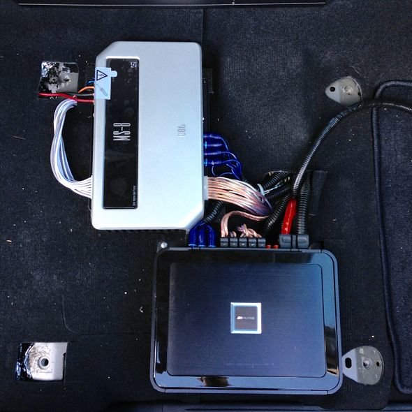

    I tried my best to get the stock Entune to work with an MS-8 and aftermarket amp in my 2014 DC.

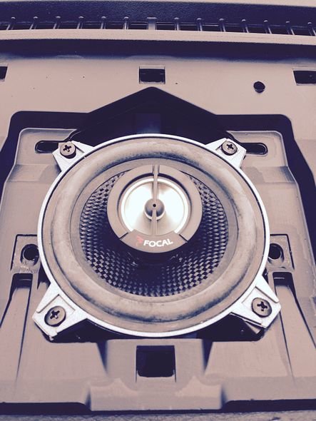

    Replaced the center dash with a 4" focal for a center channel..
    Never got a good calibration in 100 attempts over 3 months.
    I spent way too much time in all 4 seats with calibration headphones on only to get shit results.
    Sold the MS-8 on Ebay and bought an aftermarket HU.
    Ebay buyer said the MS-8 worked great in his vehicle (whatever that was)..

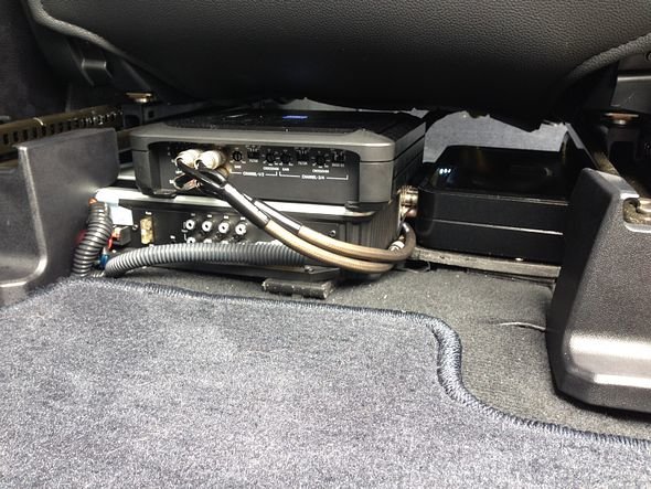

    I even added a second amp for the rear doors and bridged 2 channels for the center dash.
    F295A415-494C-4A0C-946B-B7A04839B780_zps_51f4b03142a4668128c7d59f749b682a714c3783.jpg
    B8793ACE-2625-487D-BA86-1DA679B1703E_zps_9f9d5e859f3dd80fa52dbd8f0a0aed320d01bcfc.jpg
    F0862256-FC0A-4CD5-9400-BC17747652A6_zps_217341378276658e5fdfda2bff97e4f4022654f3.jpg
    Aftermarket HU was the solution for me.
    5-channel Alpine PDX V9.
    Focal components in the front doors, Focal coaxials in the rear doors, JL Audio Stealthbox under the rear seat, and disconnected all 3 dash speakers.
    I certainly hope you have better luck than I did.

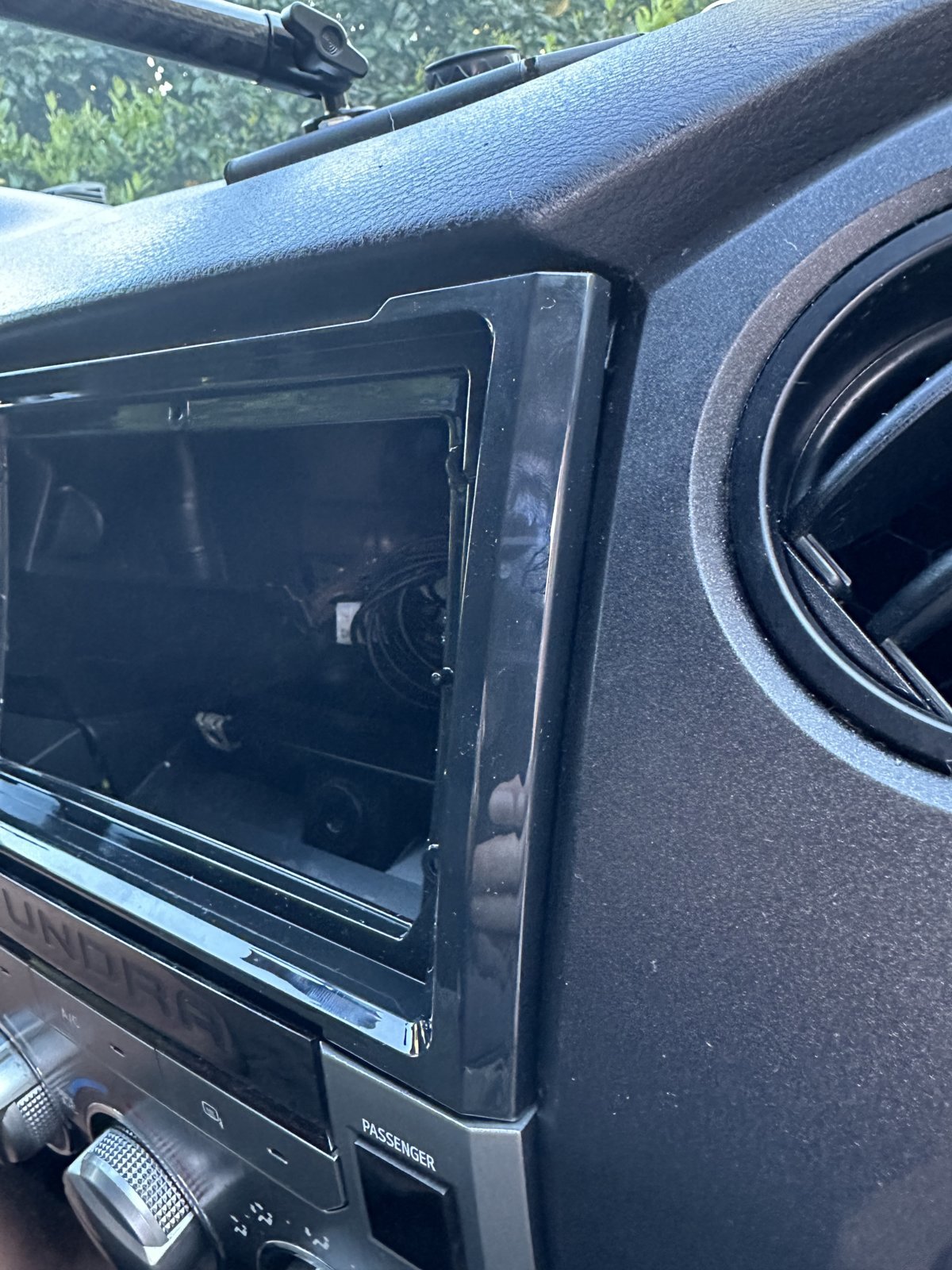

    Got my CC3. I am not seeing how the Dash trim piece is supposed to be secured. It certainly isn't snapping into anything that would hold it securely...
    Did you have any luck installing yours yet?

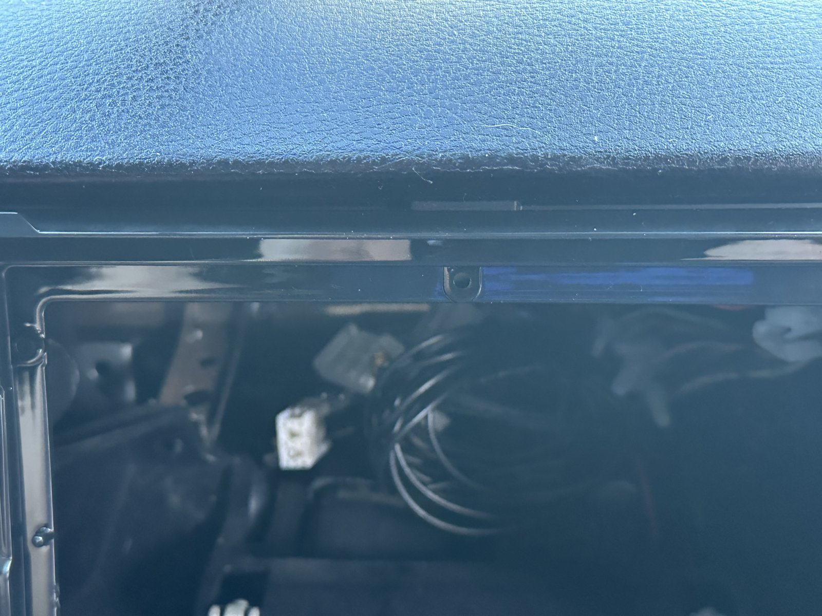

    38
    This little plastic piece seems to be blocking the trim piece from fully seating
