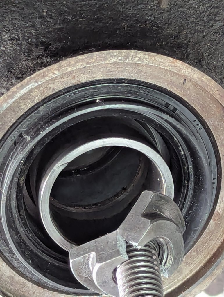

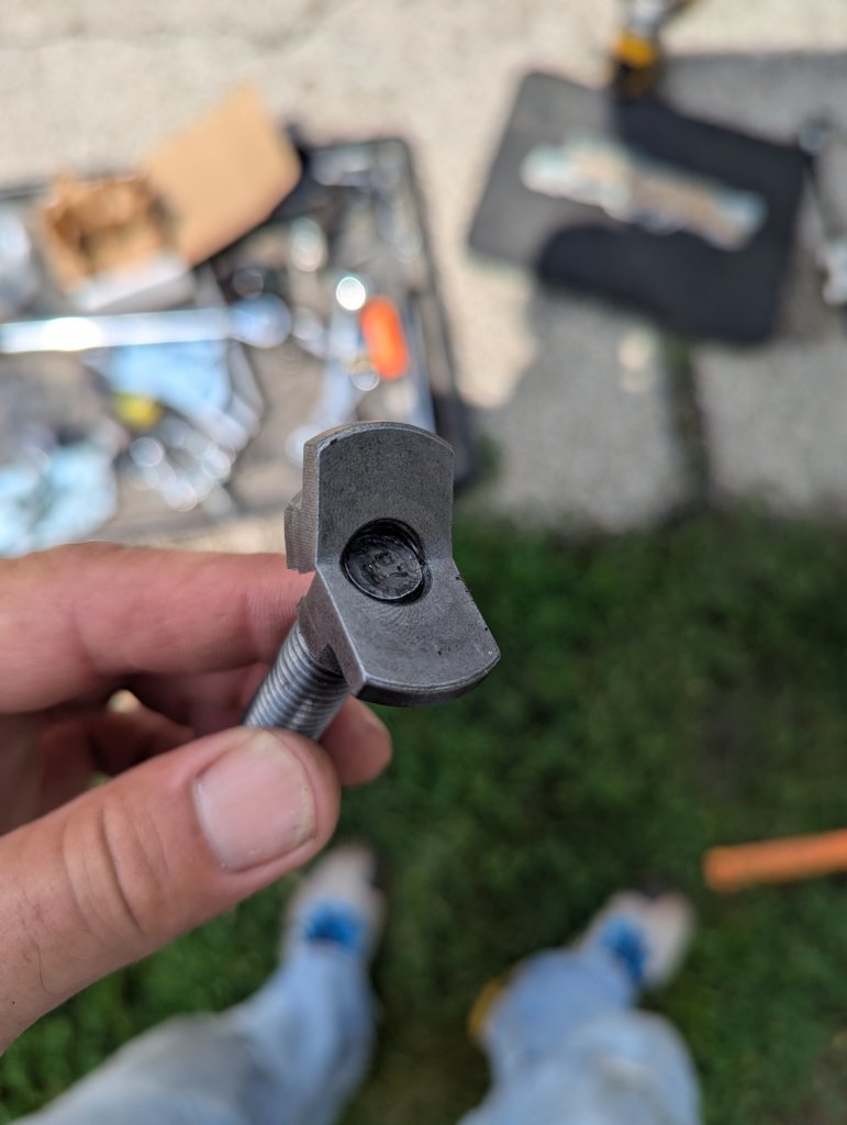

    I needed to get it back together so I just cleaned everything up and the scored up ECGS bushing is in there atm. Gonna order a new one and the tool. I didn't feel right hanging onto the loaner cuz I fucked up, possibly holding anyone up anyone that needed that so I wanted to get it back to ya.
    I didn't have the typical vibrations that people have when doing the ECGS bushing. I was just doing it because I had a CV boot go and was gonna be in there anyway.

    I should have kept the tool! FML.
    So close!
    Slide hammer?
    Edit: slide hammer got the last 1/4" of the first ECGS I installed and fucked up. The kit didn't come with an extra nut and I think the fact that I didn't have the needle nose pliers behind there may have part of the reason it broke. I got it done though and the 2nd bushing drove in nicely after being in the freezer for 2 weeks.
    I think they should make that piece i.broke from a stronger metal but oh well. Shouldn't have to do it ever a-fuckin-gain!

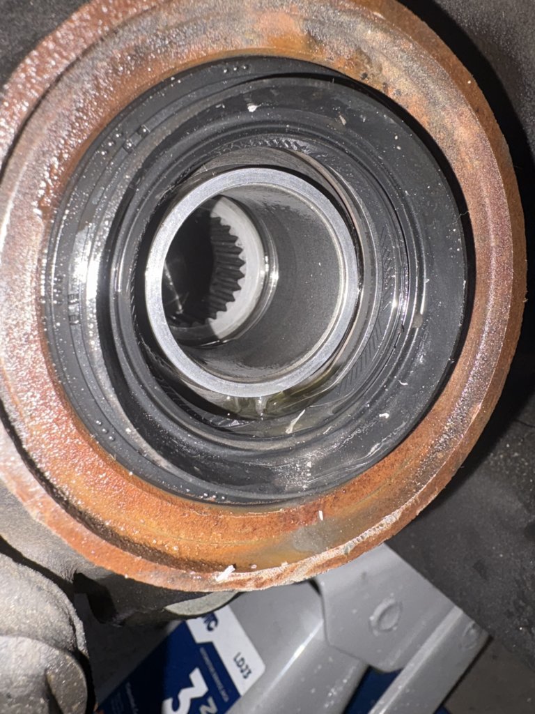

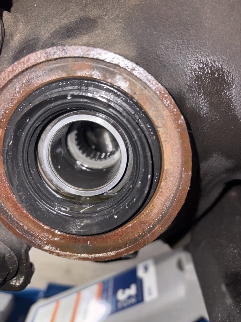

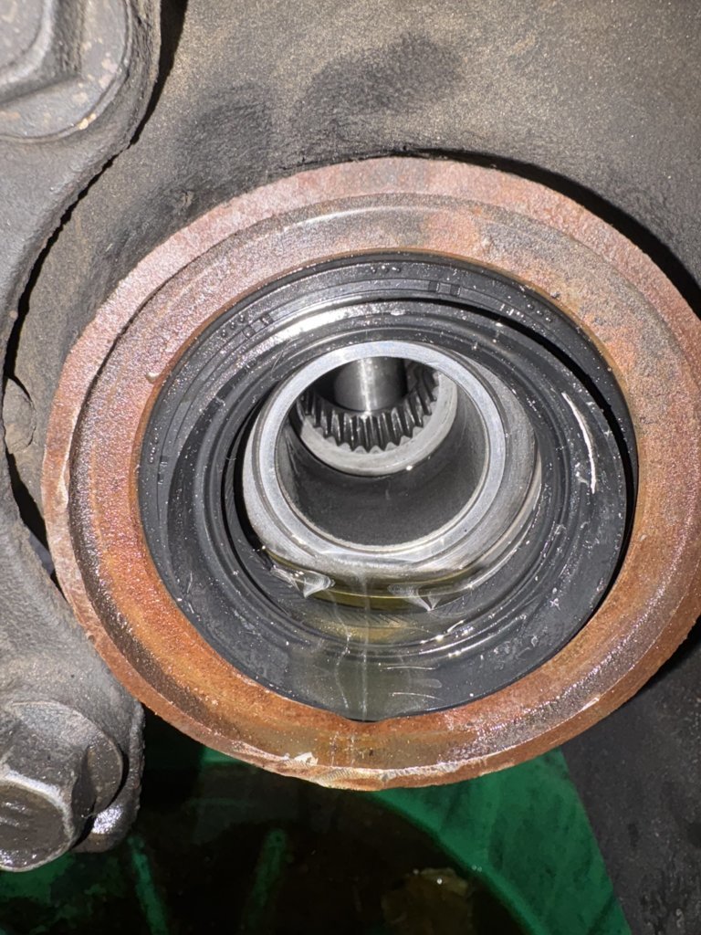

    This is where mine is now stuck at.
    There is a definite lip and not even close to to as flush as the rest of you.
    i have pounded on this thing like you wouldn't believe and it's refusing to budge. Any suggestions? I dont want to damage the diff. Possibly caused by difference in tolrances for the narrowed part of the inner race?
    @Hi06silver That 2nd one that drove in nicely, did it go in more flush or about the same as the 1st one?

    It went pretty close to flush. Grab a 90° pick and set it on the diff race lightly push towards diff. You should feel it raise up where the bushing will eventually stop. From your first picture I'd say you need to go in a little more. Don't want your CV popping out like mine did unless you wanna join the mangler club lol

    Maybe it's because I've swung a hammer so much in my lifetime, but it was a pretty distinct dead solid feel when she bottomed out and was home/all the way in.

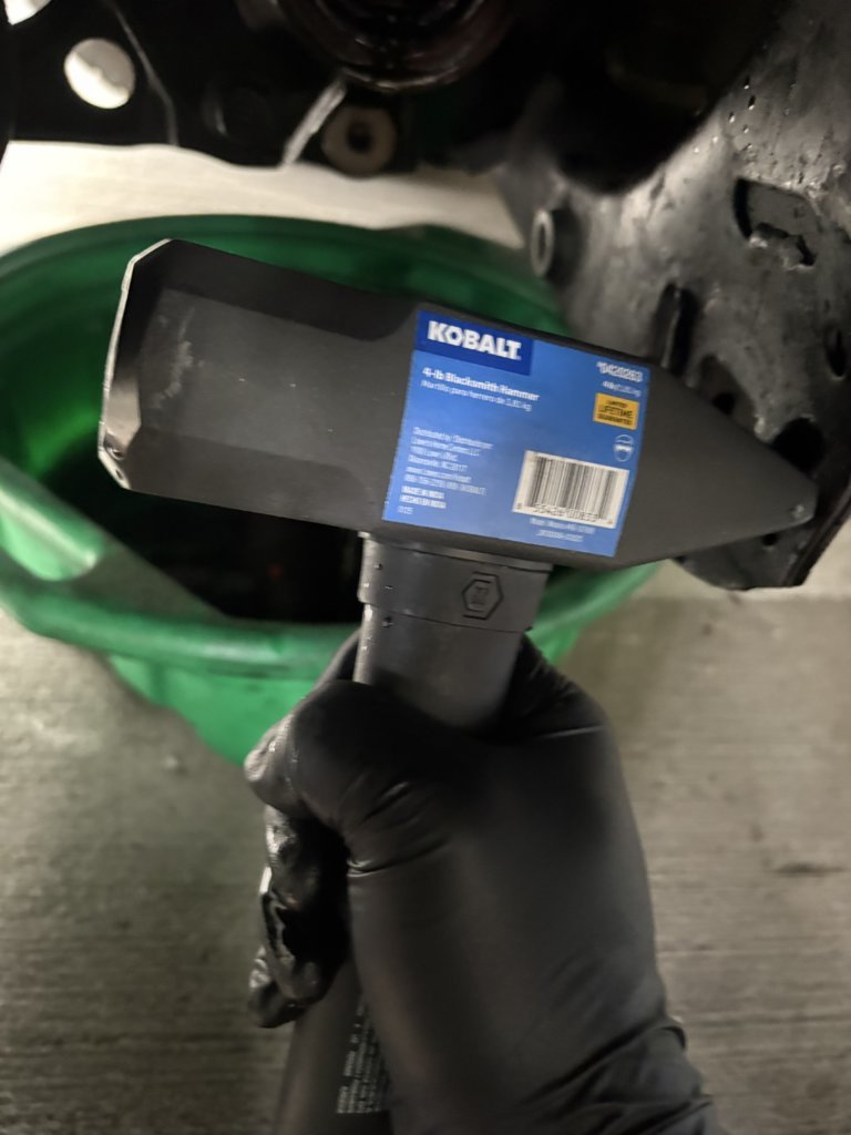

    Thanks guys. Needed a bigger hammer. Word of warning for anyone else looking to do this job, a 2lb deadblow with all your might isnt enough, you need a 4lb sledge. Also, this job is a royal PITA
    i did not notice any change in sound like the dull thud but im not as auditorily talented as most
