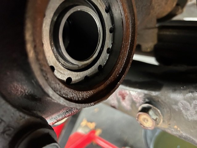

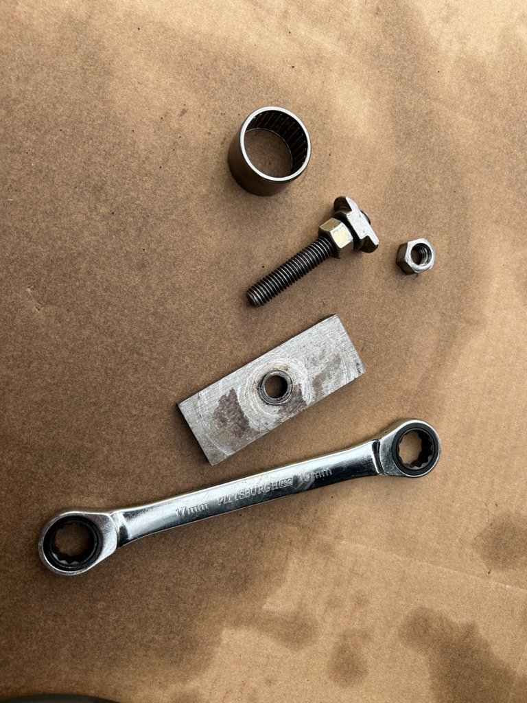

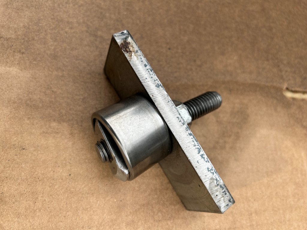

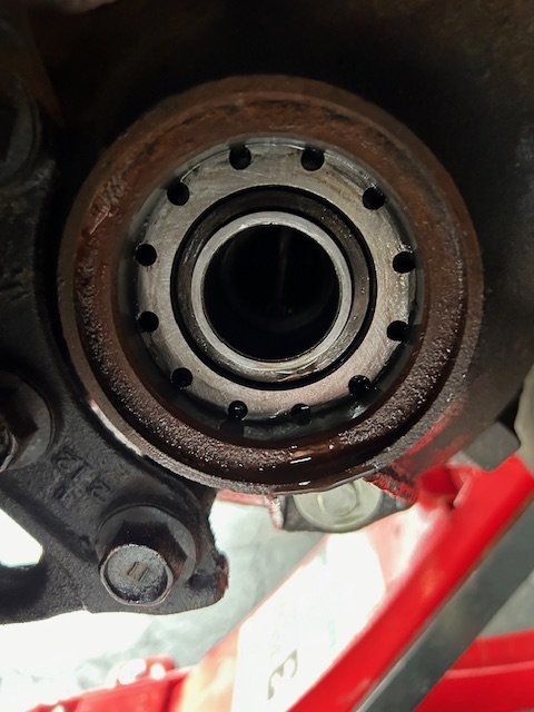

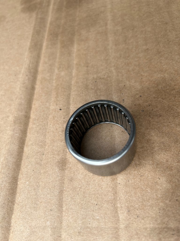

    Well, that didn't suck. I doesn't look like it went exactly according to plan, but the needle bearing is removed.
    Now, to get the new busing installed. That DOES suck...I'm taking a break while it cools off in the freezer :)

    Does your needle bearing seem to be noticeably bad? Mine was just fine when I pulled it.
    ToyotaDude and FrenchToasty[OP] like this.
  12. Nov 19, 2024 at 7:42 AM
    #312
    FirstGenVol
    Dec 13, 2018
    #22934
    14,278
    East TN
    2002 AC TRD 4x4 V8
    Mine appeared perfectly fine too, from what I remember.
    Hammering the new one in took a lot more force than I was expecting.

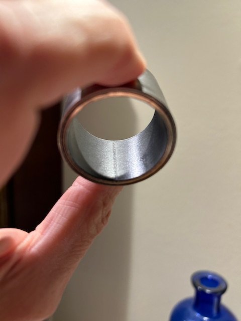

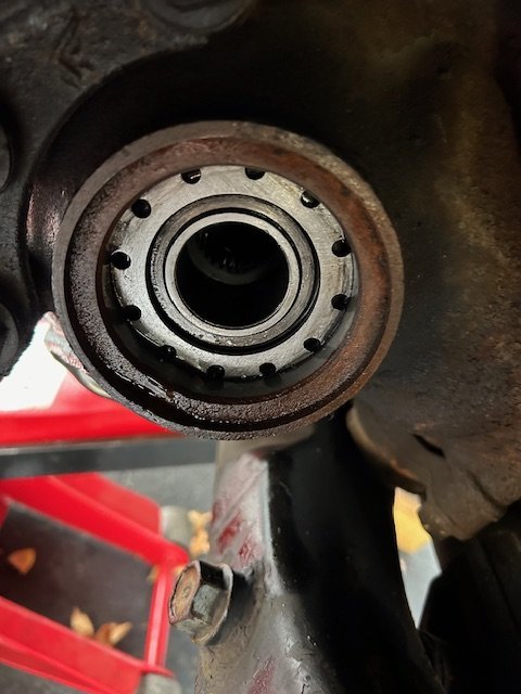

    My needle bearing does NOT seem noticeably bad, causing me to question why I'm doing this in the first place! (The answer is because I'm getting a new hub bearing and CV Axle, so while I'm in there...).
    Getting the new bushing in is a PITA! First I had trouble getting it started (the freezer did NOT help!). I notice that the needle bearing has a generous radius on both edges, so I took a fine file and some emery cloth to the inside edge, carefully creating a tiny radius. That did the trick. I got it started and driven almost all the way home, but I'm stuck here:
    I'm afraid to smack it harder (plus it's really difficult to hit it all), but it looks like it sticks out further that the .030 - .065 that ECGS specifies.
    "TECH NOTE: The T7.5 bushing is longer than the stock needle bearing. There is room for the bushing to
    install flush without hitting the spider gear, however some of the Toyota carriers are not bored straight
    through and there is a ridge on the inside. The ridge will stop the bushing from seating flush. Installed
    height is between .030-.065 off of the carrier bore as acceptable. The bushing can be driven past the
    ridge of you hit it hard enough but it will damage the bushing and cause the CV shaft not install
    properly. Drive bushing in to carrier with even firm blows once you feel it stop verify height is
    between .030 -.065".
    Q: Does our carrier have the aforementioned ridge ^
    Q: What result have you all had?
    Q: Do I need to get a bigger hammer?
    Q: Or it it good?
    Bonus Q: Is the carrier bore the surface with the holes in it?

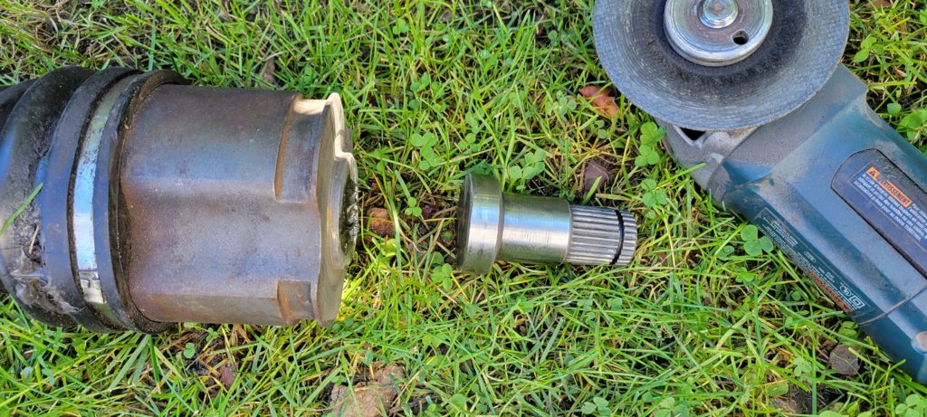

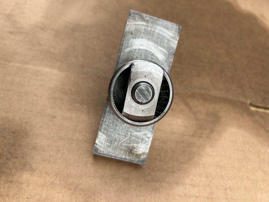

    Tell you what, cutting that tail end off my old CV axle and using it to install that bushing was the cats meow. Prrrrrfect alignment

    I feel like you should sent that to @FrenchToasty to expand on the toolkit, making that the official 'finisher' tool to get seating just right?

    I thought of that, but I want to reboot the old axles...

    Yeah I'm down with that.
    So when i chopped that old CV axle up It was before learning about the value/unobtainium OEM axles. Still.havent checked the remaining one. Not sure if it's a Toyota or not. Reason: If it's an aftermarket I'll chop it up and make another install/punch out if it. Besides the sticker, that will be gone, what other characteristics can I look for to identify oem?
    I can take a pic when I get back to the ranch too.

    I have one for the seal (2")...are you suggesting that a smaller one could be used to drive the bushing home?

    If it sits on the bushing itself it can be. I honestly don't remember that part when we did mine. 2.5 years and beer(then and now) have taken their toll.

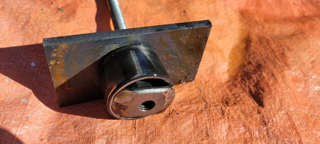

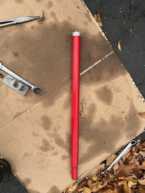

    Alrighty then! I took a break for lunch, recharged the brain, and watched some more Youtubes. I learned that I could use my jack handle to extend the tool, giving me ample room to swing the hammer. Et voila!
    I have two suggestions for those of you who may be foolish enough to try this mod:
    1. Use a lift so you have room swing a hammer
    2. Get a helper!

    My home made tool slipped in a bit like that too, and got the job done.
