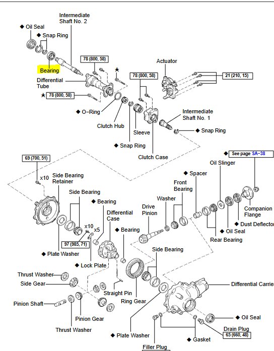

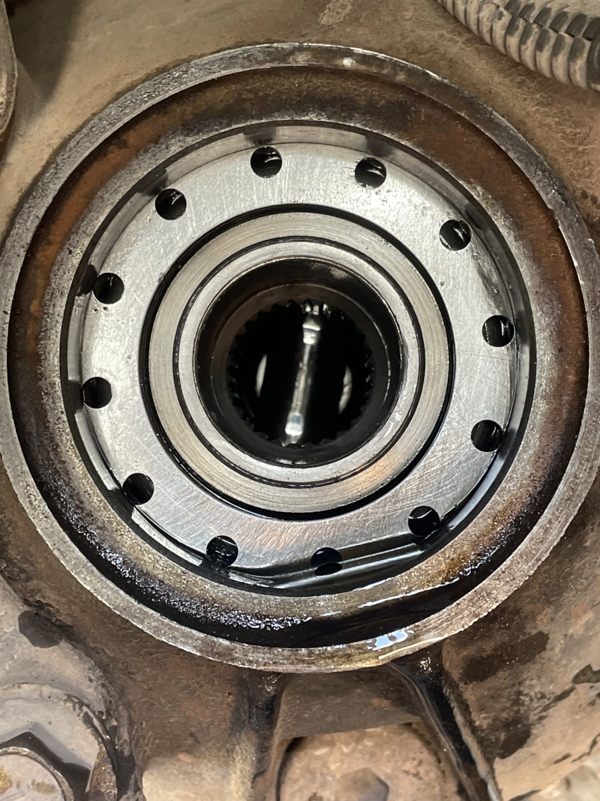

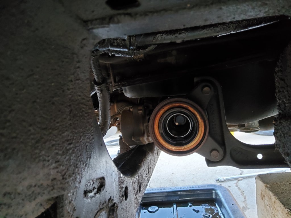

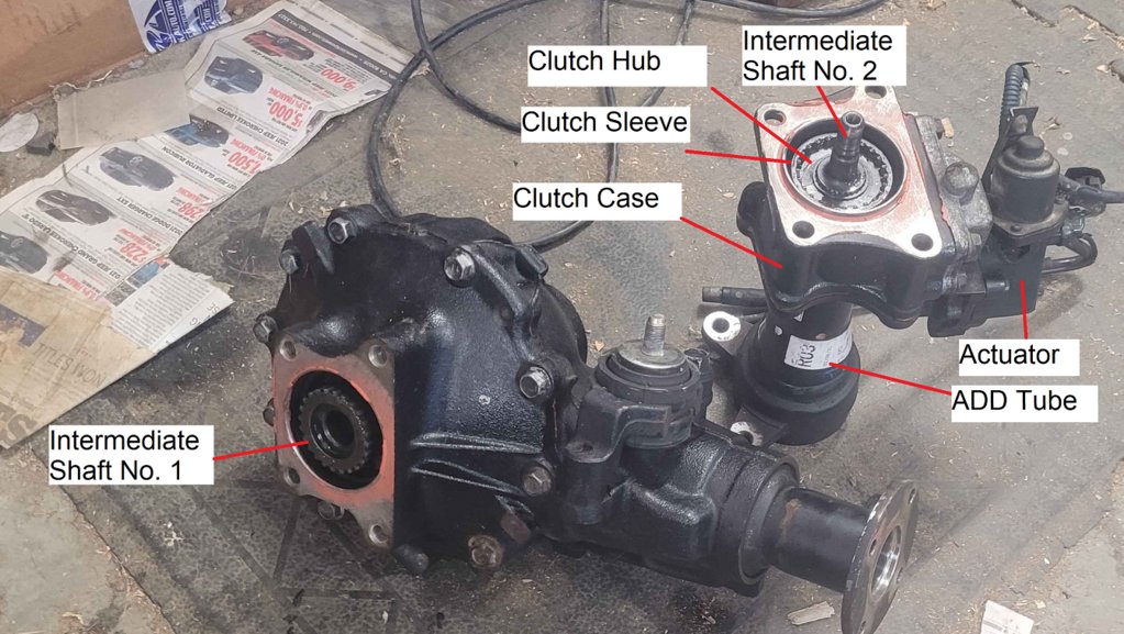

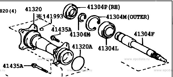

    I'm developing symptoms that cause me to consider replacing the needle bearing, however, when I crawled udter the truck to check it out I found waaaay more play on the passenger side. Apparently there's a ball bearing on that side. I need to dig deeper. It's probably a good time to drain/fill the front diff to see if there's any glitter.
    I don't recall ever seeing the passenger side bearing repair on this site. Has anybody done this?

    Not I, and my driver's side bearing wasn't bad when I changed it out for the bushing. Ended up being my wheel bearings.

    TX
    02 AC sr5 4wd v8
    I have. It's a pain due to that bearing needing to be driven in the EXACT amount. I don't remember exactly how much though. I know @MrDirtjumper has done it too, so he may have it on his build page.

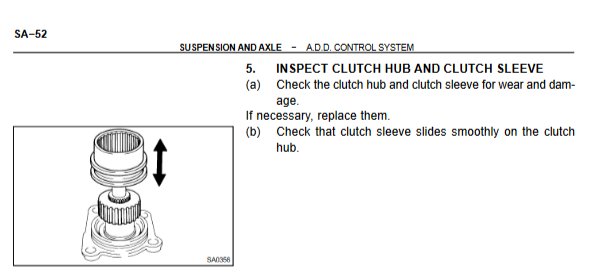

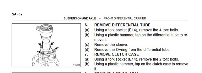

    Tonto cover
    Play on the passenger side while in 2WD? It looks like to get to the passenger bearing inside the ADD tube, you have to take off the whole ADD tube and remove the ADD shaft (Intermediate Shaft No. 2) to press it on and off.
    I haven't taken the shaft out, but I've taken the tube off. The ADD tube isn't too bad to separate, in 2WD, the Clutch Sleeve will be disengaged from Intermediate Shaft No.1 inside the differential. The tube requires E14 sockets and it'll require some tappy tappys to break the FIPG.
    Depending on how willing you are to dig into the tube for the bearing, it might be worth it to just get a used ADD tube and risk that bearing and re-use your actuator.
    Part number for mine comes up as 90903-63008

    Again, I haven't done every step of this job, but if you remove the tube, it should be easier to see where exactly the bearing needs to be pressed to.

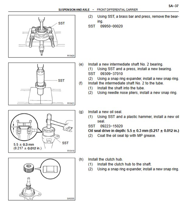

    Now that I think about it, I was mistaken. We did the seal, not the bearing. The seal has to be pressed to a certain depth, that 5.5mm in the service manual. But, I've never seen anyone do the bearings like Des showed.

    Yeah, I don't see how the bearing can be removed without taking the ADD shaft out. Getting the shaft out of the tube looks like it can be done with a small amount of force, but bearing removal/reinstallation from the shaft will require a press. The shaft should have a lip where the bearing will bottom out, plus grooves for the snap rings. This video seems to do a good job going over it:
    https://www.youtube.com/watch?v=Yk-0BulWeHA

    Well, I hope that's not what needs to be done, it looks like a colossal PITA! I just drained/filled the front diff (I wanted to install my new Lexus plugs anyway), and there was no glitter or other signs of failure. I'm trying to isolate a high speed "womp womp womp" and tiny vibration. I'll investigate more about how to diagnose any problems/noise resulting from the side to side play I see on the passenger side. I have one wheel bearing left to replace (front driver side), and although it doesn't appear to be time yet, I've ordered the parts so I'll be ready. When my right front wheel bearing went out it was a low speed "womp womp womp" and a significant vibration.
