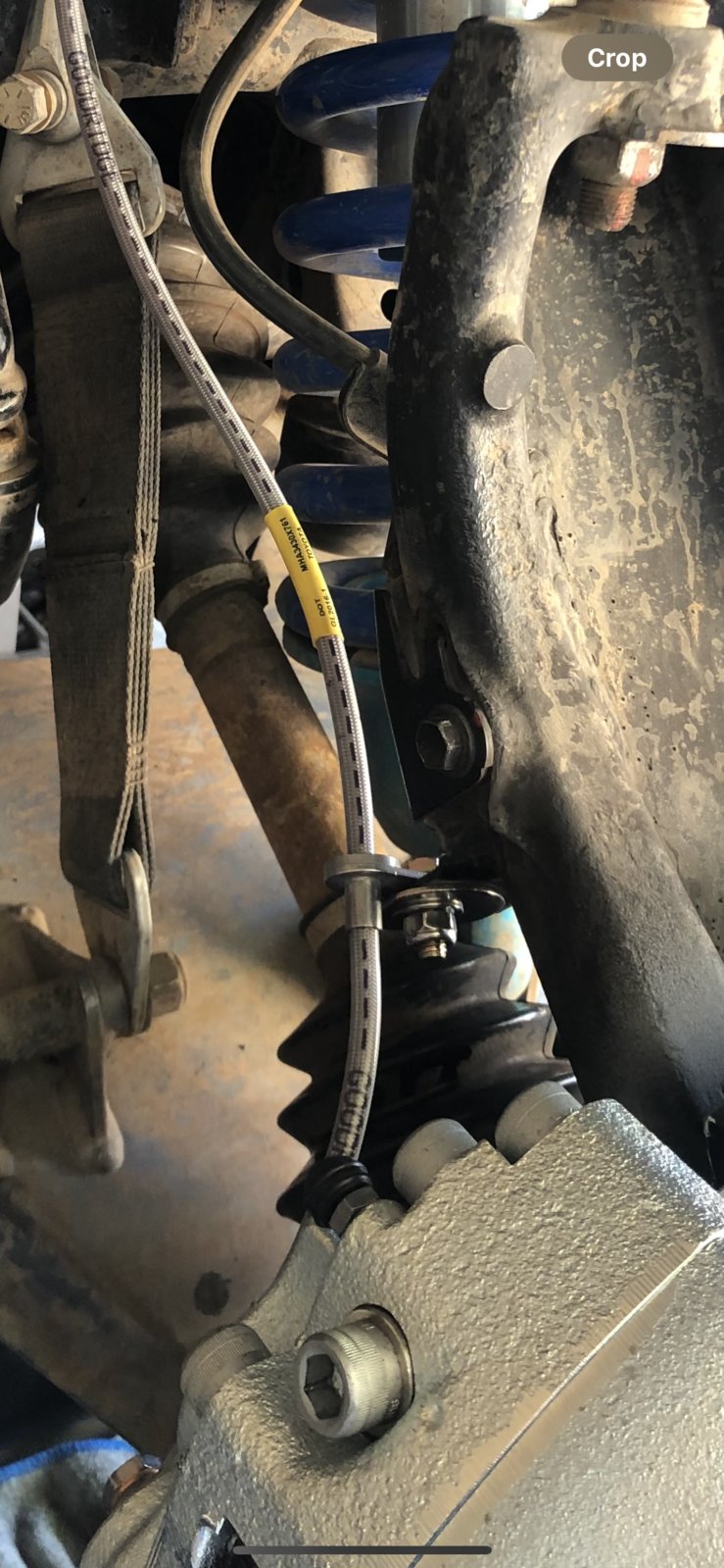

    Tundra Crew.....I ordered the Alcon Kit for my 2018 Crewmax. I am having a problem with the front braided brake lines sent to me. They list as being fit for a Land Cruiser and there is not perceivable way to install them into the stock clip on the spindle. Can someone out there guide me on how this braided line is to be installed? or if there is another option to run the braided line and abandon the hard line.

    Might reach out to Chris at Alcon for help. Mine have been on my ‘18 CM for the better part of a year and weren’t troublesome.
    Be ready…. They’re pretty impressive. Bed them in correctly and then beat the shit out of them. Good luck getting them to fade…

    PM sent. Pic added also for reference. You’ll also need to modify the dust shield or remove it to fit the caliper.
