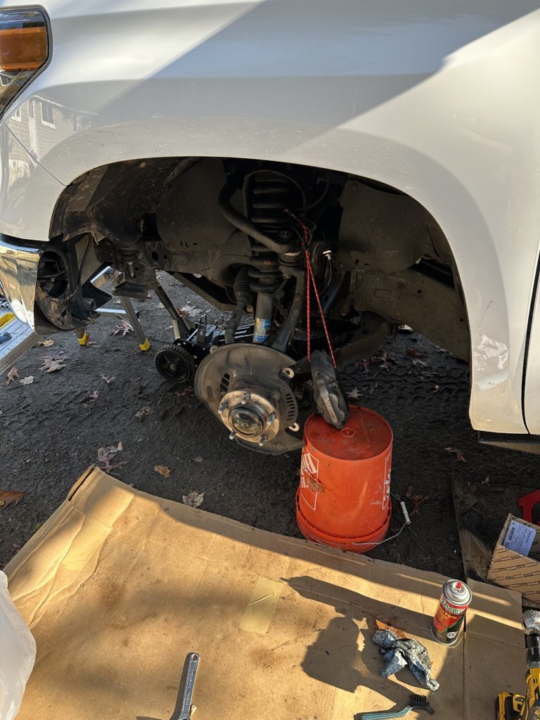

    About to do the front rotors and pads tomorrow. Any advice on jack points/torque specs or other useful info from those who have completed this?

    Just jack up the truck at the front crossmember and then jack stands on both sides of the frame.
    There should be a thread somewhere on torque specs for caliper bolts…

    37
    Did the front rotors and pads yesterday, bedded them in but I'm getting a chirping/clicking noise at 30+ mph on the right side. See video below. I'm going to take everything apart tonight to see if anything was loose etc. Any idea what this could be?
