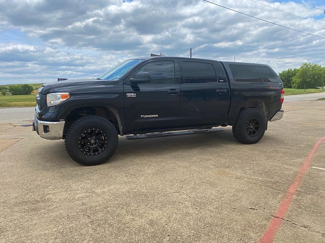

    Finally got installed, again a huge thank you to @Toytec Lifts and @StrmTroop29 for all the help, the truck turned out great!
    BEFORE:
    AFTER:
