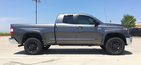

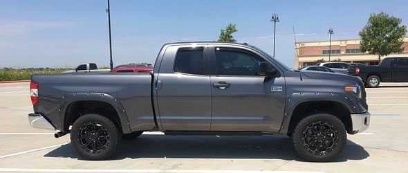

    My 6112s are stiff as fu*k and that is after 60K miles.
    Toyec shackles in the rear..
    2.5" lift in front, 1" in the rear
